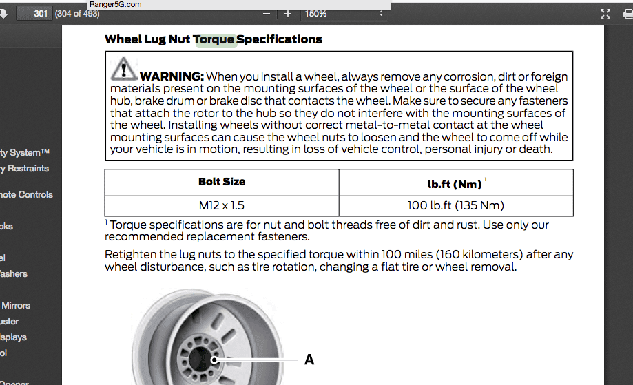

If you're going to hand torque, I recommend re-torquing as stated in the manual. You do loose a little clamping force as the wheel ultimately centers onto the lug nut seats and hub, after a service. Also, a must for any dually.

After reading this post I ran out and bought a torque wrench. I set it @100 lbs. less than 1/8 of a turn and it clicked in. I have 3944 miles on the Ranger and it looks like they were tightened properly.
