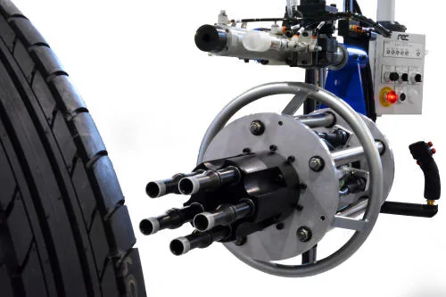

Hi Folks,
The plant used a very sophisticated multispindle nutrunner to tighten the wheels. It is about the size of a 30 gallon garbage can and hangs on a Zimmerman Balance winch. It measures all wheel lugnuts for dynamic torque, not static torque...too complex to describe here so google dynamic torque if you wish to delve further into this. If the nut runner fails to torque all the lugnuts correctly, it shuts down the assembly line immediately. I am certain Gregg's Ranger left the plant with wheels properly torqued. Something has happened after the vehicle left the plant or there is a serious defect that will be bubbling up post haste.
best,
Phil Schlke
Ranger Vehicle Engineering
Ford Motor Co. Retired

Hi Chance,
Certainly a plausible scenario!
best.
Phil Schilke

News to me it is still on the PDI....we facilitated the Ranger Plants to preclude the the need for the dealer to check the torque as there is little likelyhood of them doing it. I am sure the system is not 100% perfect as I do recall one instance at Edison where they right side nut runner failed, the line when down while the repairman get the thing back up and running. They sent a couple workers with torque wrenches down the line to check wheel torque. Not sure how far down the line they went and with the speed they worked, it is quite possible the worker missed a lugnut. First thing I did when I got my new Ranger home was check lugnut torque...they were all above 100 Ft lb, but I broke each one loose and retorqued as I had no idea if there was an unregulated air impact wrench used on them....although none of the lug nuts showed signs of that happening... Second thing was tire pressure, a topic of which has been discussed in this forum.
The takeaway is that there is a need for Dealer PDI but some things are better controlled at the plant if possible. If only we could get a handle on tire pressures...
So I stand corrected on it is still on the PDI form...
best,
Phil Schilke

Also, Torque with a torque wrench and a dynamic torque that you can get from a proper powered tool are going to vary significantly. Static friction is always higher than dynamic friction so once you get a threaded fastener moving, it takes less torque to rotate it than it did to get it moving. If the fastener rotates all the way from the initial tightening to when it is properly torqued, you can get very consistent torque values. If you use a hand torque-wrench, you're often going to end up torquing to a mix of values.

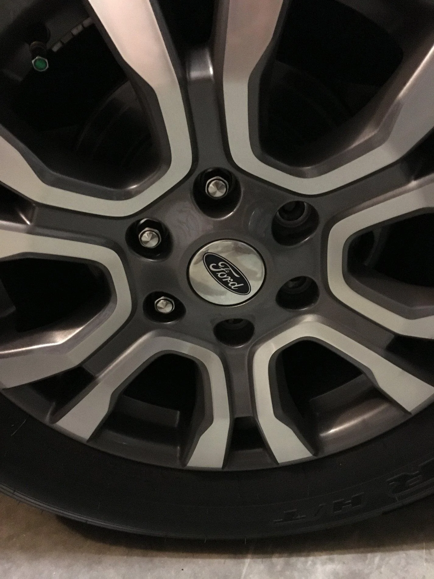

GMatt
Gregg
Jul 3, 2019
McKinney, TX
2019 Ford Ranger Lariat
Update, checked the lug nuts on the wheel while waiting for the tow truck and discovered they ALL were loose. So I tightened them up before he took it away. Arrived at the dealership and they are puzzled as we also discovered that the center stud is totally missing from the truck while the outer two were just sheared off under the lug nut. Just waiting for my loaner car and will update again once the service department eyeballs it
