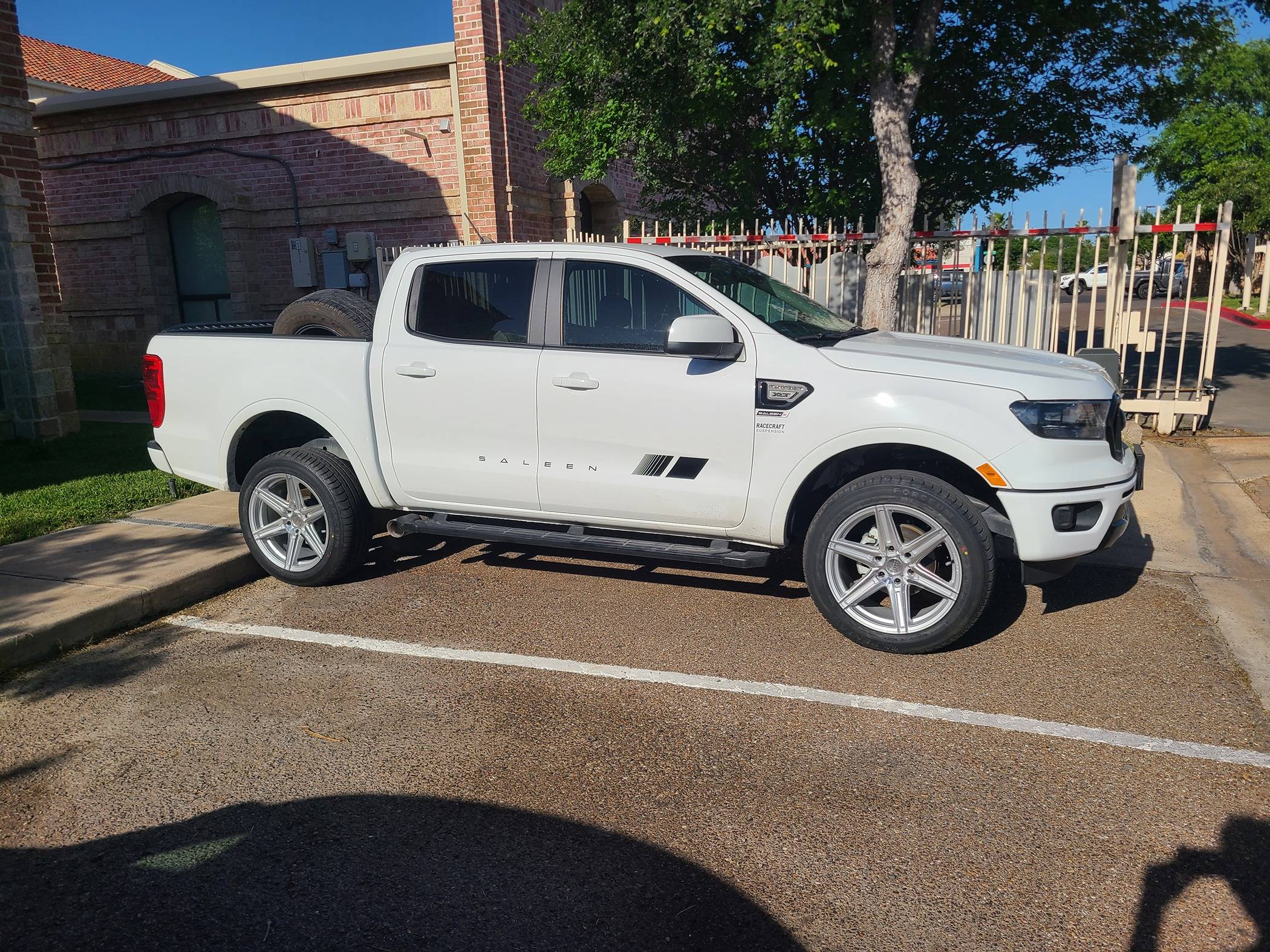

The time has come.
I finally installed the Saleen graphics, though I need to buy another set and redo them. Note to self. Do NOT install them while having a beer. Or three. It just doesn't help.
My wife actually lent a hand and fixed them as best as she could. Had a lot of bubbles.
Aligning it wasn't an issue. I just used the body lines as reference.
Also put on the wheels, to tie up the look.
Here it is !!

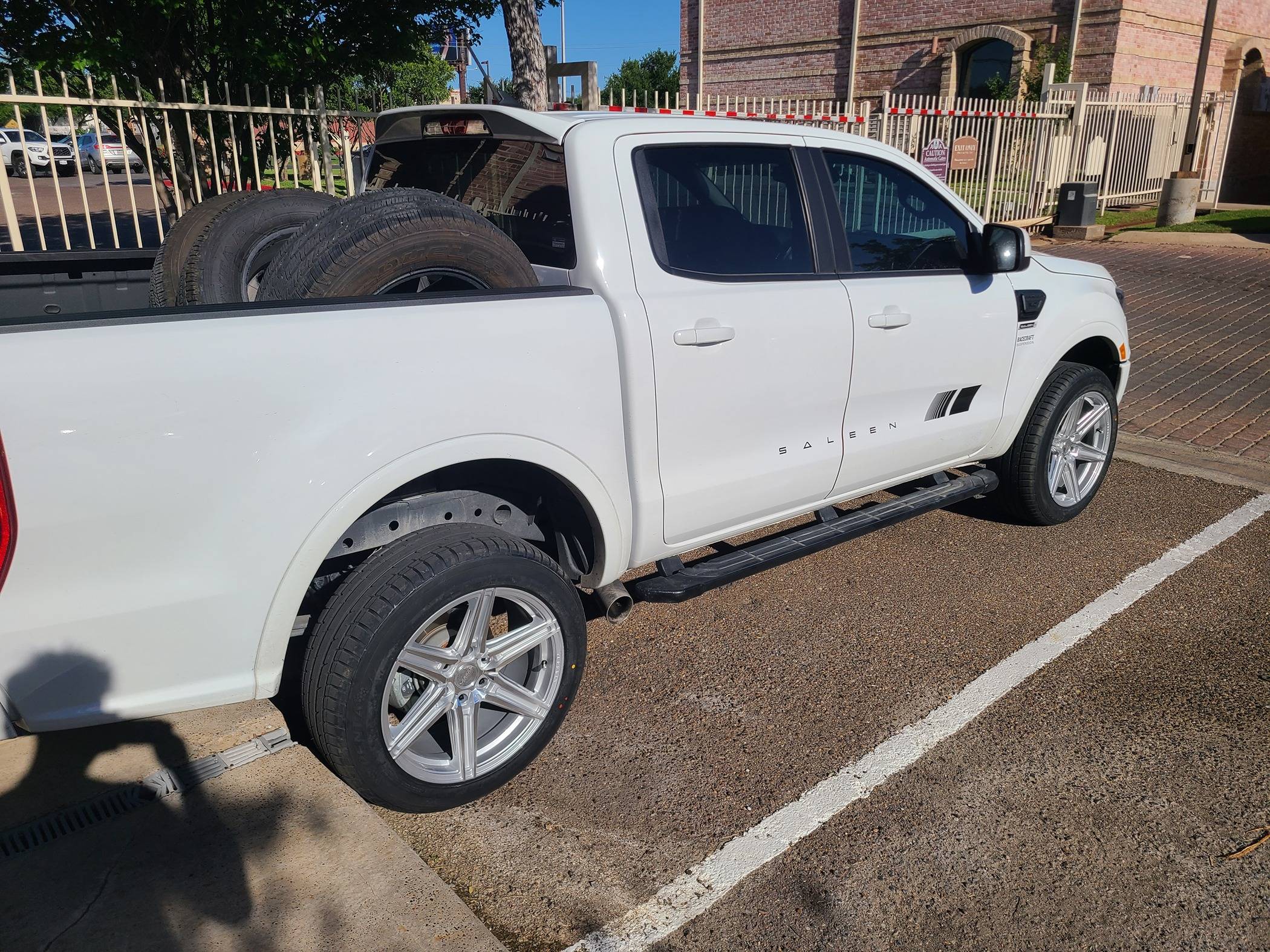

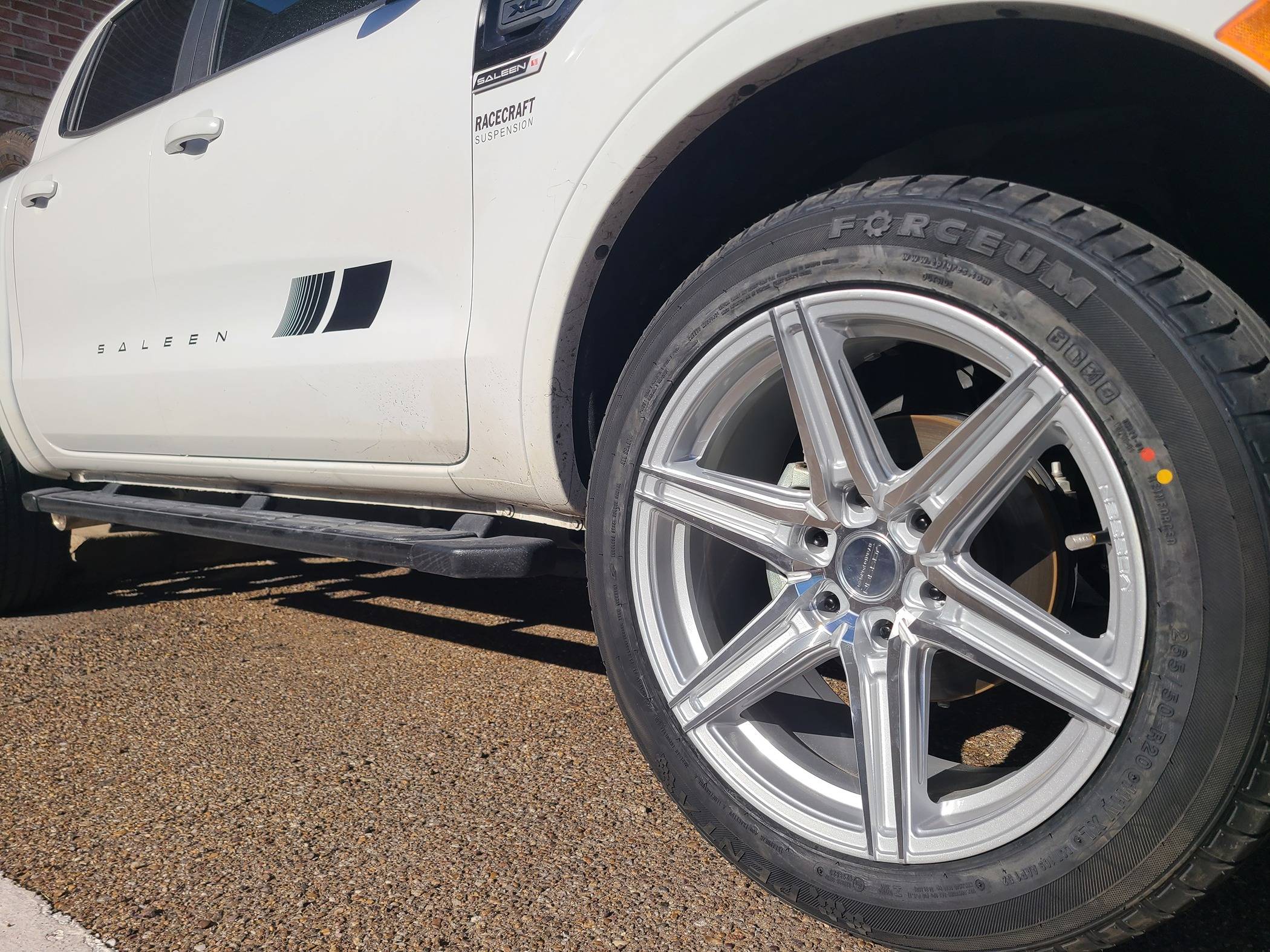

I must admit, I'm not too happy with the wheels..
I really wanted a set of KMC prism, but they're discontinued..
These are Vossens HF6-2.
20x9.5 with a +18mm offset, and a bore of 106.1.
I think it ties up the look well. Got lots of compliments at work.and the shop I went to.
Kinda looks like the old school Iroc wheels.
BUT
They poke out of the body just a hair..
I don't like that..
I wanted a flush stance, with maybe a hair just tucked under the fenders.
I ended up getting Aluminum Hubcentric rings to eliminate the gap. Ride feels harsher, and I sense a bit of vibration at 70+ mph.
Maybe that's from running a low profile tire??
No, I don't race, but I do reach higher highway speeds to get to/from work.
As it turns out Vossen makes custom Offsets.
Too bad my vendor never specified that. Now I own a set I don't really like.. due to the poke/stance.
Perhaps in +25, or even +30mm would cure my woes. But that's another set I gotta buy??
Oof.
If anybody has a set of KMC prism wheels they'd like to get rid of or trade, let me know.
I wanted the 20x9 with 30mm offset.
It's their smallest of the prism design.
To be honest, I might go back to the gloss black 18s I had until I can find a set I like with the correct offset and such.

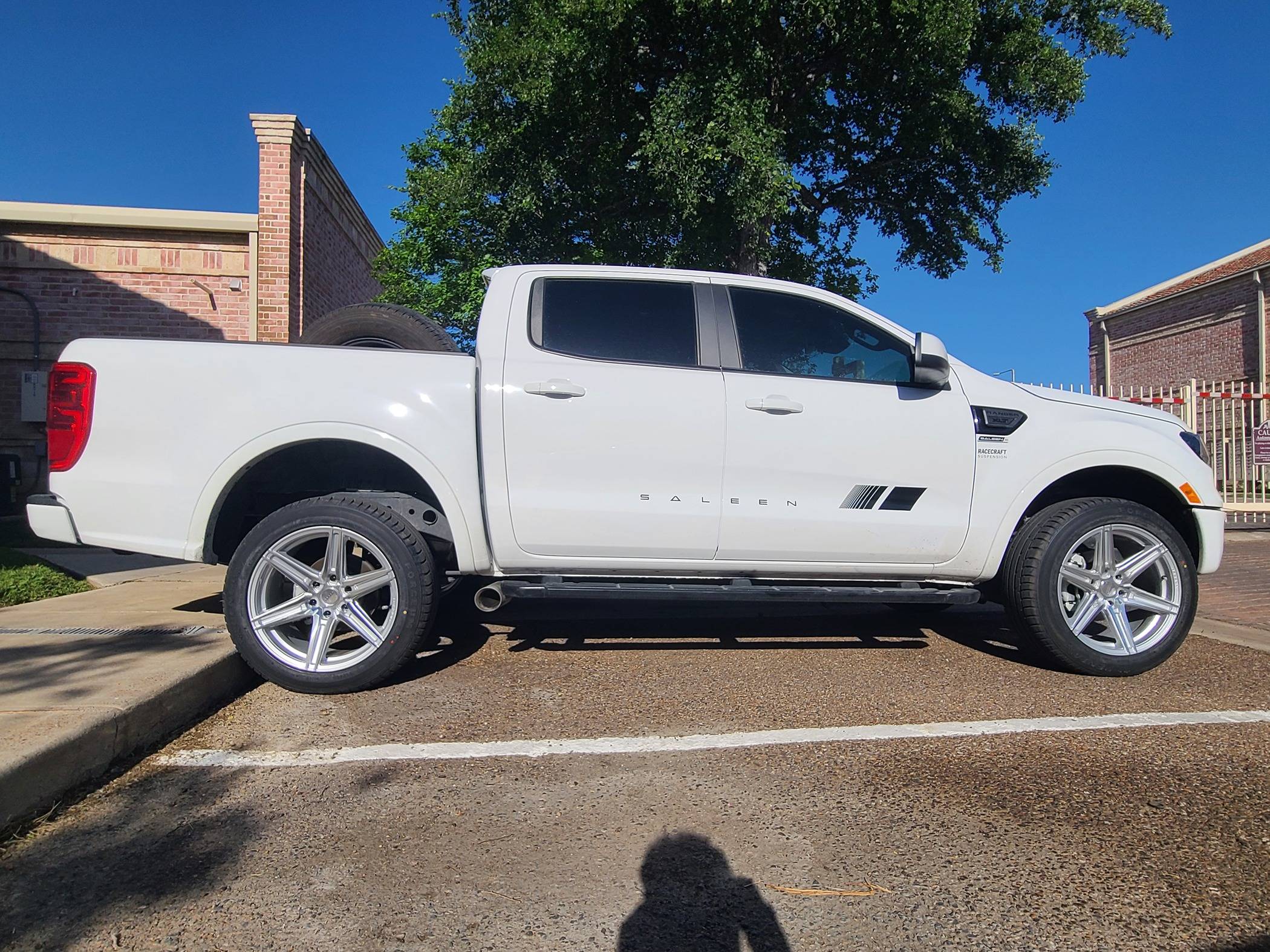

The KMC rims were a fiasco. Gave up on that idea, and went crazy. Got a new set of wheels for the Ranger in 22 inch. I thought they'd be a tad big, but between wheel and tire combo, it fits and fills in perfectly. If I lower it 2/4 that'll be the last touch it needs to get that sporty factory look.
Had to open up the bore a bit. Took them to a machine shop, and now it fits perfect.
Perfect width, diameter and offset.
Looks killer. Got a lot of looks and a lot of compliments.
Best of all, no rubbing, and still soaks up bumps relatively well.
