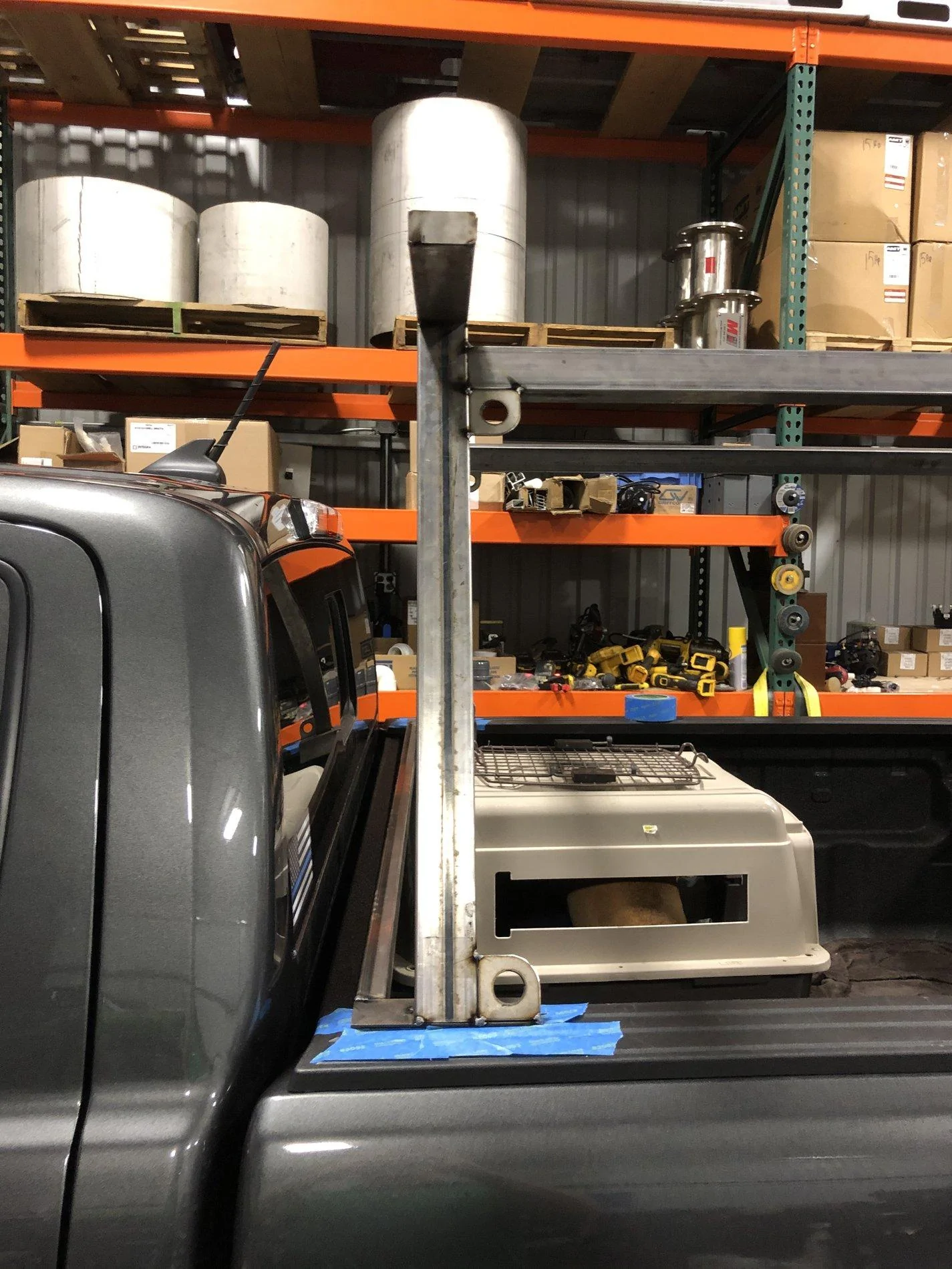

Carrying 10’ long boards in a 5’ bed is a fun one, didn’t want to go the dakine tailgate pad route so I welded up a crossbar that straps in on the bed rails. Works pretty good, allows easy access to the bed with the boards in which is nice. I’m planning on making a roof rack that will strap in too. Don’t want to drill holes or have anything permanent.

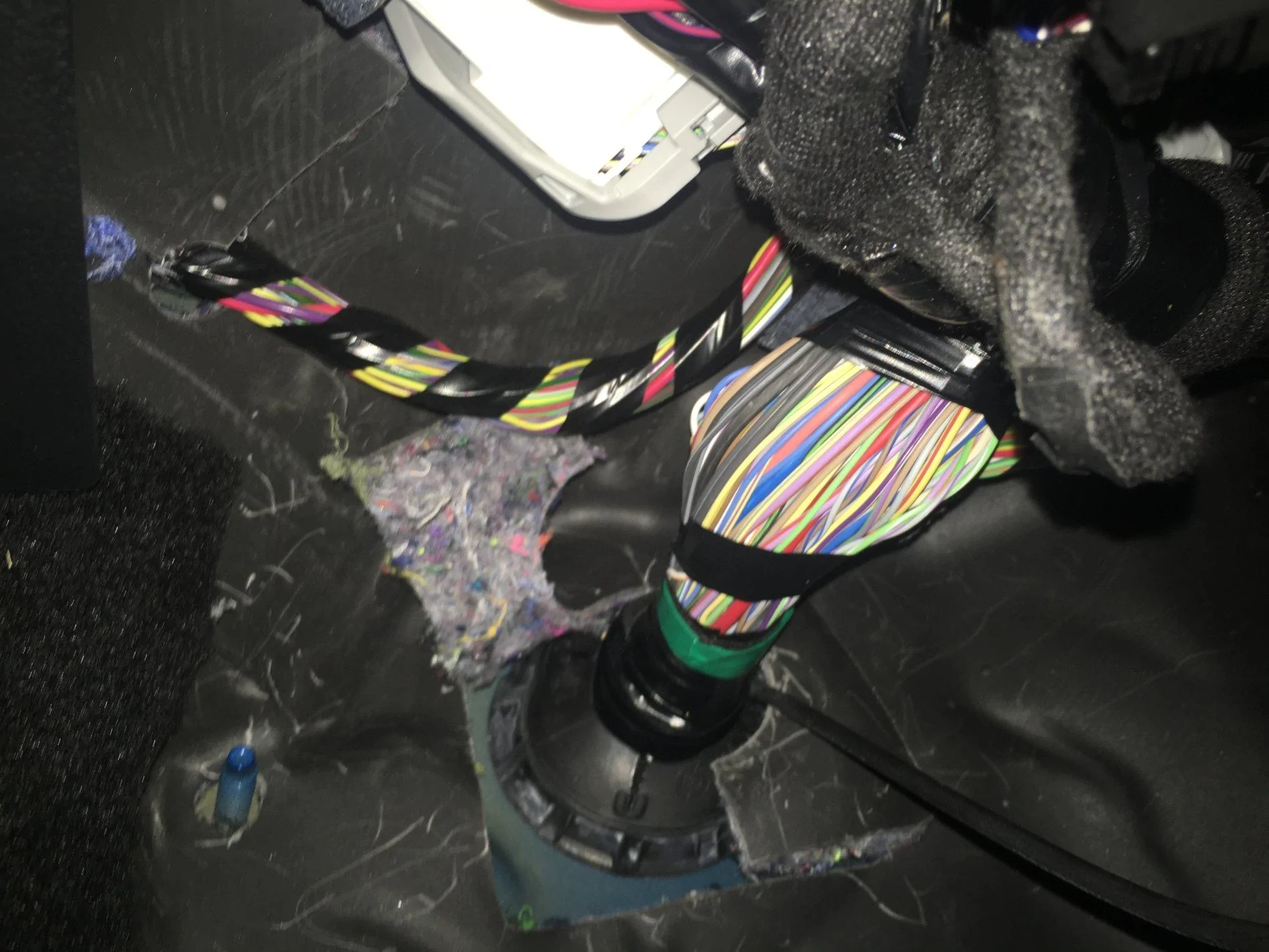

Get a metal coat hanger, straighten it out, bend a small tear drop shape loop on one end, from inside of the truck under the dash, poke the other end of the coat hanger through the main wiring harness rubber grommet and then at an upward angle out into the engine bay. I try to stay near the edge of the grommet so you don’t knick a wire. Thread your wires through the loop on the end of the coat hanger and pull it all through the firewall. The grommet will seal up pretty good around your wires.
Is this the wiring harness everyone is talking about to route wires/coax thru the firewall? Can you point out where you should go thru go thru the rubber grommet? Many thanks!..............Roger
Yes, I went through the left side of that mid way between the wires and the edge of the grommet.
