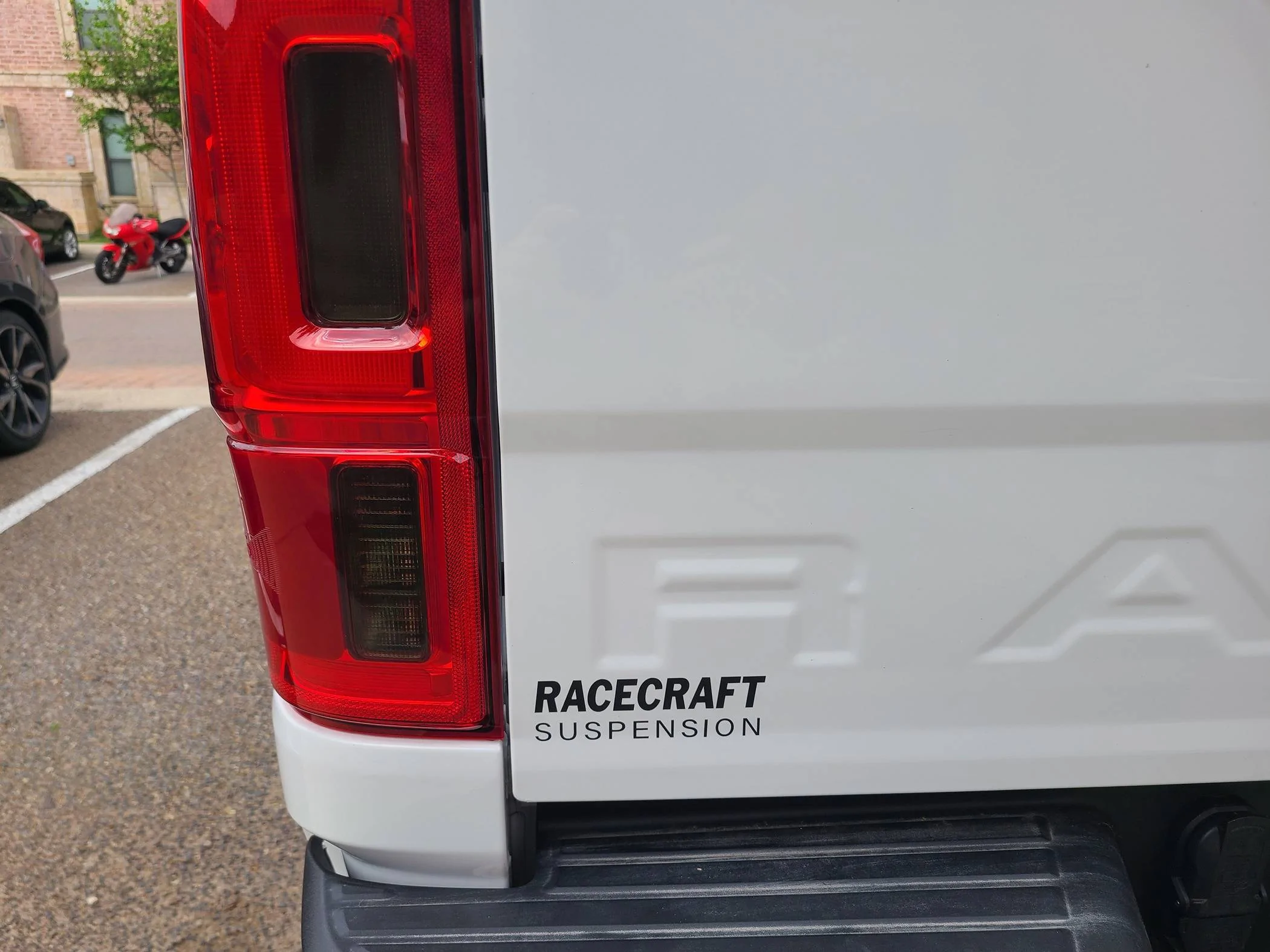

Got a few decals that had come in the mail, as well as some badges I was still pending. Spent the whole day working on the truck adding on a few pieces. Made quite a bit of progress. Here's the end results so far.
Need to redo the Racecraft on the passenger side, as I applied it a bit crooked.
Also need to remove and reinstall the Tailgate spoiler as that is also fugged. That's for another day..

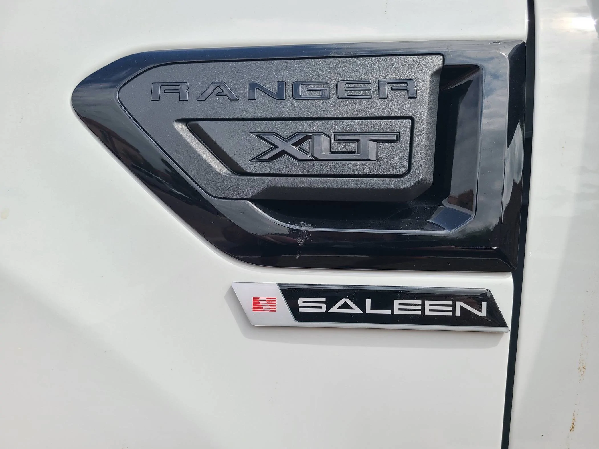

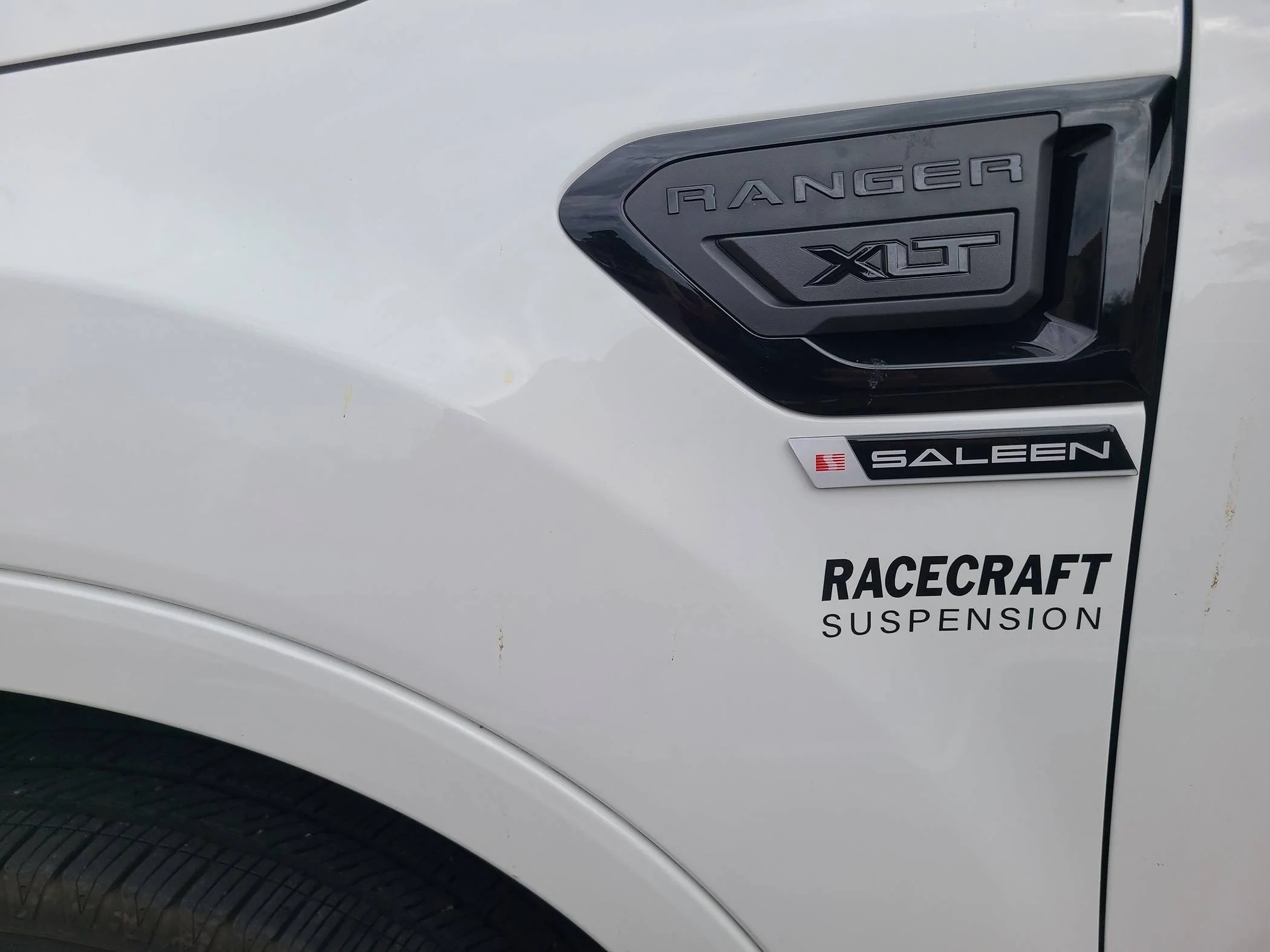

That RaceCraft one is incredibly crisp. The Saleen badge looks perfect there too. =)
Do you use any special technique to get them on there so nicely?
I've done vinyl with water with a drop of baby shampoo, but don't know anything about placing badges like your Saleens.
If you have any pointers, I'd love your advice.
I have 2 "Longhorn Edition" badges I'd like to place under my XL fender vents like you did but I am certain I'll get them crooked.
held up with folded over tape

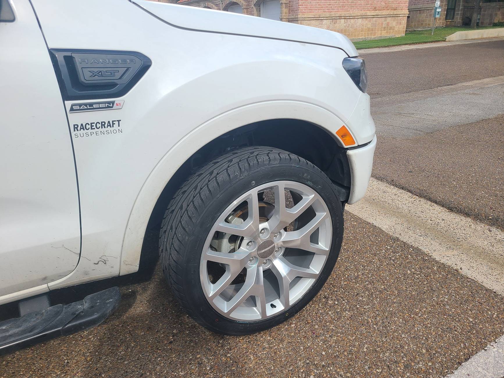

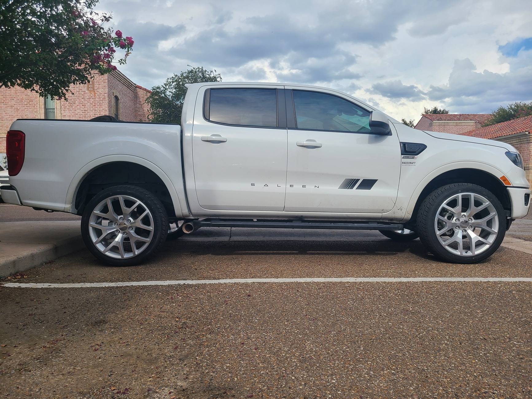

The KMC rims were a fiasco. Gave up on that idea, and went crazy. Got a new set of wheels for the Ranger in 22 inch. I thought they'd be a tad big, but between wheel and tire combo, it fits and fills in perfectly. If I lower it 2/4 that'll be the last touch it needs to get that sporty factory look.
Had to open up the bore a bit. Took them to a machine shop, and now it fits perfect.
Perfect width, diameter and offset.
Looks killer. Got a lot of looks and a lot of compliments.
Best of all, no rubbing, and still soaks up bumps relatively well.
Truck’s coming along nicely, I think I can picture the final result (with the reference provided in the previous posts).. personally I think those wheels will be a fine change and be a improvement form the original idea.

Thanks, but I didn't really have any special techniques. To try and get the best results in laying down the straightest position possible, I just used a strip of blue painters tape and eyeball it. I reused the same strip of painter's tape on both sides of the fenders to ensure the length is the same, like a template.
The straight edge of the tape provided me a line to follow and place the emblems. I used the Amazon Special 3M double sided tape. The emblems aren't going anywhere.
The small decals were placed without water or anything. My wife actually helped me place the Saleen decals. We used water and squeegee. We used the body lines of the door as a guide. They're not perfect, but you really got to look at it to find the faults, which are minor stretching.
After 2 days or so, the bubbles disappeared and layed down completely flat.

I'd use a laser level. Align it with the bottom of the fender duct, then crank it down to where you want the emblem.
And OP, sending good thoughts to you and your family. All your truck needs is to be lowered to look right.

A laser level! I've never used one, but it sounds like I can make it parallel to other things (since our bed rake makes everything unlevel).
Thanks, now I have an excuse to get a new tool! And it sounds like exactly what I need!
