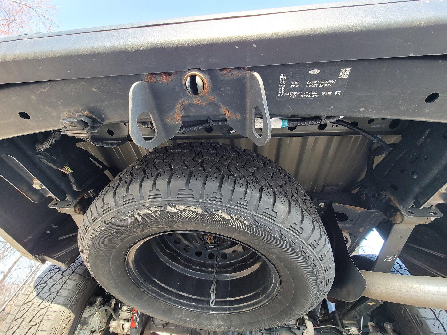

The frame is painted but that's it. After a few years it will start to chip and peel. After just one winter in Ohio mine already has a few tiny rust spots forming. Next fall I'll spray it with fluid film to keep the road salt off of it.

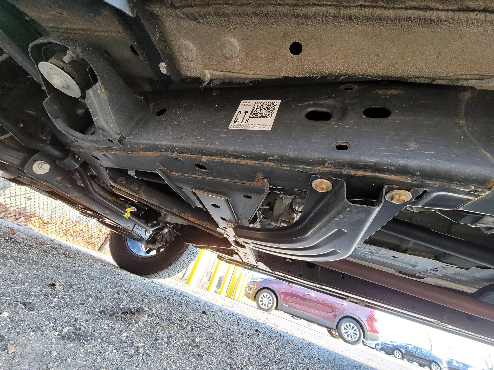

Do ford rangers currently have no protection for their undercarriage? Fluid film is something i thought about in future, but figured for now the stock protection should be enough if it had any lol
Here's my truck, after 2 full winters. I have to drive every day snow or not so my truck is exposed to the fresh salted roads. I will be spraying something on mine for this winter for sure.
