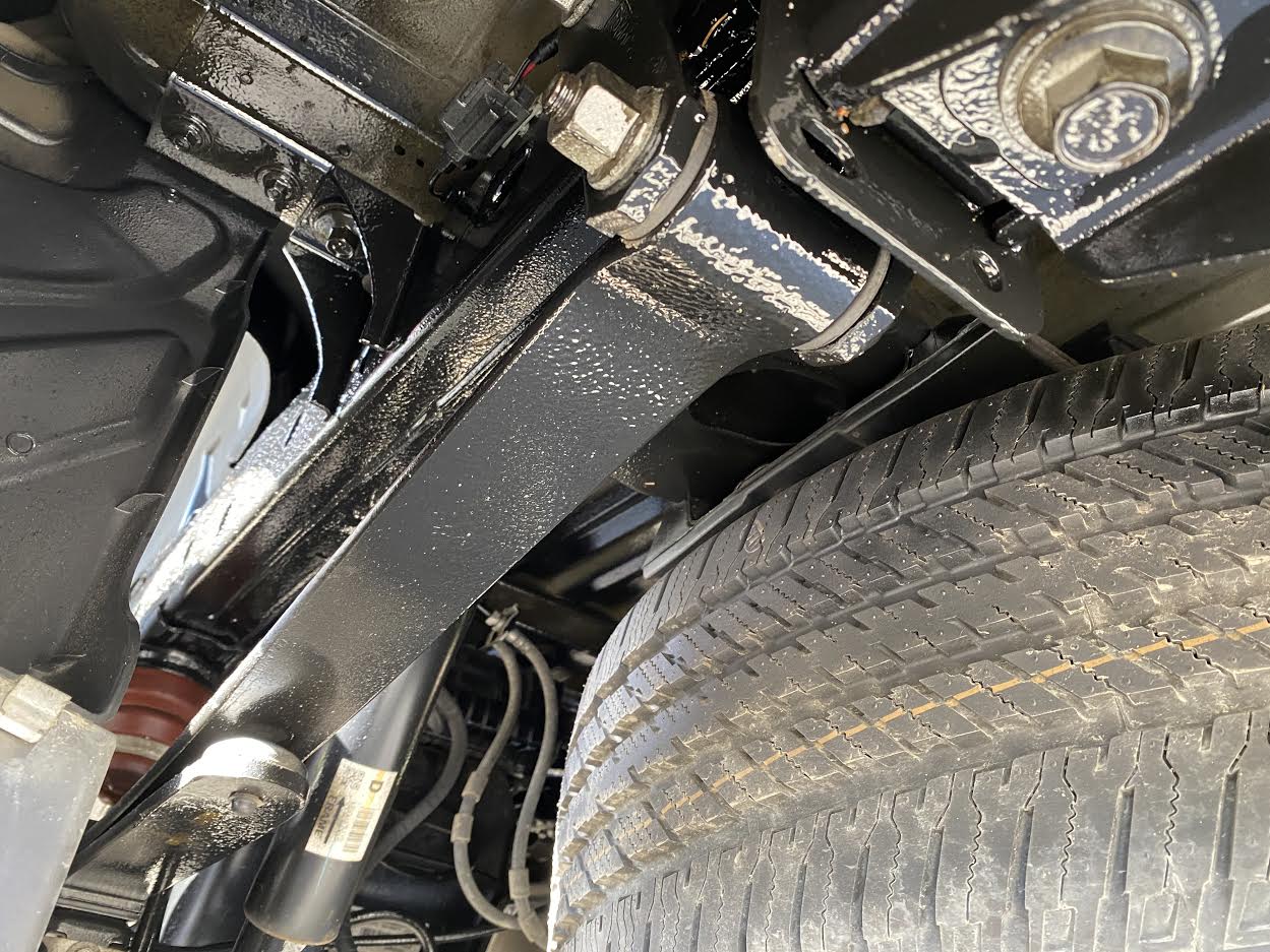

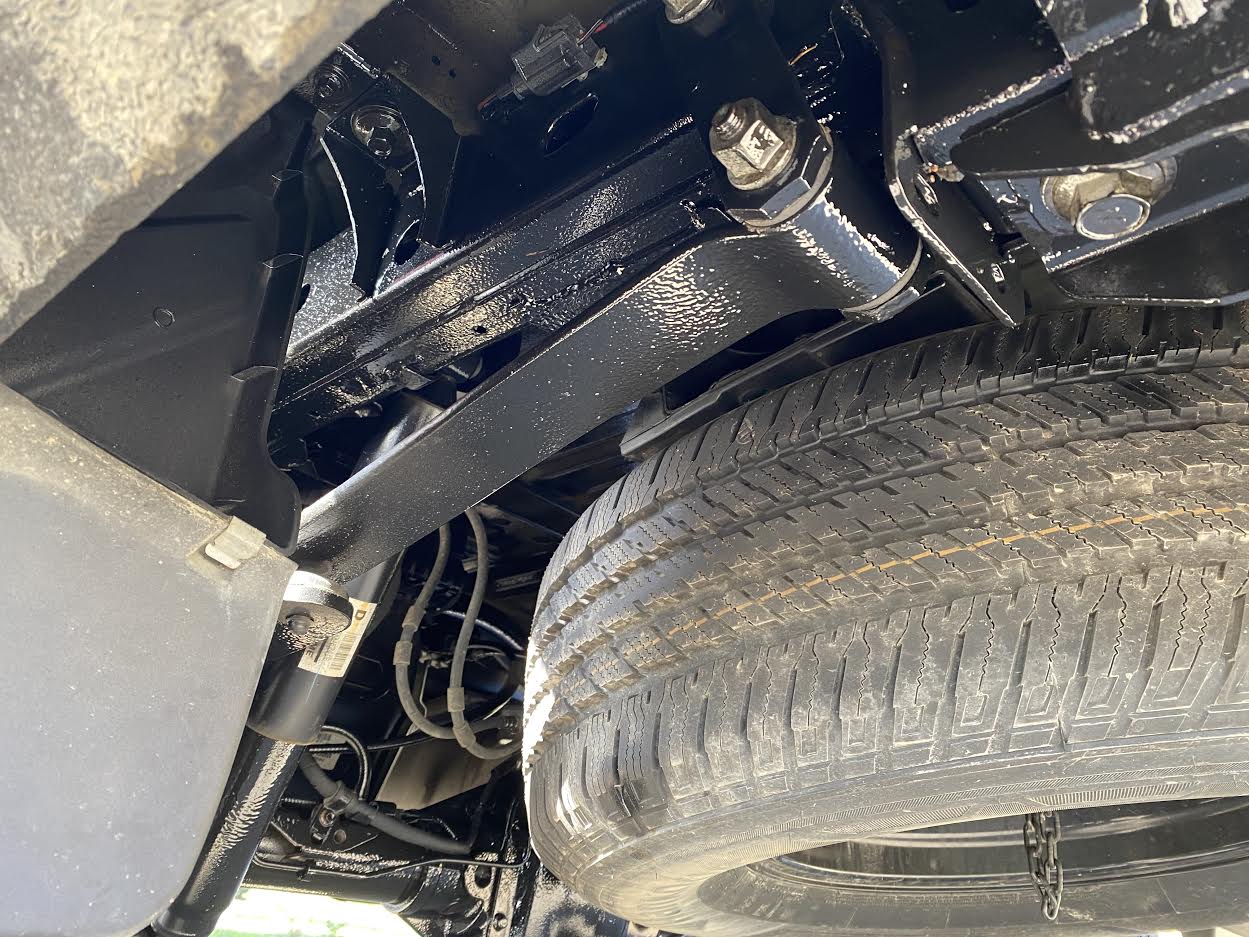

I know I'm jumping on this thread a little late, but I just had my ranger done with NHOil Back to Black System. I like the quality, the smell is not too bad. Pricepoint was fair as well.

I haven’t done it yet, but my neighbor, a shop-owning master mechanic with a plow truck, says it is worth every penny. He does the regular clear oil treatment every year, which costs about what you are being quoted. I am doing the wax treatment, which is about $800, with $99 touch-ups ever other year.
Edit: my appointment is on November 17. I’ll try to get some photos.
