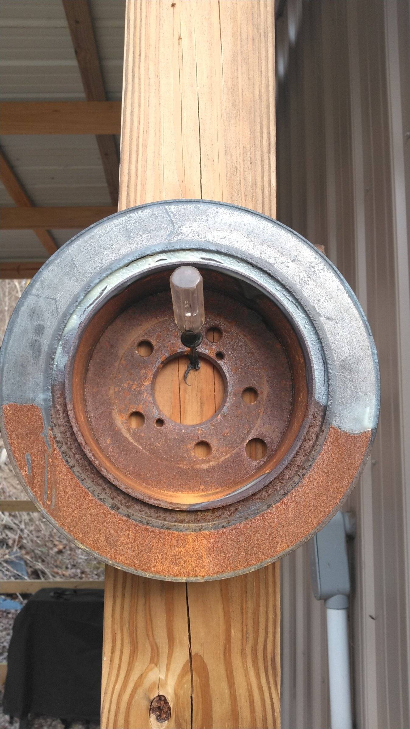

I spray several cars in my garage with this. Also sprayed both of my 2019 Rangers with it and when I sold them last year. Zero surface rust issues. Picked up my 22 Ranger about a month ago I'll be spraying it here before too long. Anyone in buying this product make sure you do not buy the spray cans. The spray cans do not work very well. By the gallon jug. The picture I posted was about a year old. If I get a chance I'm going on about 2 years now on it and haven't got a recent updated picture and I'll post it if I can.

What do you use for a sprayer?
