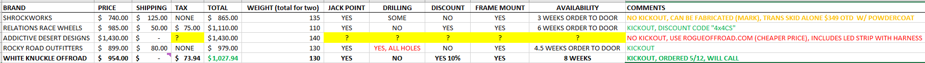

For everyone who hasn't bought Rock Sliders yet, you may want to check out White Knuckle Offroad
They now have Sliders available, and I ended up purchasing. I also have seen their work first hand, which was very high quality. They are a local shop (to me) out of Apple Valley, CA. I am not affiliated in any way with WK
Below is my comparison if it helps anyone, save some time. It is tailored/configured to what I wanted which was a kickout, no drilling, and full plating on top. The info was verified by calling the business or from their websites

Thanks for compiling the options! One note, I'd probably drop the ADD option from the list, last i checked they mounted to the cab and are just glorified side steps instead of real frame sliders.
Yea agree that one is missing all info, couldn't get a hold of them

Shrockworks was my first option actually. On the comparison for the sliders I forgot to mention it was given there was a textured finish applied and accounted for in the price. WK has textured finish available
WK mounts with three points, Shrockworks two I believe. The outer tube on WK I opted for DOM tubing (extra). Also, the full diamond plate top was extra, wanted to be able to step anywhere without my foot going through and for protection from things getting flung up from the road. For the kick out, I liked the idea that it could edge the body away from rocks to keep the tire from getting stuck in some situations, but mostly because I wanted a bed step, I am always climbing on the tire or reaching in for my gear when camping or off roading
