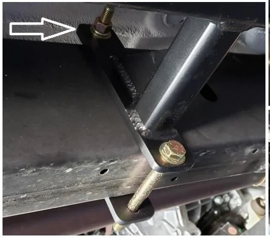

Did you order the angled sliders or the ones that stick straight out like a running board / step?
Also, did you notice the White Knuckle Offroad mounting bracketry hangs down below the frame?
Once installed you don't have anything hanging lower than the frame on the Shrockworks.... that's kind of a "pivotal" :giggle: thing for rocksliders.
The White Knuckle Offroad mounting design relies on friction to hold the slider in place. Their Installation Instruction say to "simply lift one end of the slider" to adjust for an even gap between the truck and the slider, then tighten all the bolts. So.... that's great for a step, but what happens if you actually are sliding on rocks?
Opinions vary and all this may be just fine based on how you'll use your truck. My goal here is to merely point out some concerns in the event other folks are comparing designs and trying to choose what's best for their truck.

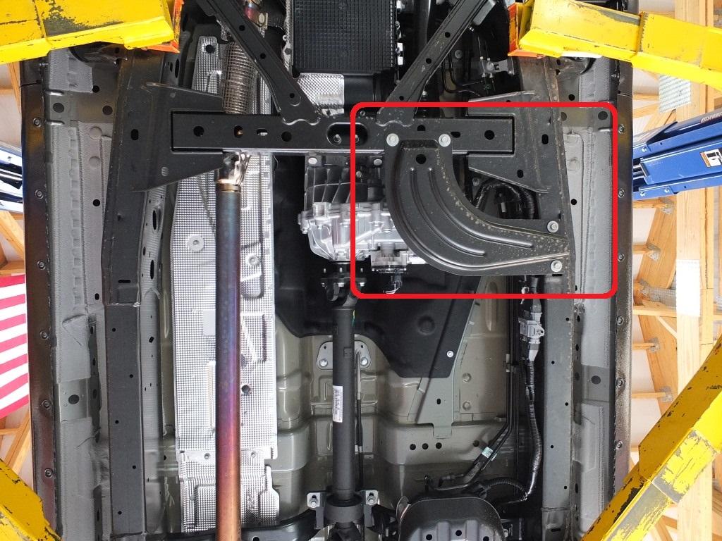

there was something gnawing at me about this hanging below the frame .... like there was already something doing that. . I went and looked and the skid plate under the driver's seat sticks down quite a bit. Without measures, it seems at least equal to what the above pic suggests - and maybe a bit more. (again, just with eyeballing it). It is only one point on the frame, but it is below the frame. Just noticing.

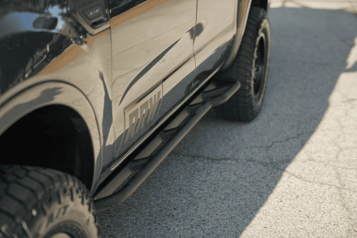

I used my rocksliders for the first time for real this weekend. Glad I have ones that bolt on. I have the shrockworks and can say I highly recommend. They are solid. 3 bolts per side and only 1 hole to drill. I would buy them again.

That's the transfer case skid plate. I agree... kind of silly having the skid plate hang down like that.
One item hanging down however isn't really a good excuse for adding 4 more, is it?

Agreed. Not necessarily making a case for it ... again just something i was remembering but couldn't place till i looked.

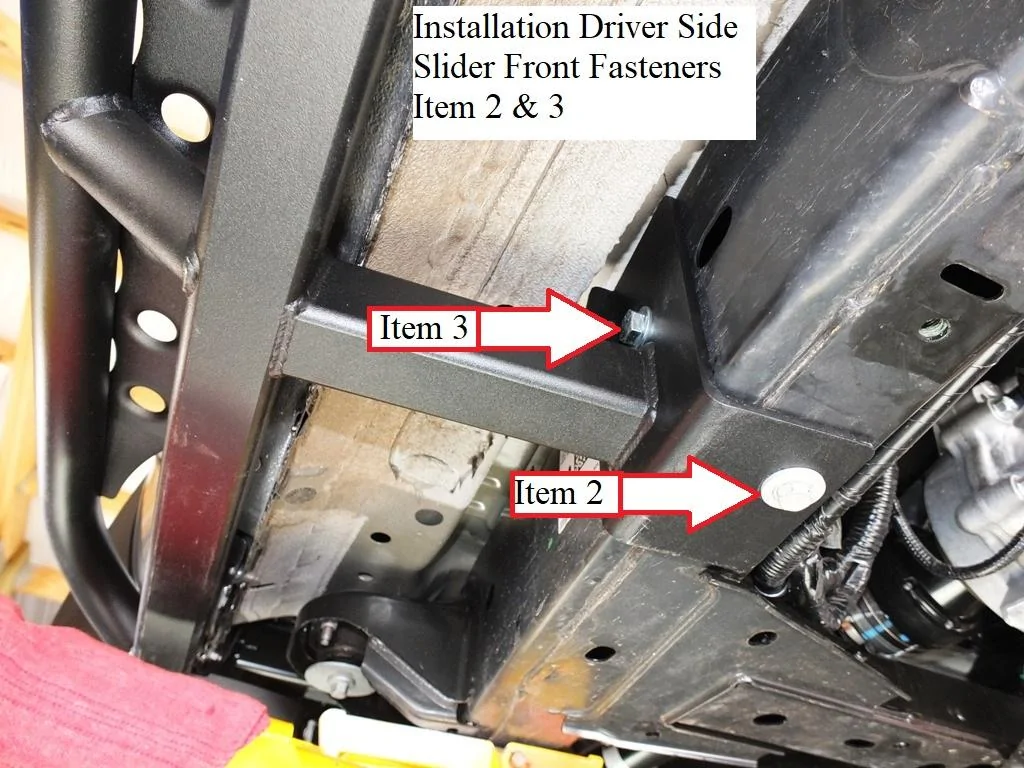

I'm looking forward to Mustang2Ranger installing them and letting us know how they fit. I'm wondering if the slider itself will impact the cab in the full up position on one end, and full down on the other.
The mounting arrangement, at 1st impression, looks questionable. Relying on friction, when the 2 components are smooth painted steel, and there is no locating bolt, boss, hub, etc. isn't ideal.

Agreed, look forward to seeing the installation and first hand impression of the system. Maybe placing a jack under the slider to if there is any flex
That would be a start, then jack directly under one of the mounting points to simulate a rock hung up on it and see if the bracket holds it location or slides upward.
The reason I say it's a start is a static load will be less than an actual impact.
