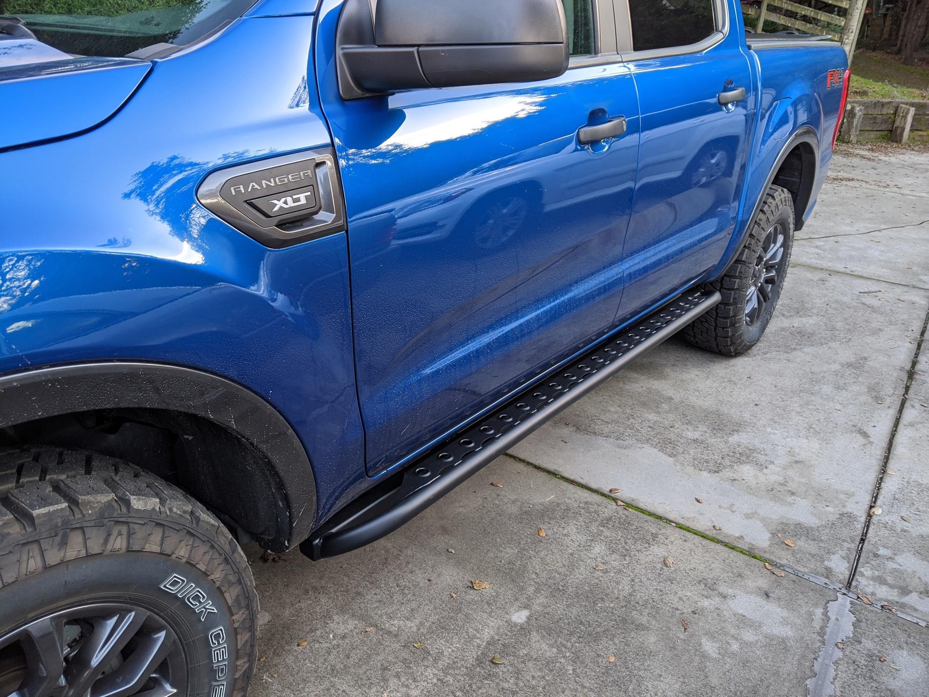

Iā€™ll point out that the photos he posted are of the Shrockworks sliders. I wanted to clarify as you were asking about the Rocky Road sliders. I have the Shrockworks sliders and theyā€™re amazing. Iā€™m not sure how the mounting looks on the rocky road.

My truck came with a set of running boards with three attachment points each to the chassis, and I noted that the Shrockworks sliders have only two attachment points - do you feel that two are sufficient, and can you confirm that it's two bolts per attachment point? I see two in the photos above. Thanks.

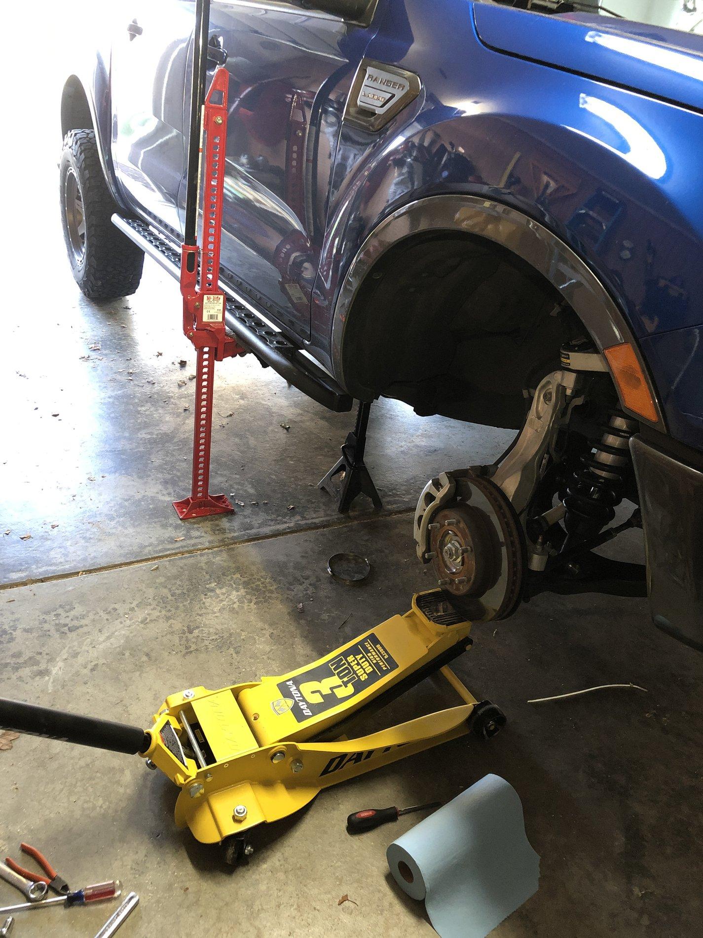

Yes I think itā€™s absolutely sufficient. The running boards are only attaching to the body seam vs these attaching to the frame with heavy duty plates. Yes, there are two bolts per attachment point. I have no problem lifting my truck with them and they show zero flex when I do so.

Pathung,
Hoosier is correct, I thought you were asking about the Shrockworks sliders. That is what both, Hoosier and I, have installed on our trucks. Comparing these rock sliders to running boards is a difficult because the way they attach to the truck is completely different, as is their primary purpose. Sliders obviously have a primary purpose to protect the truck, but they can also function as steps. Body mounted running boards will do very little (or nothing) to protect the truck but will work well as steps. In some cases running boards can get hung up on rocks, curbs, etc and can bend up into the body causing damage that wouldnā€™t have occurred if the running boards werenā€™t present. The shrockworks most definitely provide ample protection, and their mounting is SOLID; more mounting points would be overkill.
Personally, I want the rock sliders for some extra protection through a few patches of extra rocky trails I frequent. But I also donā€™t want running boards because Iā€™ve seen the damage they cause to the body when they take the first hit. Two times, Iā€™ve seen pickups with damage to the rocker panels after they went off the road and into a snow drift. The OEM running boards bent upwards and caused damage that arguably wouldnā€™t have happened without them.

My Rocky Road has three (3) attachment points each with 4 bolts. It seems really solid.
Hmmm Iā€™d like to see a picture of that. I donā€™t remember seeing 12 through-holes on each side of the frame. Also that seems completely unnecessary.

I agree with the inadequacy of running boards - unfortunately these came with my truck! I had a Nissan Frontier onto which I installed some rock sliders from White Knuckle Offroad - these were very well made, with thee bolts each to all three attachment points (hence my question about the Shrock's number of attachment points and bolts). The WKs did their job well, and protected my truck from numerous offroad rock scrapes/hits in California and Moab.
I'd like to see photos of these as well. For the WK sliders on my old Nissan, I did have to drill holes in the frame, and attach sliders via self-tapping bolts.

Partly finished installing my Shrockworks sliders yesterday, and "partly" because I noticed that I was short a "stick nut"; this is a nut that is welded to a bendable metal stick, to go inside a frame tube in order to capture an incoming bolt (the set of sliders requires three of these stick nuts, while a fourth bolt simply uses the transfer case shield's existing threaded hole). I called the vendor this morning and they'll be sending me the missing nut this week.
These sliders are good looking; I like that they're subtle, and hug closely to the rockers.
