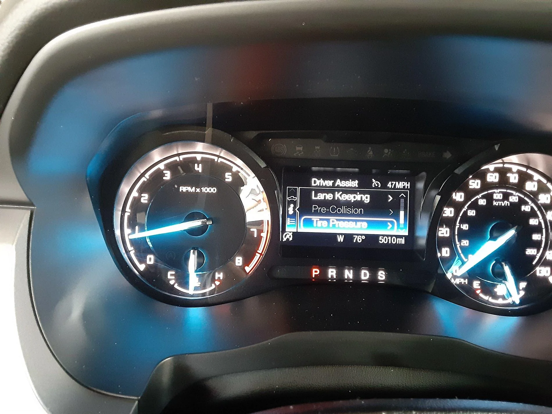

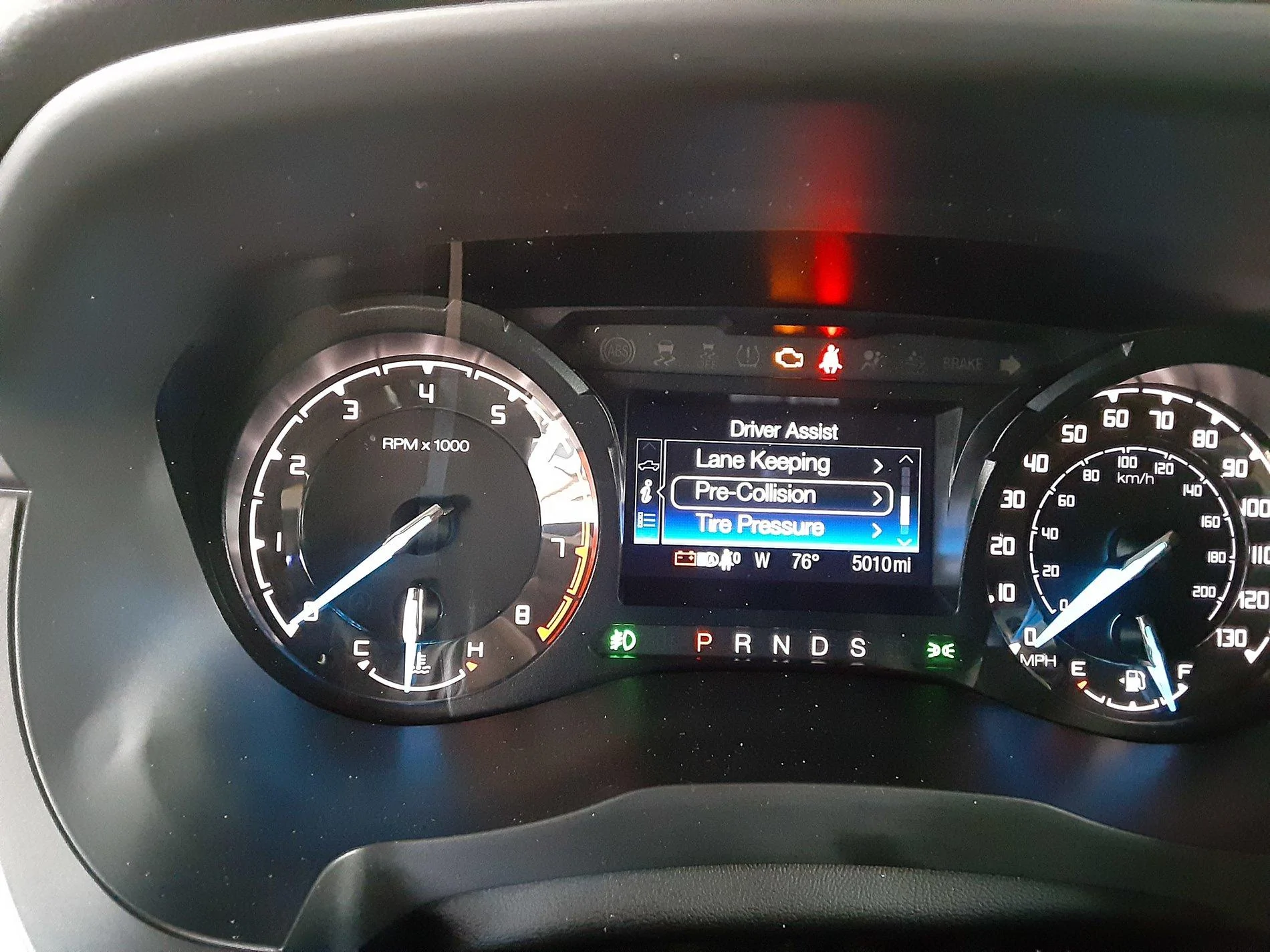

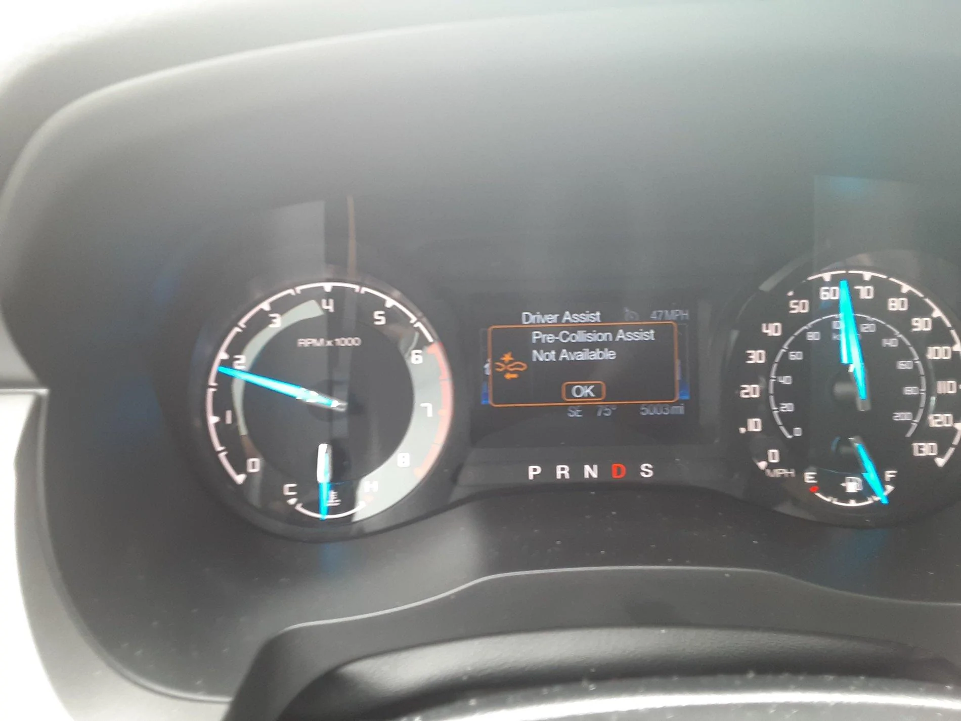

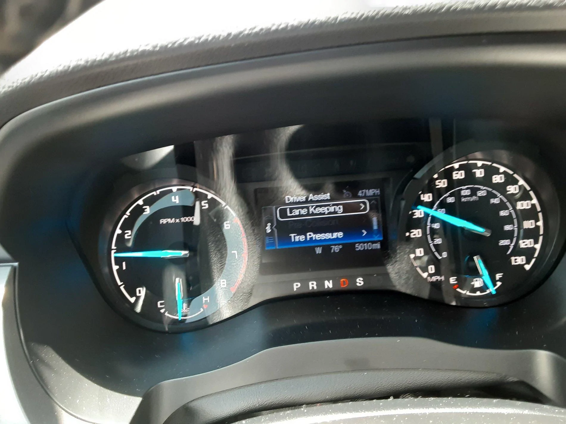

Pre collision red screen flashes....then warning pops up ( Pre-Collision Assist not available )
Then when I looked thru menu....Driver assisted .....the " pre collision " option is no longer in menu.
Park the car....the "PRE COLLISION" option is barely visible.
Turn the truck off...and restart.....the "PRE COLLISION" option is back!
My local Service department doesn't believe me....even with photos.....

FIRST PIC IS THE NOTICE ON THE DASH AFTER THE RED LIGHT ALERT.
SECOND PIC IS THE MENU WITH NO COLLISION OPTION IN IT.
THIRD PIC IS THE OPTION BACK BUT BARELY SEEN
FOURTH PIC IS THE OPTION BACK AFTER THE CAR TURNED OFF AND RESTARTED
