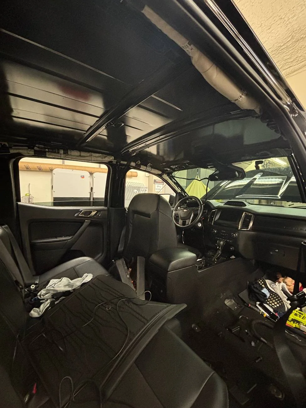

Hey all. I few months ago I tackled a project of dying my headliner black aswell as an abundance of trim pieces within the cab. Everything went well!
Except one thing. For the past few months I’ve been driving around getting the warning “Pre Collision Not Available” “System Fault” This is likely a result of something that I did while working on the headliner.
My question is though, WHAT is wrong?? I’ve checked all wire connections, there only seems to be one connection up in the headliner that goes to the front facing windshield camera. Could a fuse be blown for it? Where would that be located? I checked the manual and all.
I’m just hesitant to take it to Ford because likely this is a self induced problem, and just the fact that I like to fix things by myself. If anyone could shed some light on this let me know. Tonight I spent 5 hours taking the headliner back apart and no wires were messed up. I’m at my breaking point trying to figure this out and something is going to go flying across the garage.

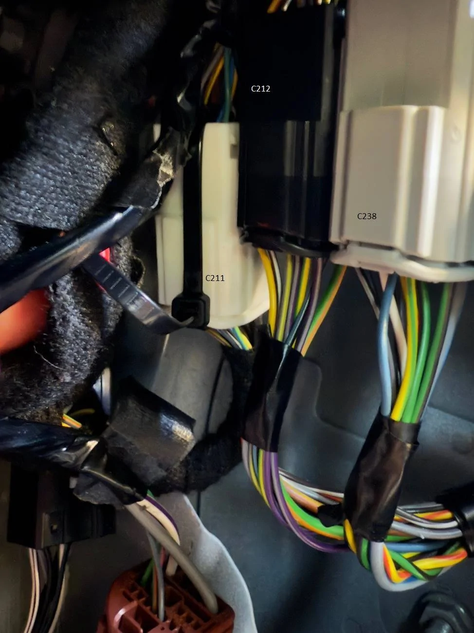

Did you pull the passenger side (Kick Panel)?
If yes you may have hit the connector C211 with the locking clip on the panel as you slid it back on.
This connector feeds C913
C913 = Power Feed (Only)
This is the Driver's side A-Pillar connector about dash level
C903 = Can Bus Communication to the ABS & CCM (From / To the IPMA)
C903 & C913 Feeds the C919 Connector

So, the above is all the associated wiring that would / could have been touched for your mod
Everything seems to be connected properly and alright. Going to run for codes this morning.
