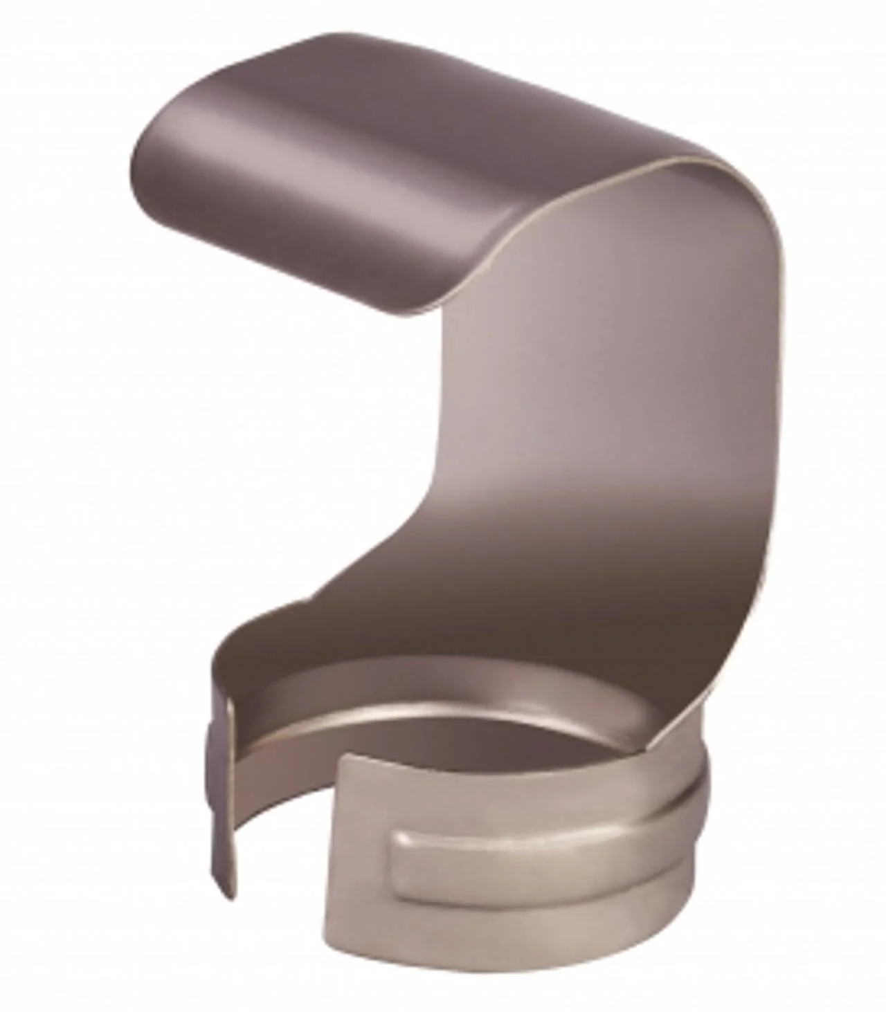

That is creative, I use one of these when doing heat shrink on wiring.

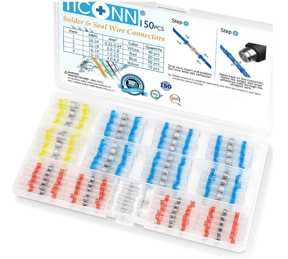

I use them with a heat gun in conjunction with Solder Seal Wire connectors. Works great - solders, shrinkwraps, and seals without breaking out the soldering iron! I do flux my wires though.
I am in the process of adding a light bar to my new Cub Cadet lawn tractor - the stock lights aren't worth turning on! My 50 year old WheelHorse has better lights. I mow just at dusk to insure a dry lawn, and sometimes finish after dark. I'm using these connectors to wire it all up.
