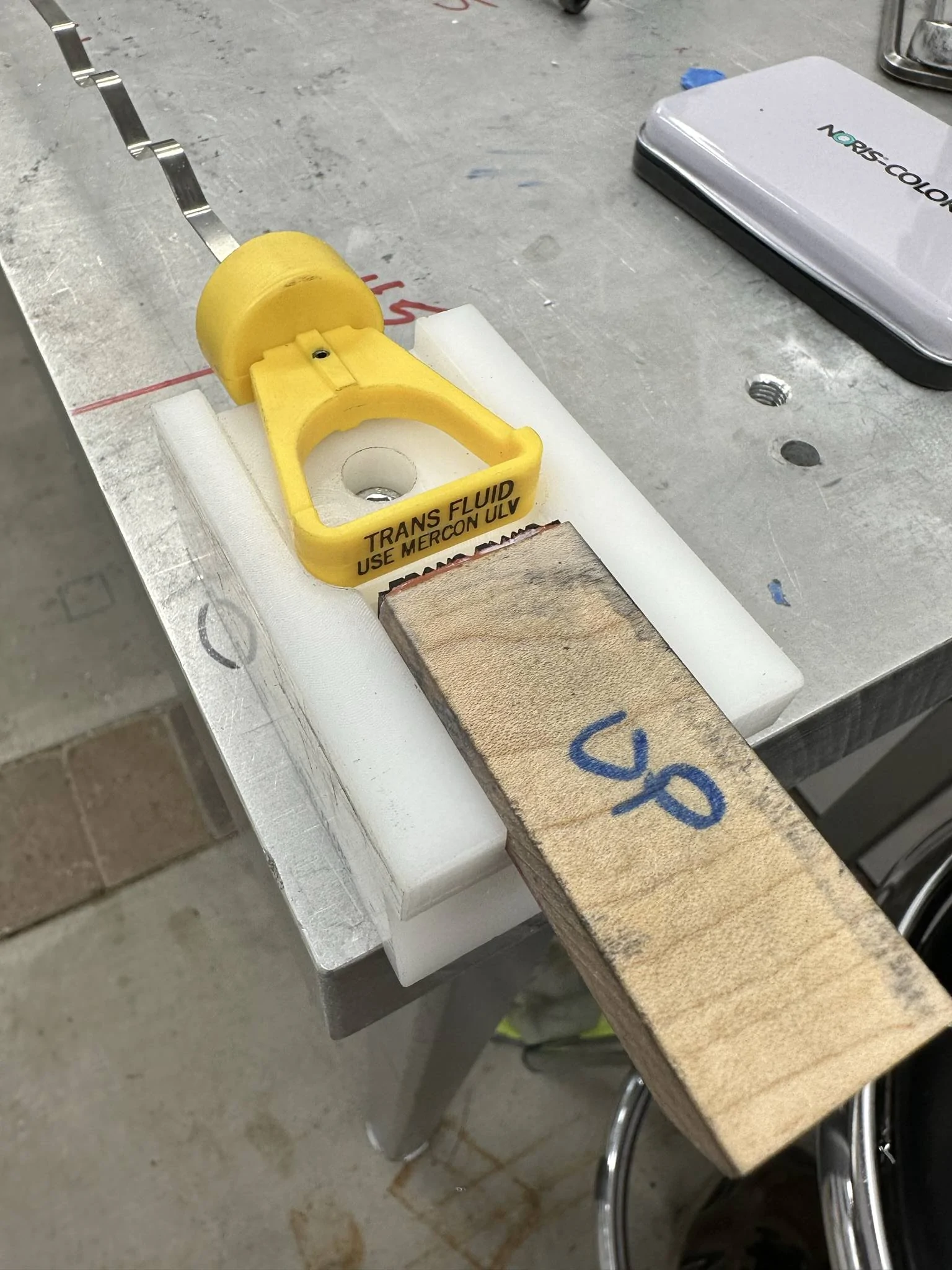

Well still waiting on hoses, which allowed me to work on the instructions and the stamping fixture, I finally got the updated stamp and the ink.
I knew I had to make a fixture, there was no way I was going to try and freehand it, came out well.
I knew I had to make a fixture, there was no way I was going to try and freehand it, came out well. View attachment 193722
Looks perfect!!!!
Your'e KILLIN IT!!!! That looks Better than factory.... ??

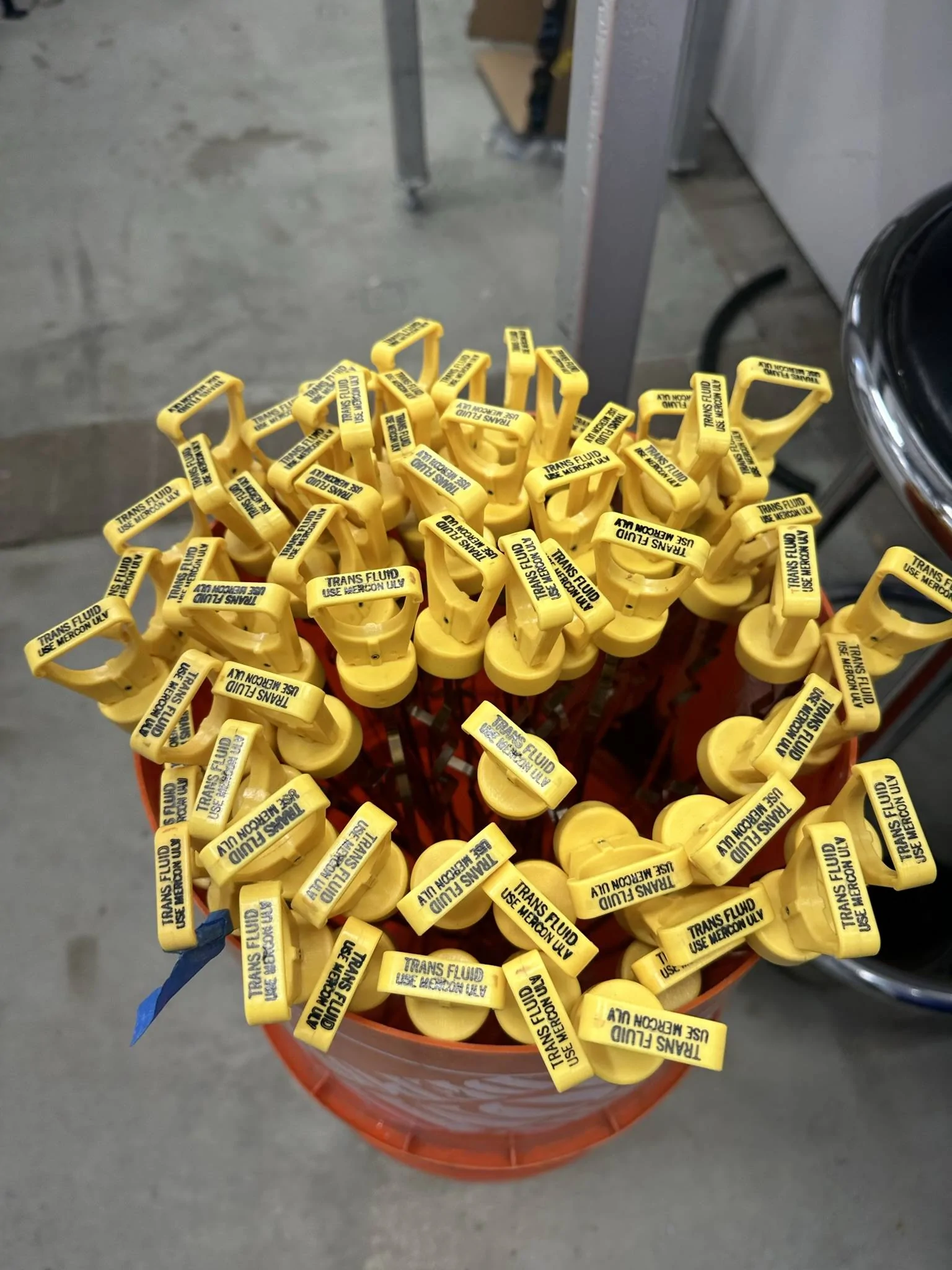

failed to stamp the sticks perfectly, it was more difficult than I expected, I had to completly redo about a third of them, the ink is solvent resistant so it dries fast, it's difficult to work with and some of the handles are not flat, actually I had to lightly stamp the whole pile a second time, they are as good or better than stamp I removed at least... I hope!
Amazing Mike...I can feel your excitement "tooling up" lol...what kind of ink are you using? Obviously pretty permanent...
You missed the "solvent resistant" part?, it's from the stamp mfg, who knows what it's made from, it's thick and difficult to work with, dries so fast, the ink pad dries every 1-2 minutes, so you have to keep inking the pad to get a clean stamping, brake clean barely affects it, in fact when it's dry you have to soak it.
I'm not sure I would associate "excitement" with tooling, it's more like "I need to do a certain task, but wait, I cant, I have to make a tool first".
