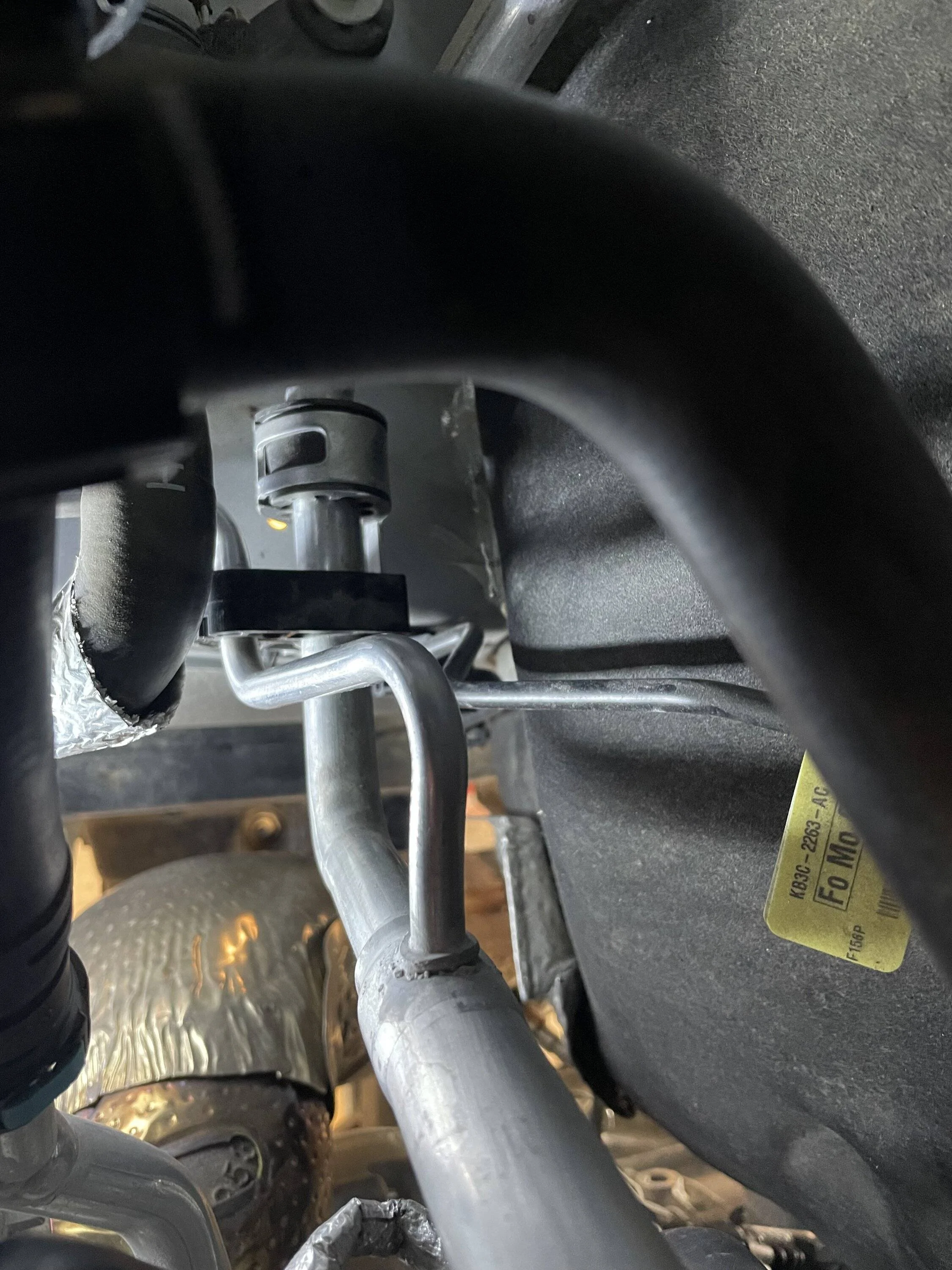

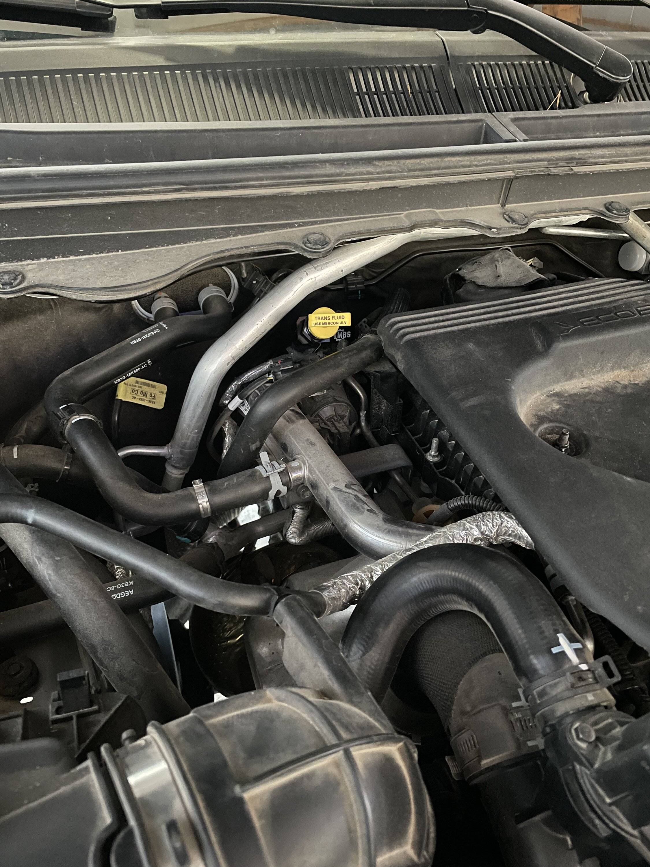

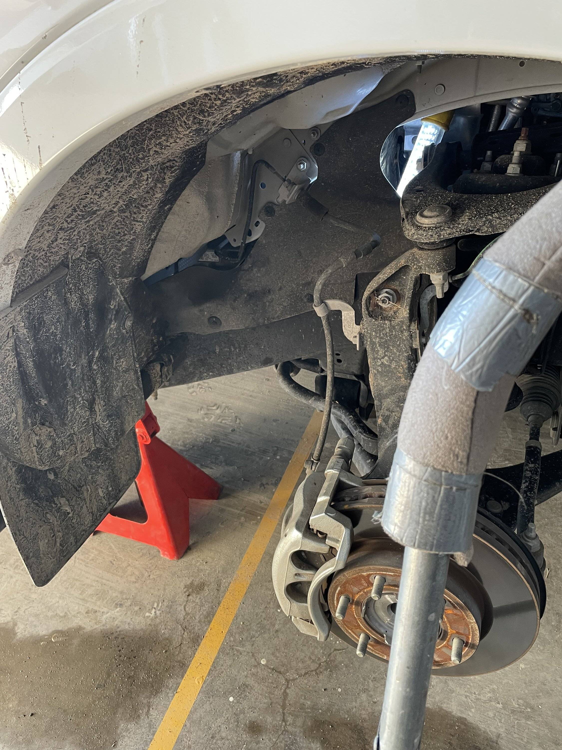

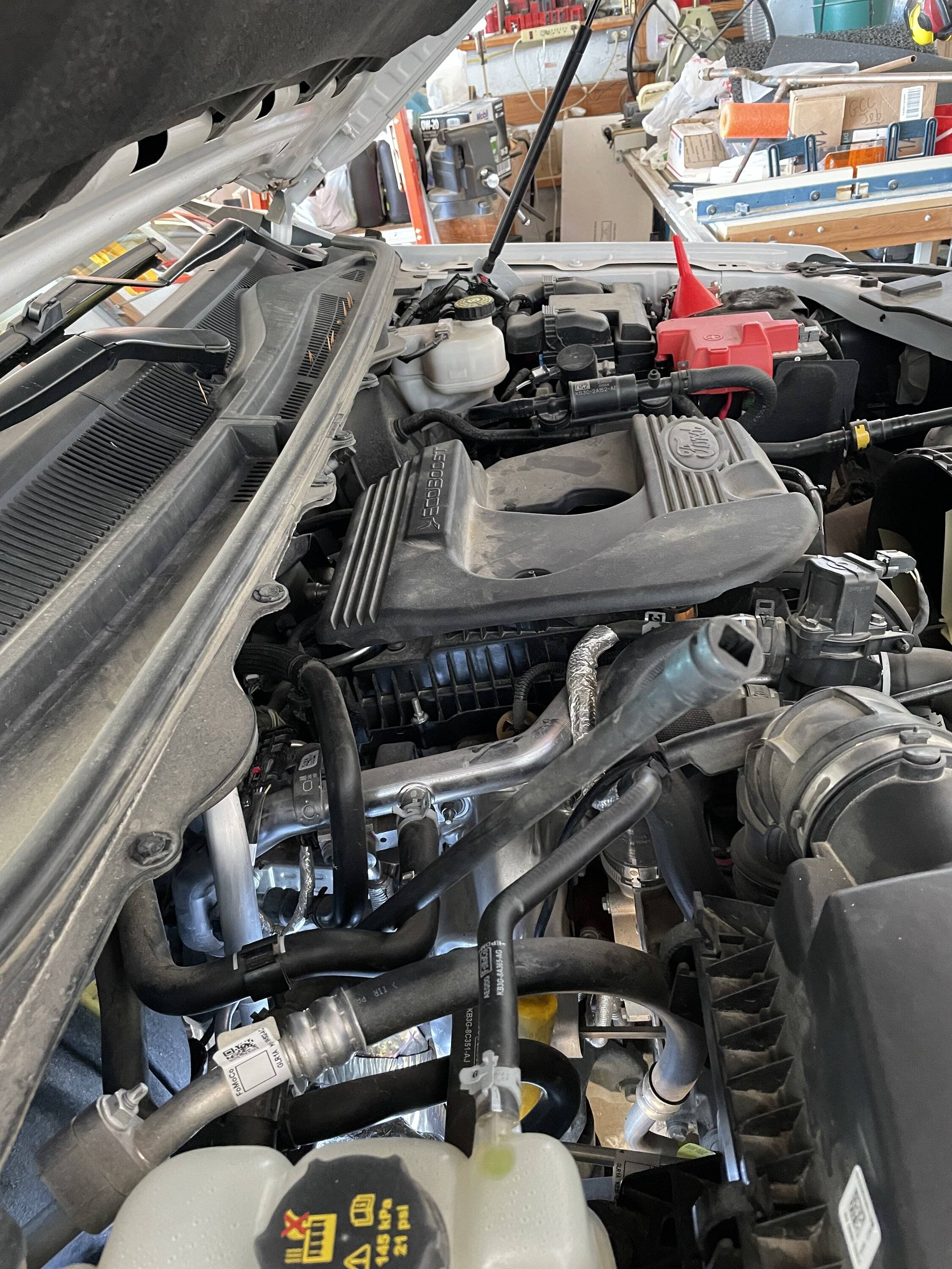

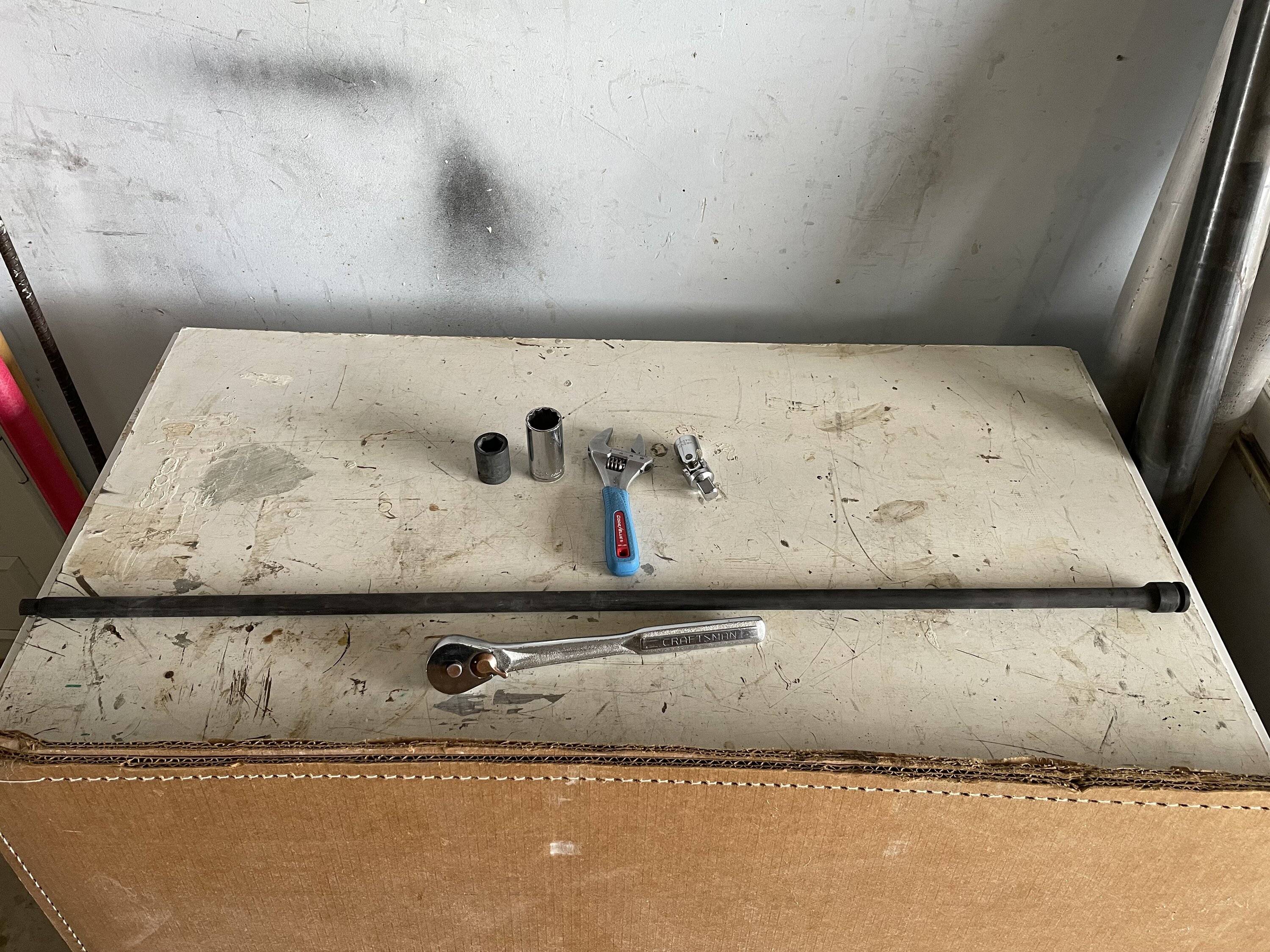

A few notes. It was cold and snowy, but I was indoors, though unheated and I did the install.
After having previously checked the fluid, I knew my plan. I pull the front right tire. It’s not necessary, but makes it very easy. Then I use a really long extension and flex for a socket with magnet to get the factory dipstick. I run it down to set it on the trans case, and then reach through the wheel well liner and put it on the cap. I did the same to new stick fitting. That makes it easy to remove and install.
For the tube, it just dropped right in. I used a short adjustable wrench through the wheel well to tighten it. The hardest part was getting the top bolt to start threading. Yes, I did leave the lower fitting loose until I got the top bolt in.
I had previously “adjusted” the wiring harness and AC line. My AC line did not have a bolt on a bracket I could see; just a plastic clip.
Here’s a few pictures of that, tools, and the install.

If not removing the tire, does it help any by turning the wheel all the way one direction or the other?
RedlandRanger
Nov 14, 2018
42
5,124
11,158
I turned mine all the way to the drivers side which opens up the rear part of the wheel well - that allows easier access I think.
