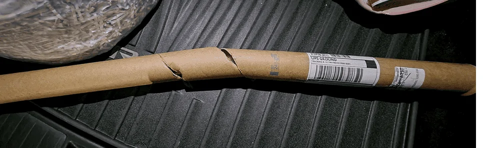

As an update for the replacement sticks for the very first batch, the shipping tubes were a marginal choice, out of 6 of them only 1 showed up perfect, 2 were completely folded.
I may try PVC pipe inside or switch to the thick tube that they ship metal in, I'm still working on it!!

Instead of a piece of pvc, maybe try a piece of the split foam pipe insulation. It comes in several inside diameters.....slip the stick inside and slip the piece of foam inside one of those shipping tubes....foam might give it enough rigidity/protection, and the foam is cheap enough....I think like a buck or so for a 6 foot length.
The thing is, I either need rigidity, or tougher shell, the stick has actually survived in the folded tubes, it's just needing some extra something, I thought that even the fiber tape around the outside.
I am also considering the small square boxes, a rolling tube must get easily damaged in the back of a UPS truck.
I dunno, I'll figure it out, thanks for the input?

I have just received mine in the square box. It was in perfect condition. Not even a dent in the packaging.
That is the entire dipstick assy, it's the dipstick itself that is the shipping challenge.

Just speaking for myself Mike....if you have to, just ship the stick the same way as you did with the entire assembly....attacked to a backing and then inside the box, and charge me for packaging/shipping.
I'm definitely not going to quibble over a few bucks extra, especially with all you have done.
Just thought of something....
Attach stick with some wire ties to a thin piece of wood, like the thin paint stirrers you get with a gallon of paint, but longer, or a piece of 1/2 inch wood dowel and slip it into the shipping tube....
Piece of 1 inch x 2 inch x 8 foot long furring strip is only $1.58 at Lowes, and you could get 2-3 shipping pieces from it....
