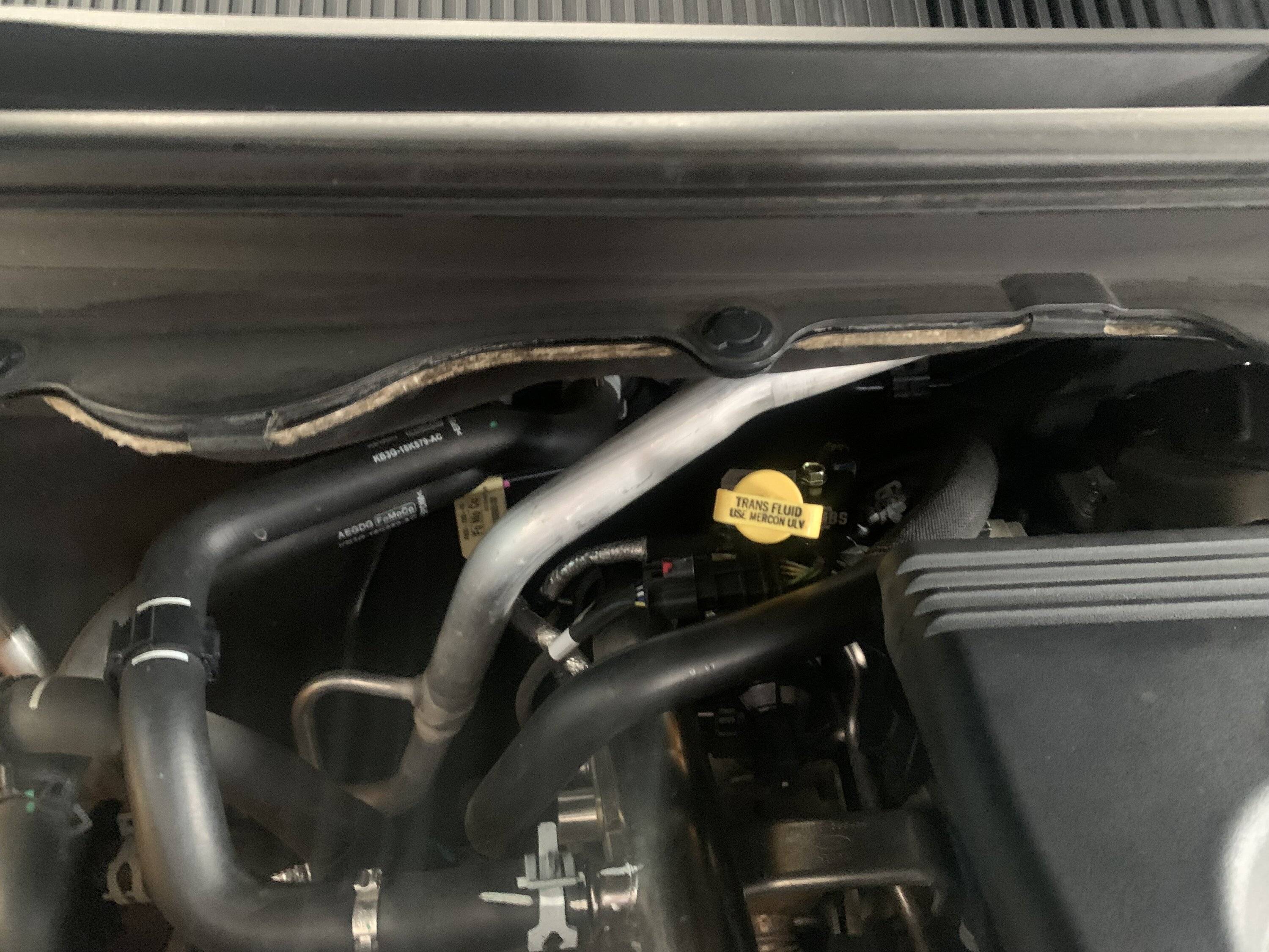

#33 Installed the today thanks Mike for the great product can’t wait for updated stick.
I could not go from the bottom because I have an ARB aftermarket skid plate.

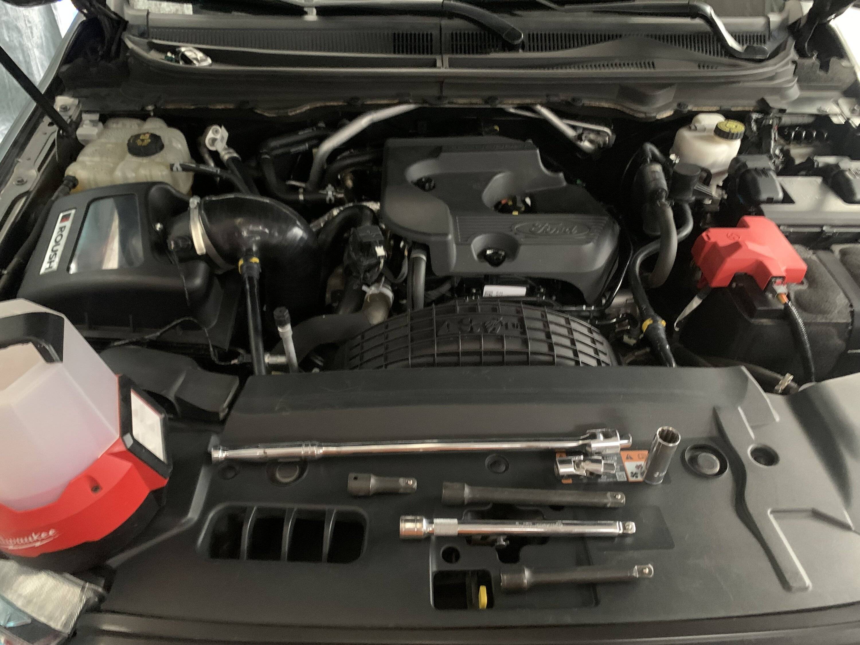

I went through the passenger wheel well 1st the cap is easy to see once you remove the plastic flap like others have stated. It was still too hard to break it loose from the wheel well so I decided to go from the top using
19 mm 12 point deep socket 1/2” drive
1/2” Swivel
3”+6”+8”extension+10”wobble extension last so 27” total.
With 18” 1/2” drive breaker bar
But having plastic flap removed helps a lot to line up socket and clean area around stock cap. And install all new hardware

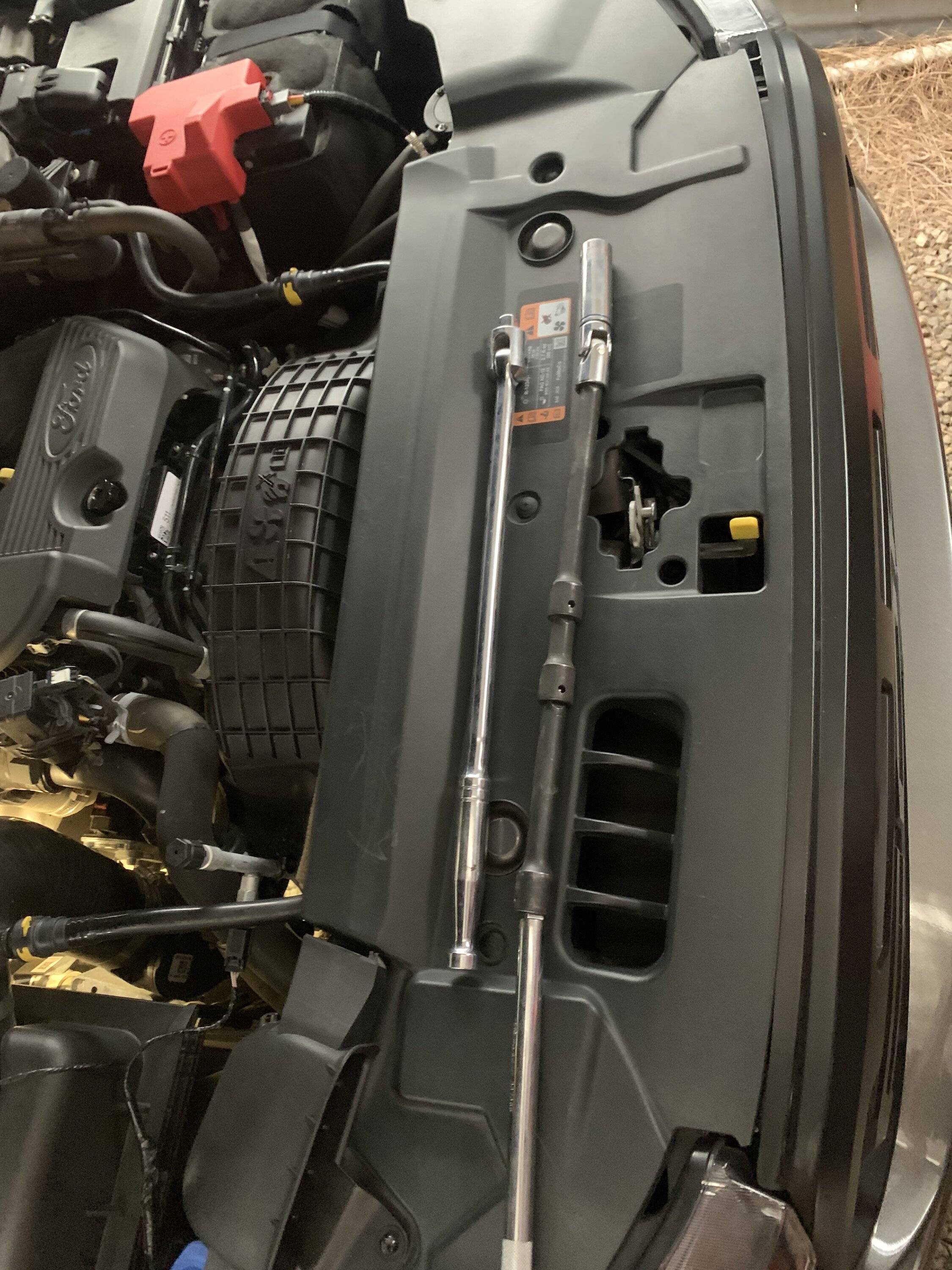

Once I was able to break it loose it was still difficult just had to position the breaker bar in the best spot to make it work. Might have been better if I had a little more extensions maybe 6”. It was still hard to break loose with breaker bar. After I got it broken free, it was easy to hand, loosen with the extensions as seen in the video.
Here’s the path I went with extensions
After comparing fluid levels from stock stick to Fitzstick they were spot on.

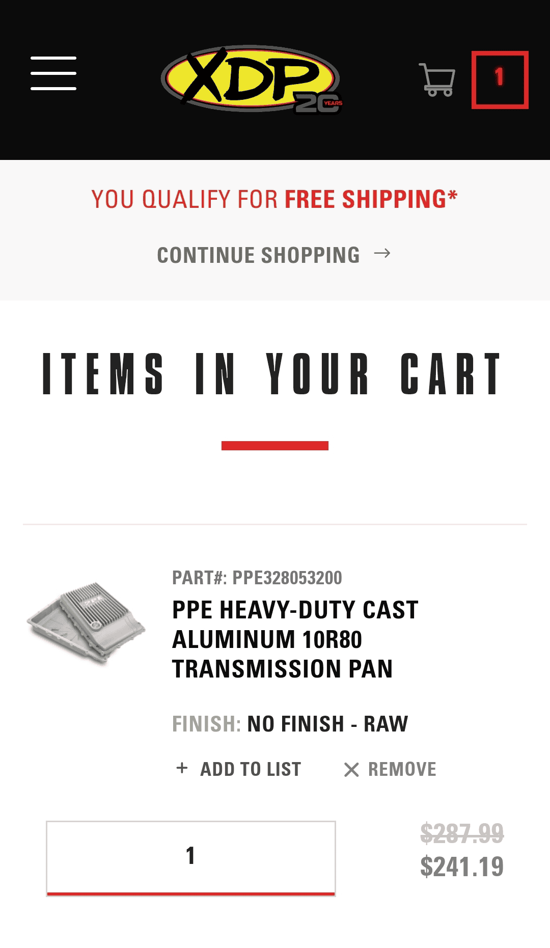

I just ordered one along with grump. On sale for a few days
Just as a heads up, PPE pans are on sale for $259 (raw finish) a couple places. This price is using the code DIESEL20R (credit to @MountainGoat from a trans pan thread for the code) on xtremediesel.com. I think the finished options add $15ish per step up and the deep pans are the on the same pricing scheme.
