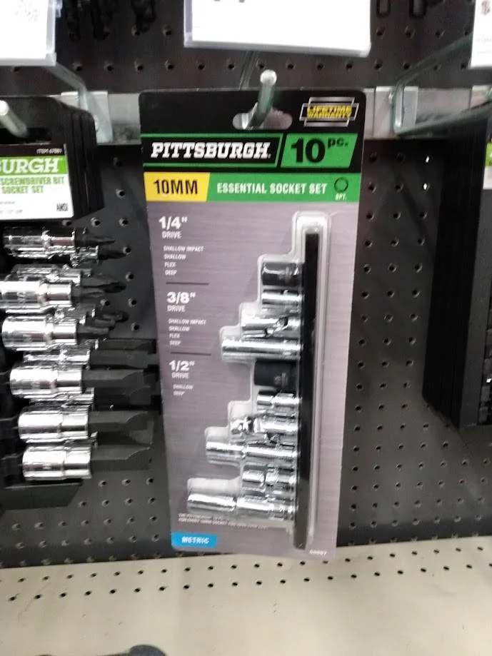

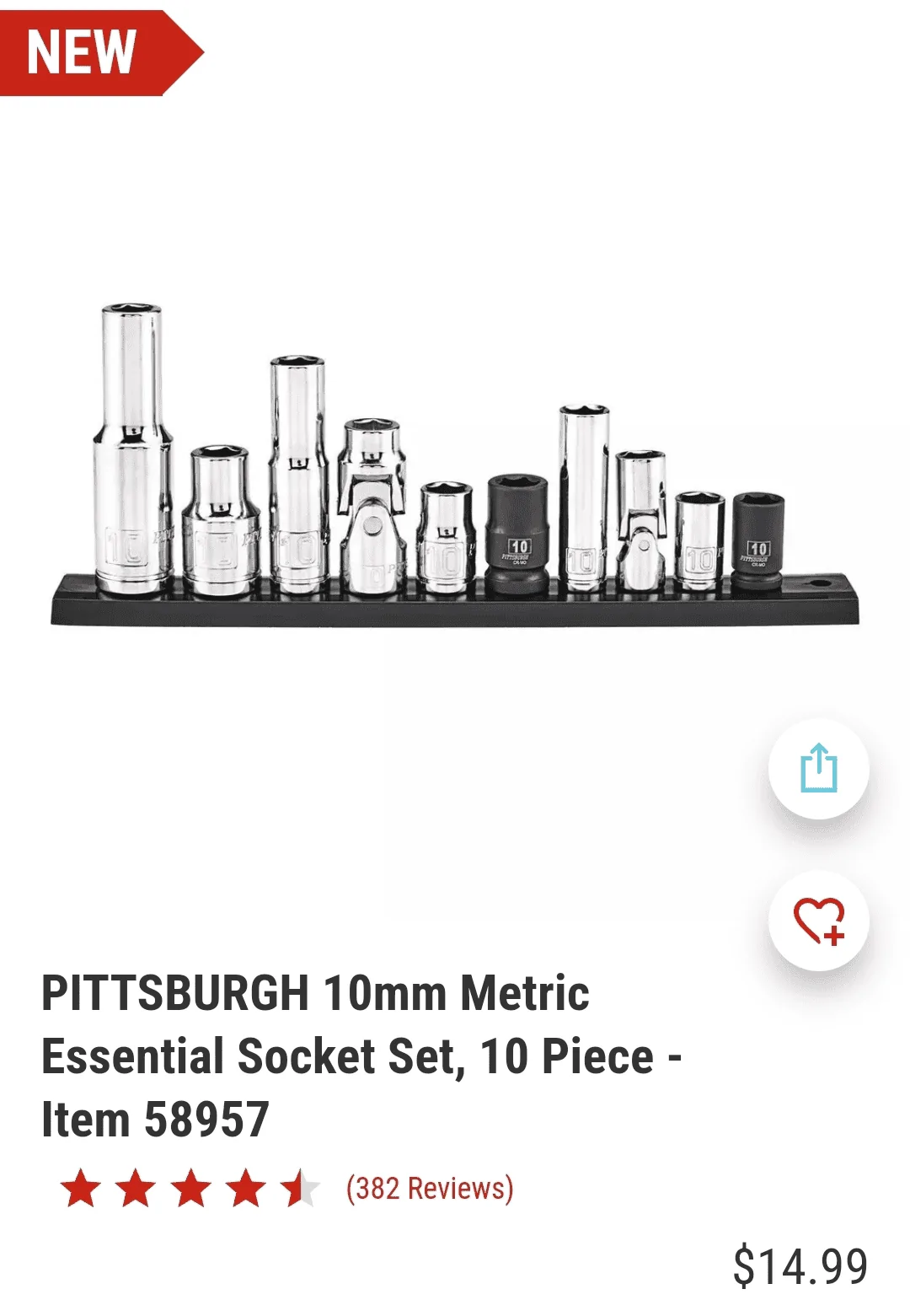

It's legitimate.....just went to my local Harbor Freight web site, and that 10mm set is pictured, real, and $14.99
Going by there today....I'll take a pic. May even buy one for Sh-ts n Giggles.....

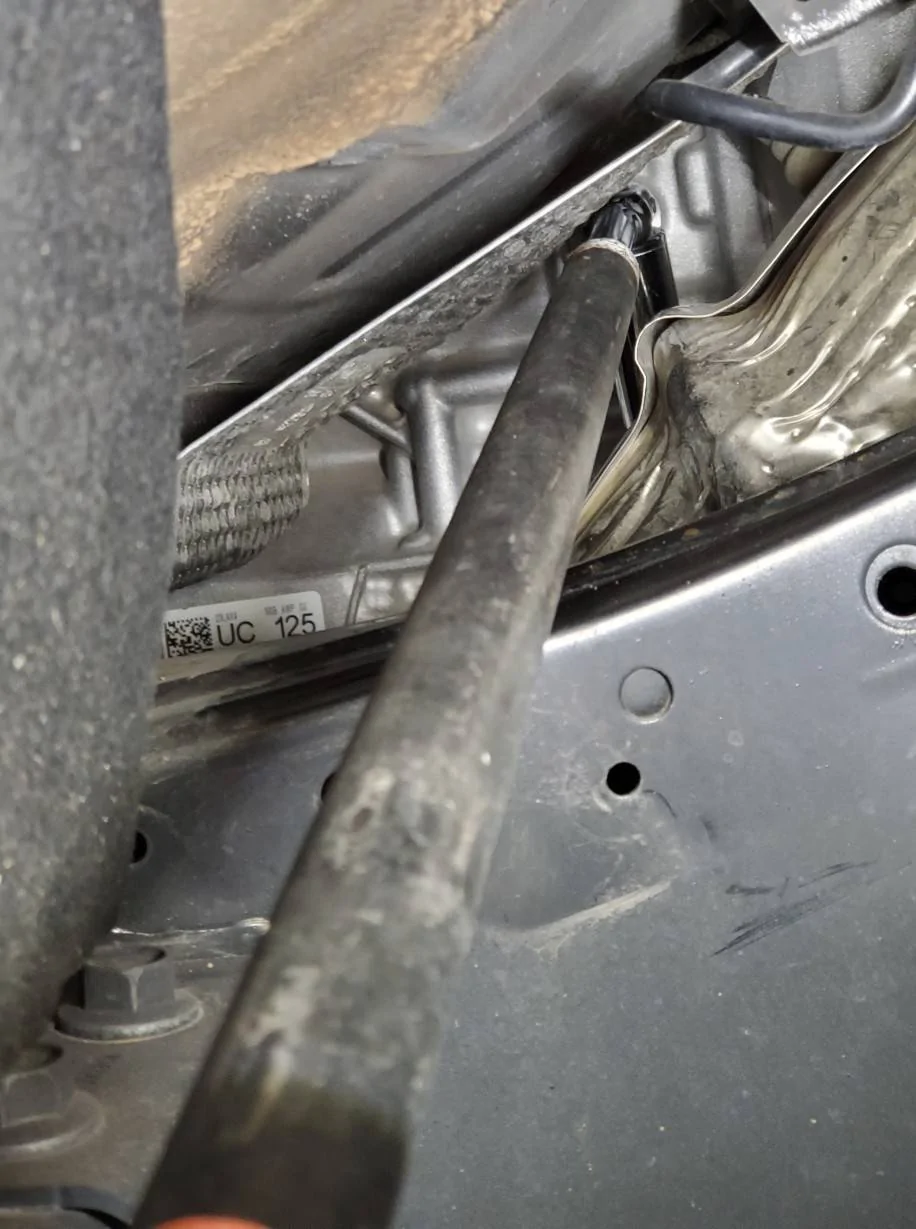

As many have commented, accessing and removing the OEM cap was a challenge. We have the FP/Fox leveling kit which provided enough clearance to work underneath laying on my low profile creeper. I was unable to break the OEM cap loose. Not enough room to comfortably swing a hammer attempting to hit a wrench on the OEM cap.
To go in from the top, I would need to buy long extensions that would likely never be used again.
I turned the wheels full left, removed the liner, then easily removed the OEM cap with a 12" long 3/8 inch drive flex handle breaker bar, 3/4" deep well socket, and 24 inch section of 1/2" steel pipe for reach. My tool collection does not contain a 19mm deep well socket. I used 3/4" deep well. NOTE: 3/4" = 19.05mm
This method provided the best torque angle with plenty of clearance for swinging the bar to the right and easily removing the OEM cap.

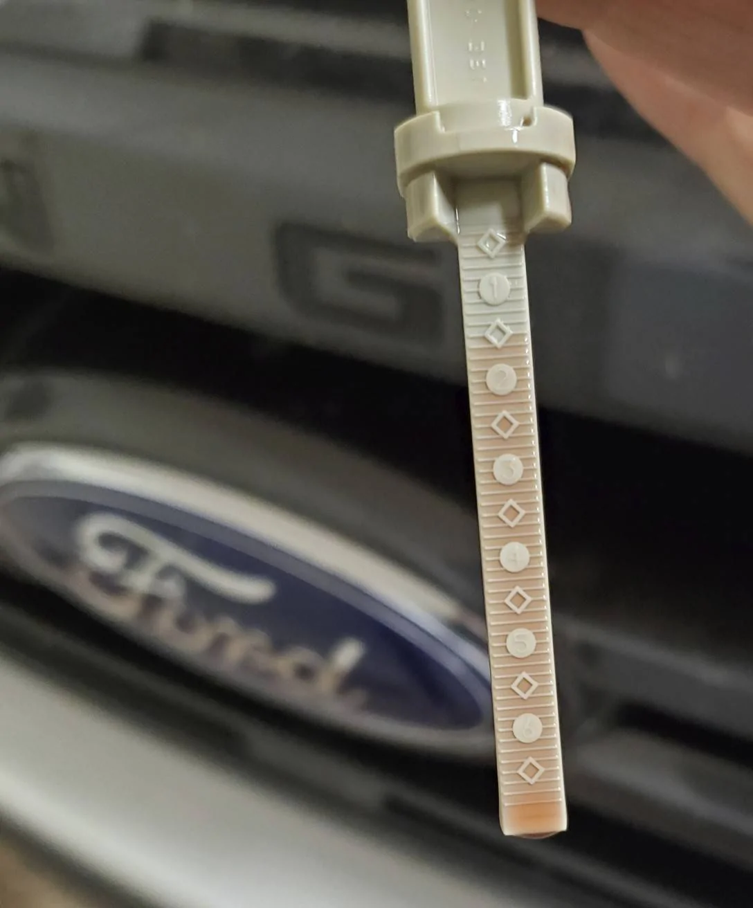

Initial cold level: (FitzStick initial cold level measured nearly the same)

How long is that 1/2 inch pipe?
I need to get one.
This one is 18 inches.
I used 24 inches to make sure I had adequate reach and extended out beyond the frame as shown below. This setup applies a solid nearly 90 degree torque on the OEM cap which broke loose easily.
