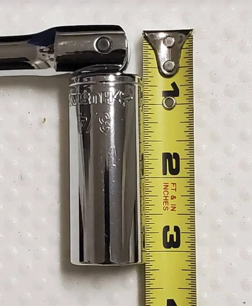

I used 24 inches to make sure I had adequate reach and extended out beyond the frame as shown below. This setup applies a solid nearly 90 degree torque on the OEM cap which broke loose easily.
This pic shows the full 24 inch length. The red at the very bottom is a plastic thread protector cap on the near end.
That’s interesting…all I had to do was use a ratcheting 19mm wrench… was able to brace my arm on something…and with a couple quick pops…was able to crack it loose. All just laying on my back under the truck, sitting on the ground.
Maybe I was just lucky. ??‍♂
Same. Used a gearwrench.
Thanks.
One more question.
It looks as if the breaker bar is either close to the heat shield or touching it. I'd like to use a breaker bar ratcheting adapter along with the deep well socket. Think there's room for both before I make the purchase on Amazon?

Thanks.
One more question.
https://www.amazon.com/ARES-36004-3-Ratcheting-Breaker-Adapter/dp/B08NT7L7RX/
I started with the bar leftmost near the heat shield as the required loosening movement is to the right.
That adapter you linked to may work with a standard socket, but perhaps too tall with a deep well socket.
I first tried a standard socket with a 3 inch extension. That was too tall. Need to have the correct height above the cap so the bar swings freely in the open plane.
Once loose, the cap spins off by hand.
Many thanks.
I'll try without that ratcheting adapter.
