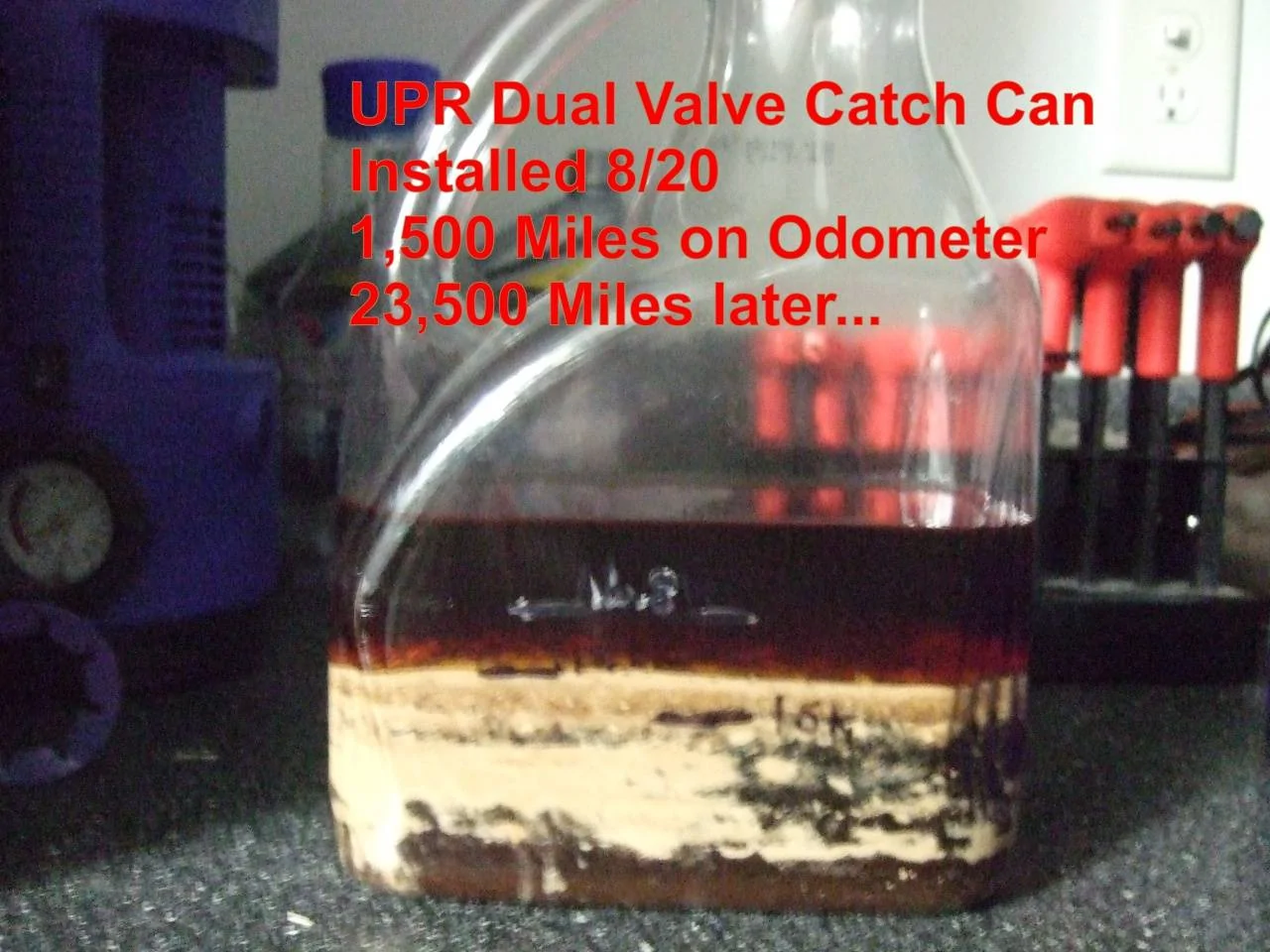

When I bought my 2019 new the dealer offered an oil change at 300 miles and from there on I've had the dealers use full synthetic. I get it done somewhere between 5 and 7 thousand miles. Had the dealer change out the rear diff oil at around 25K miles and more recently the dealer did my transmission and filter at about 45K. I had already installed the MBS transmission dipstick and the level from the factory was fine although the fluid darker red than after it was changed. The dealer also underfilled the transmission enough that I was able to add 12 ounces of Lubeguard Platinum without going over the maximum level.
The catch can has been pretty reliable in separating out who knows what that crap is - water? Paraffin? Gasoline byproduct? Oil?

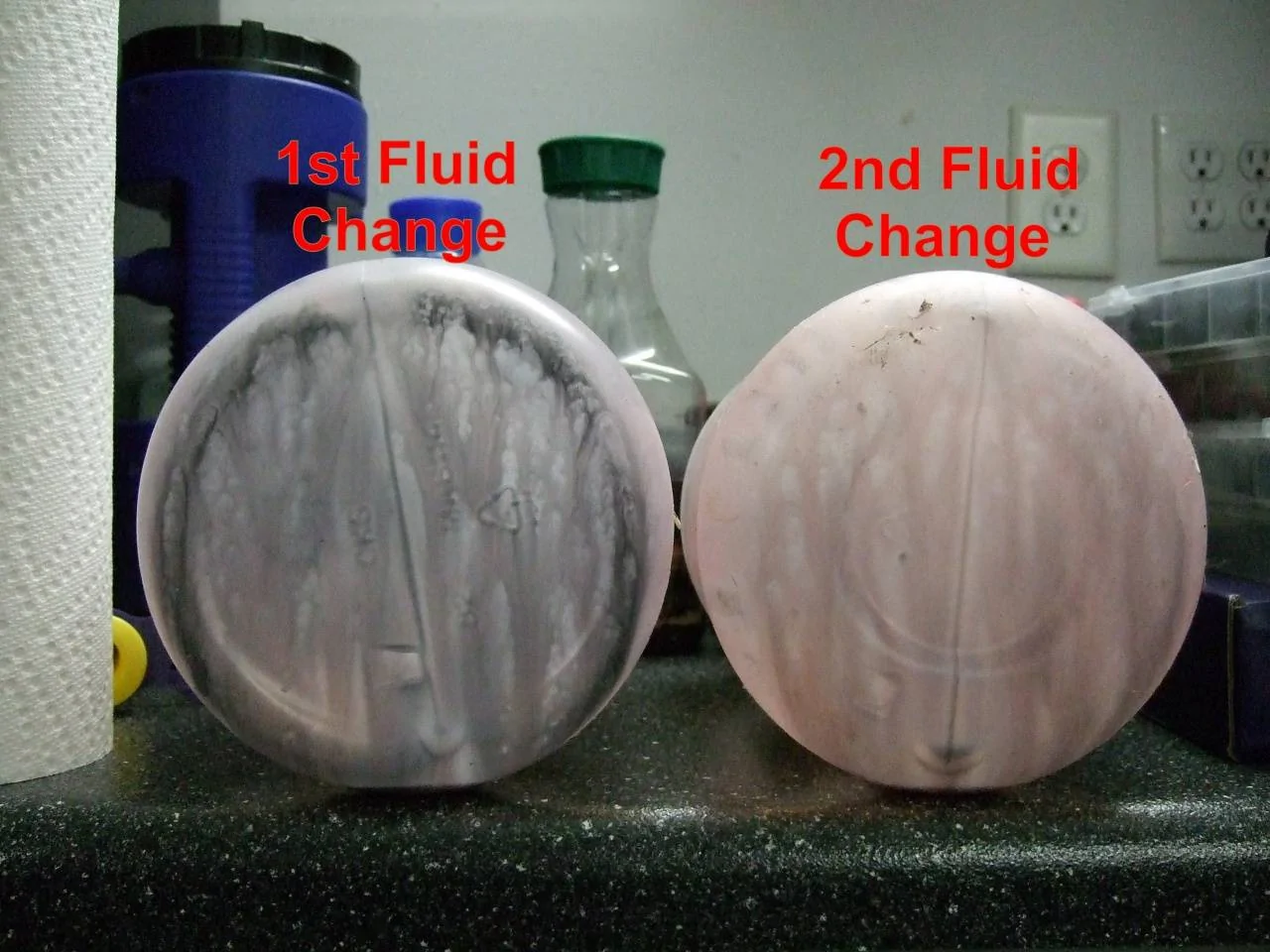

Mine was black as coal at 18K Miles. Take a good close look at the residue in the bottom of the first jug. I suspect it is clutch material.
It shouldn't be surprising that the transmission will create the greatest amount of particulate matter as it breaks in early in its lifetime. That's why I think an early change is important.
Moreover, the particles in suspension may be too small to get caught in the filter but they still can be abrasive, particularly in the workings of the valve body.
And they never stop shedding particles.
