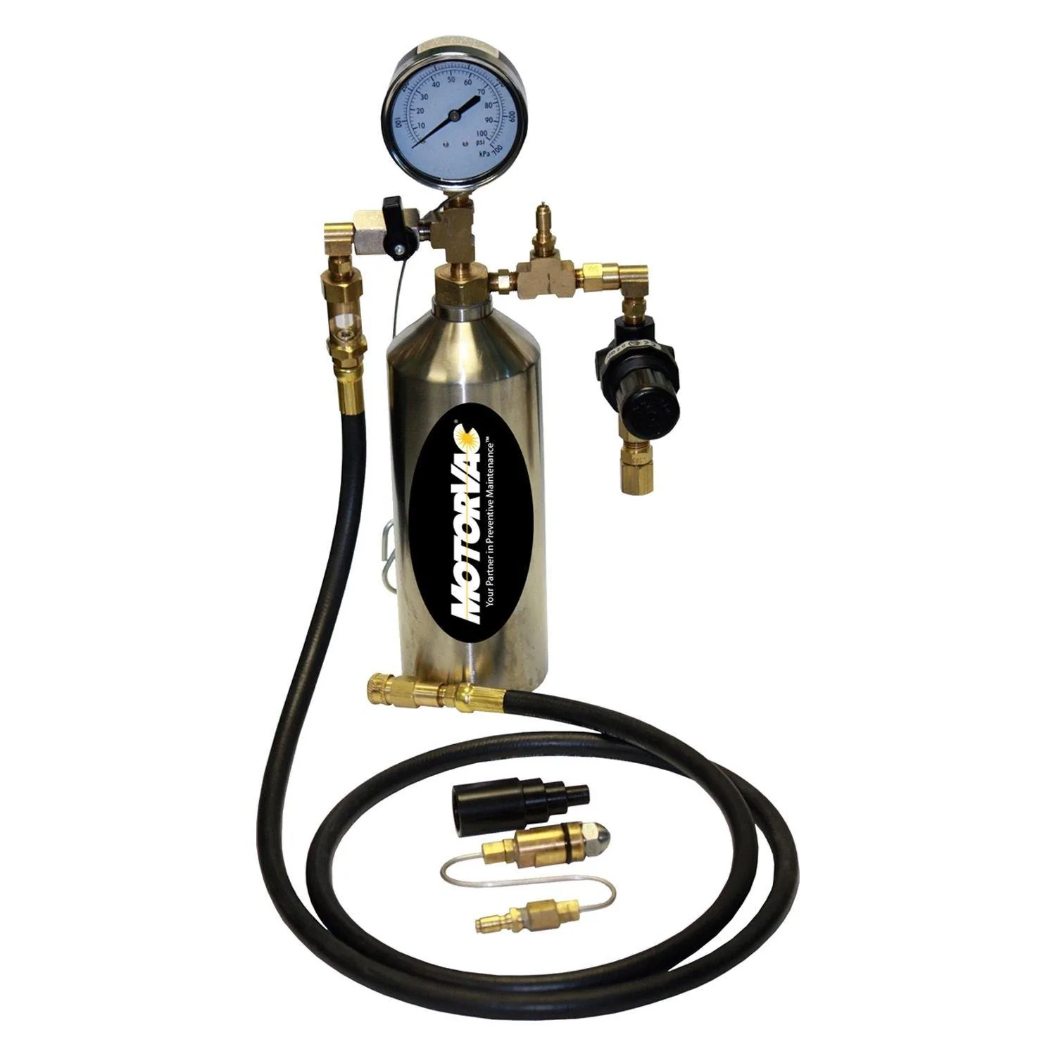

Induction cleaning should involve a chemical solvent being sprayed into the intake system with the vehicle running. The ones I've seen are a canister that is hooked up to air, it has an "S" shaped attachment that sprays in the throttle body. Prior to DI engines, I would say it was mostly a waste, but I personally believe they could be of help cleaning intake valves in trucks like ours that don't have the lower pressure port injectors spraying gas over our intake valves. I know Ford doesn't authorize such cleaning agents, I think in part because of the catalytic converter possibly suffering damage, but if the dealer is doing it, you should be good for any future warranty issues. CRC makes a product called intake valve and turbo cleaner that they say will not harm turbos, but actually clean them and is safe on converters. It's about $13-$15 a can. I used this every 15k on my F-150 and will do the same on my Ranger, already past the 15k mark, so one round has been completed already. Here's a pic of a typical induction servicing machine and the CRC:
