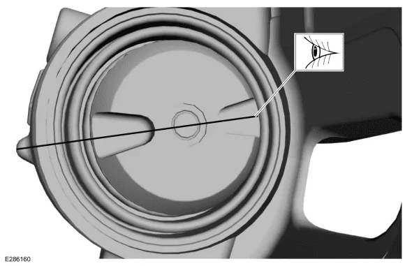

Wondering....on the back of the pads there are "dimples" one side has 2 about 2-3 inches apart the other has 1 dimple in the center.....is one for inside and one for outside?
I have not had my rears apart yet, but yes, I believe they are location specific.
But if you have the pads in the correct position and your park brake cable is not adjusted too tight.
