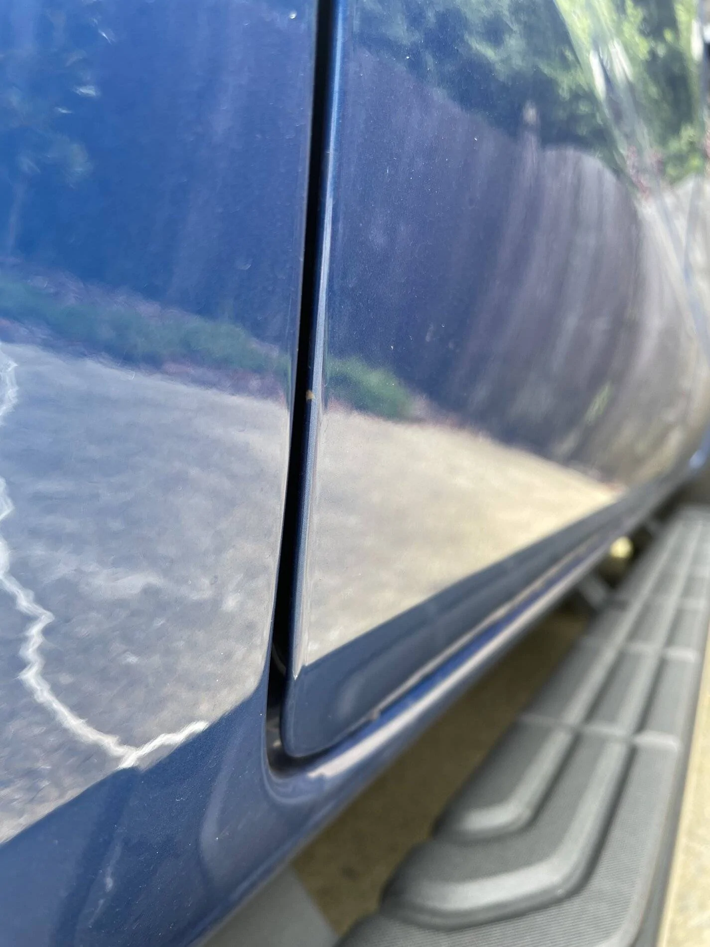

Tomorrow will be one month I've owned my 2021 Ranger. I noticed this afternoon that my driver's side rear door bottom right side does not sit flush. The passenger fine is flush and tight. I opened the door all the way and looked for anything that could be interfering but I don't see anything. I then came in and jumped on this forum to search "side door not flush" and found this thread. I wonder what the resolve would be. I've never owned a vehicle where doors did not sit flush and I've always owned Fords or Mercurys.

I wonder if this is all that needs to be done by the dealership service dept, but I'm not sure because the gap on mine is only the lower right bottom corner part of door.
Hi Val,
I am very disappointed by the final inspection of Rangers at the assembly plant. Something like this should have been caught and the vehicle sent to the repair bays for adjustment.. It is difficult with Covid but not an excuse to ship maladjusted doors. I recommend having the dealer body shop do the work.... I also think you might like to file a formal complaint with Ford Customer Care...more complaints received can put the plant manager on the hot seat to improve delivery quality.

I sure will file a complaint now that you mention it. I will be sure to give the vehicle VIN.
I'm hoping the door just needs a minor adjustment. I'm a bit nervous at the idea of having them fool with it though I admit, from past experiences elsewhere where the vehicle came back with other (although) minor damages or blemishes while in the shop's care.

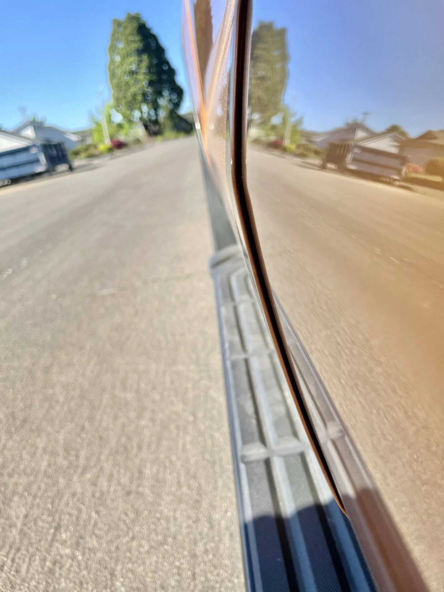

My drivers side door is like this and it drives me crazy. I can hear wind and road noise pretty bad.
my truck is a 2019 with 23,000 miles.
would this be covered under warranty to fix this?

yes!

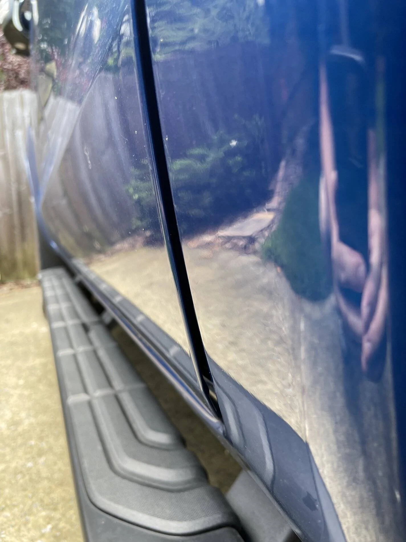

My left rear door has the same issue: the rear bottom corner protruding out a bit. The right rear door is perfectly aligned and flush all around.
Methinks the folks working the left door attachment / alignment station on the production line need a stern talking to.
Additionally, my drivers door (left front) latch is rubbing the strike bar when closing. This is a hinge adjustment issue to correct door sag. If you just simply drop the strike bar, the door will be out of alignment when closed.
Both of these issues were straight off the dealer lot.

If anyone was wondering if new trucks are still being produced with these wonky doors I can confirm. Purchased a brand new 2021 Velocity Blue XLT crew cab FX2 on May 31st. Noticed last weekend my drivers side front door was sticking out like it wasn’t closed all the way. Passenger side was lined up fine.
Called the dealer where I bought it (very small Ford dealer) and they were booked up until June 25th. Called a dealer one county east of me and they aren’t even taking appointments. Finally called a dealer in Atlanta that could get it in last Tuesday.
They had to send Ford pictures of the door and how bad it was protruding. Ford ok’d repair by the dealers body shop. It’s been there since Wednesday. Called the body shop to get an update yesterday. They said they couldn’t get it lined up and we’re ordering a whole new door. Have no idea how long it’ll take.
So as of now the body shop has had possession of the truck almost as long as I have. 492 miles in and not exactly thrilled. Oh, and no loaner car so I’m currently relying on my 20 year old son to take me to work in the morning and my wife to pick me up in the evening. So that’s great.
