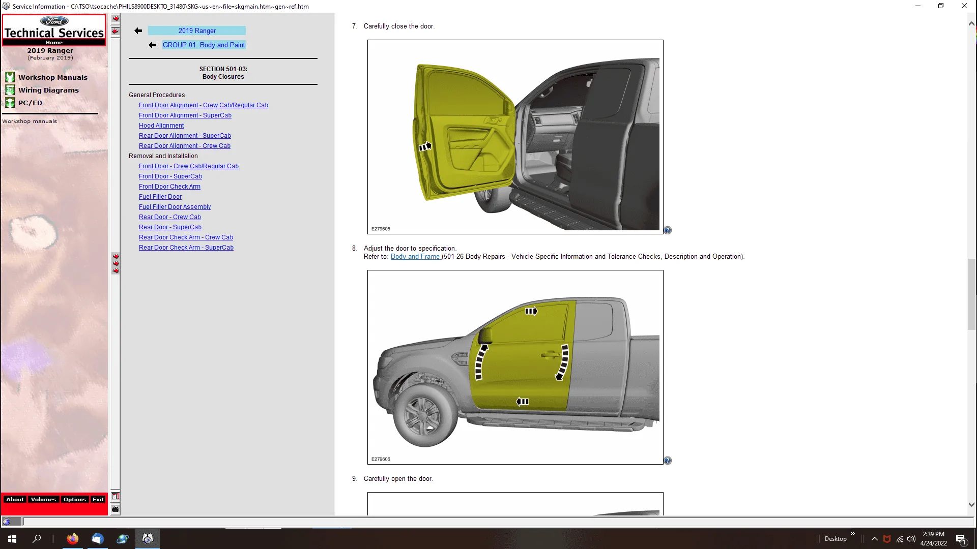

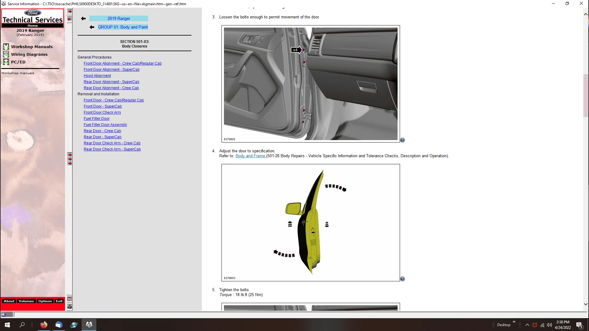

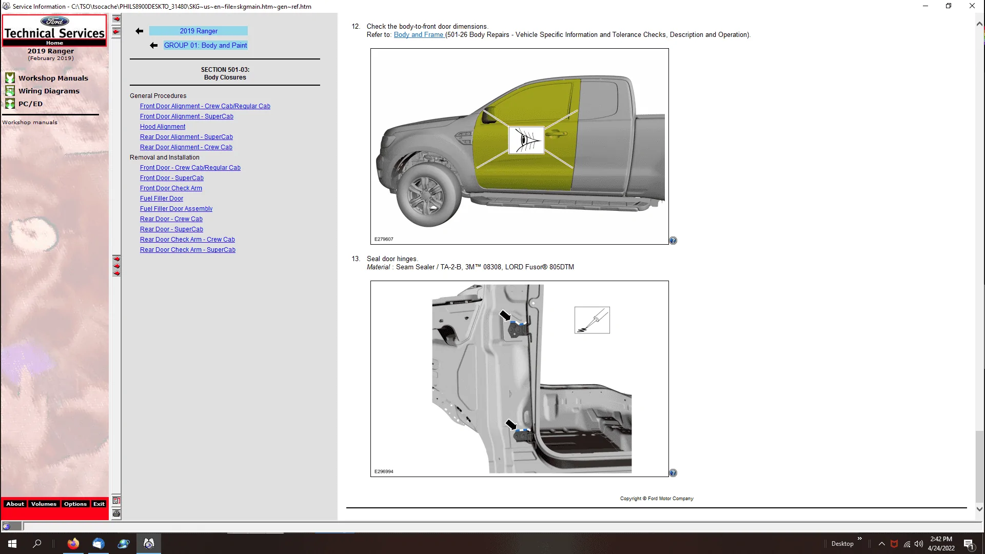

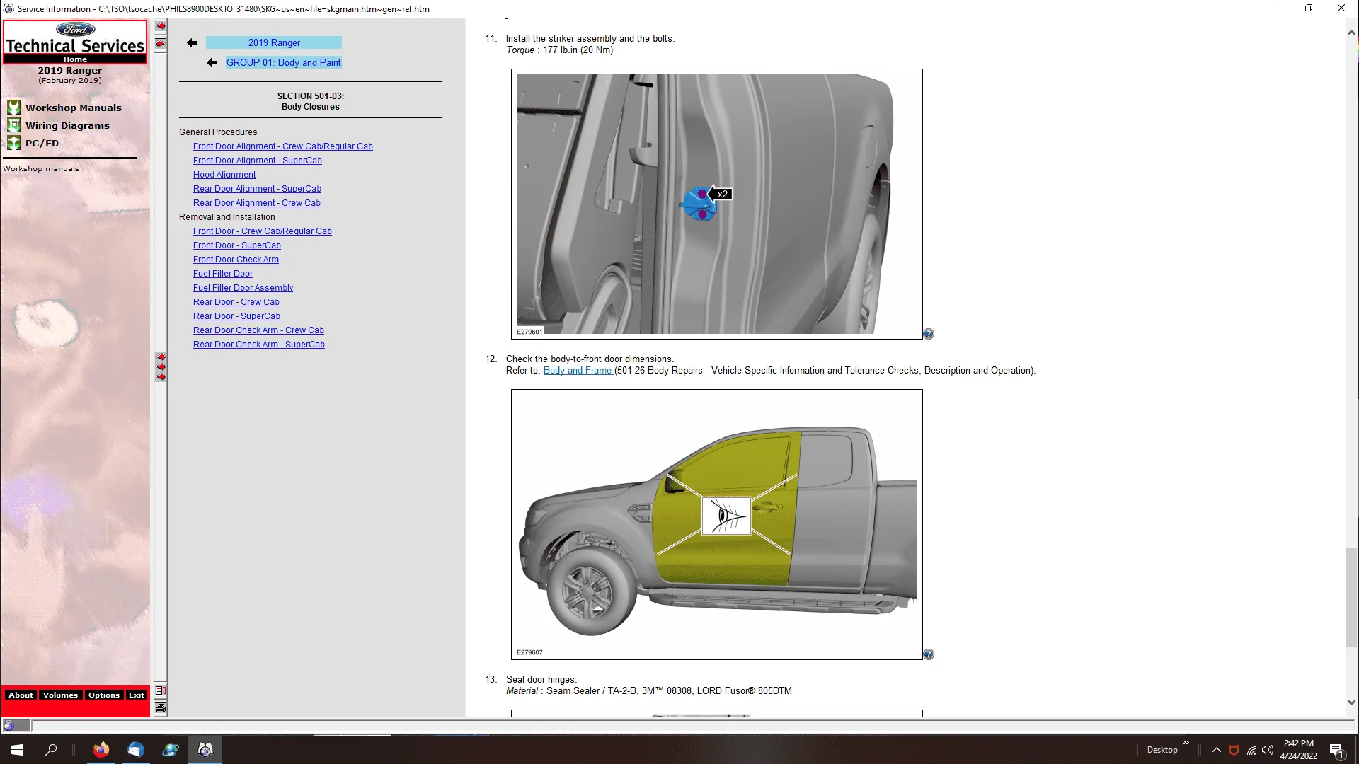

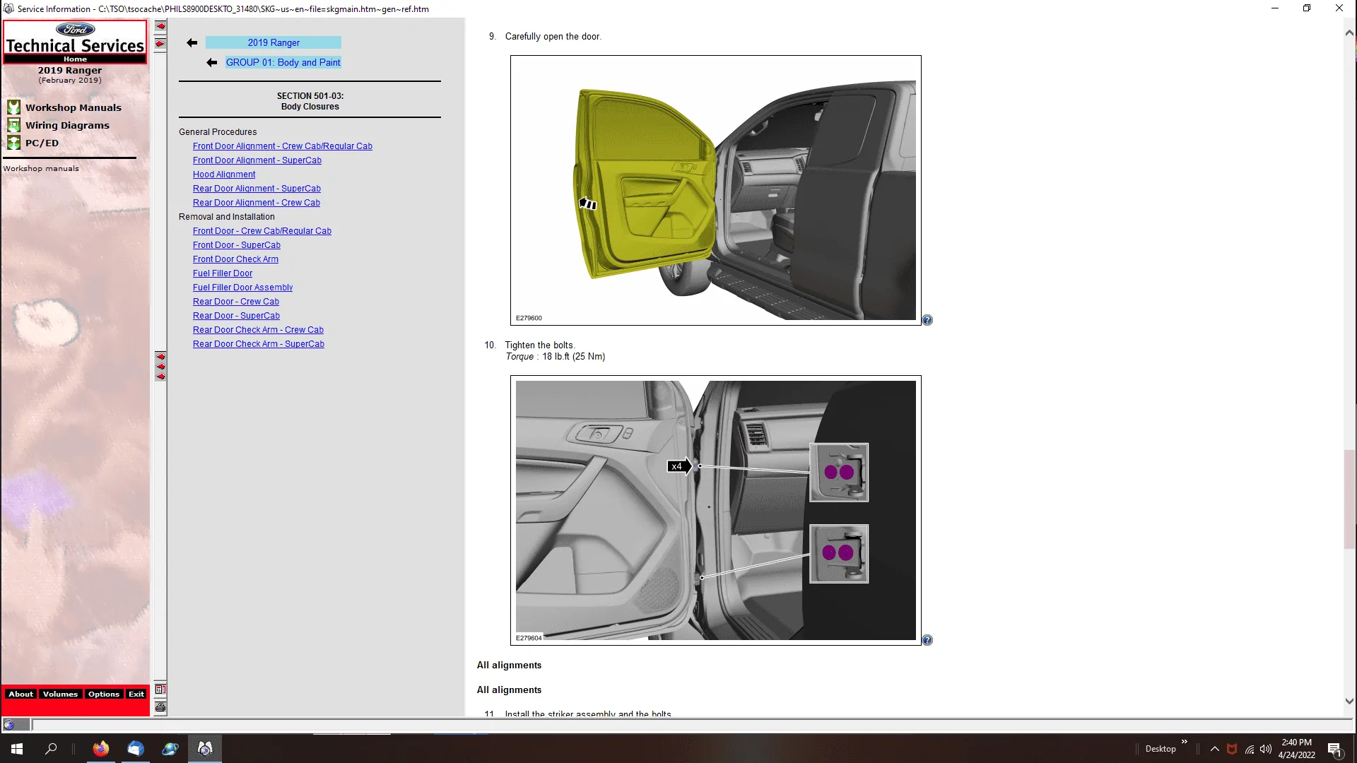

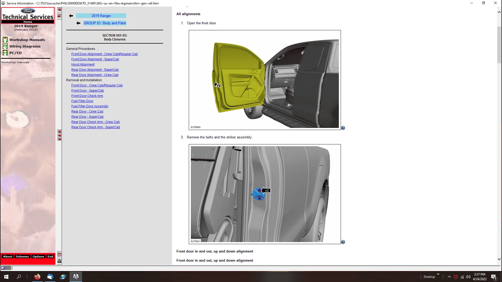

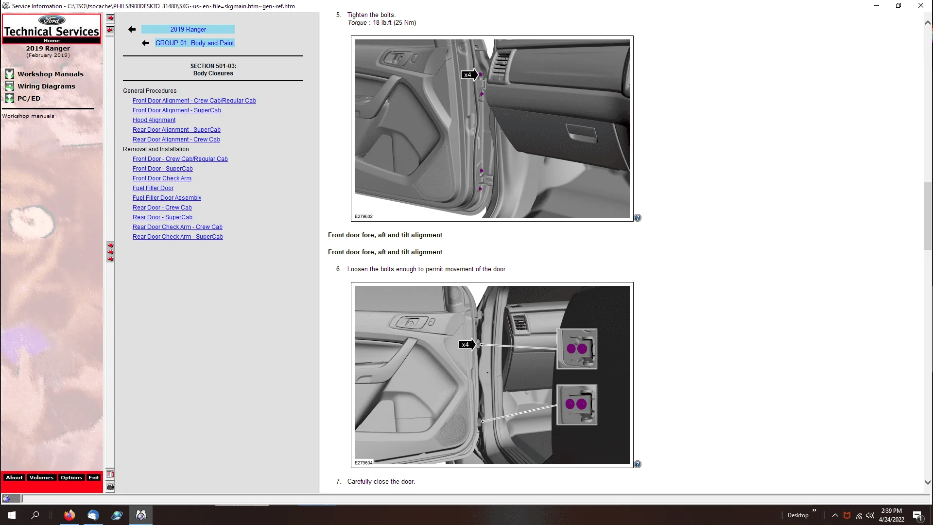

Hi WMC,
It should have some adjustment capability. From the 2019 shop manual for Supercab door.
Hope this helps....

Thanks for help. It does look like the upper portion of the door, nearest the handle, sticks out slightly and is not quite flush when closed. I am due for an oil change soon and am considering having the dealership look at it. Phil, you seem very knowledgable about Ford. Do you know if body panel fitment issues like this are typically a warranty item? I am just within the 3/36 warranty and I know the history of the truck, this definitely isn't a result of a crash/damage.
Hi WMC,
Body panel fitment is part of the bumper to bumper 3/36 Warranty...if the dealer agrees. If you disagree with the dealer, open up a formal complaint with Ford Customer Care to document it within the 3/36... It is quite rare for a misaligned closure, aka door, Hood, tailgate gets out of the plant misaligned, but it does happen... Dealer body shops should be able to adjust.
