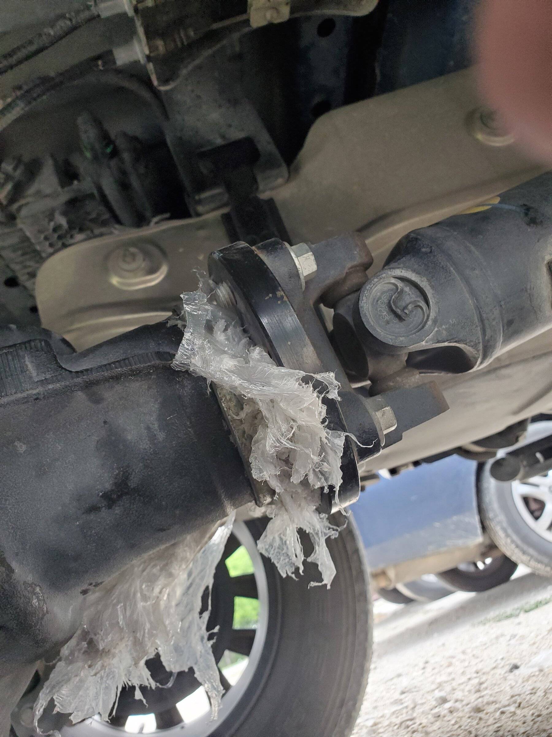

This morning on my way to work, I ran over a huge wad of stretch wrap. It ended up wrapped around the driveshaft u-joint at the rear diff. I was able to pull the excess plastic out but now my pinion seal is leaking. Is this something I can replace without having to replace the crush washer and/or completely rebuild the ring and pinion ?

If so: Measure the turning torque with an inch pound torque wrench before disassembly. Then once you’ve replaced your seal, tighten that nut until you achieve that same turning torque. If you go too far you will need to replace the sleeve.

Dang.. Reminds me of hay wrapping on drive shafts on the farm.. That will be a job the pinion will need to be completely removed to replace the seal. The first time I "used my skid plate" was from highway debris.

Easy fix and plenty of examples on YouTube if you are mechanically inclined.
All you have to do is remove bolts holding driveshaft to pinion flange, remove large nut holding pinion flange on, pull flange, pull seal, replace seal and reassemble. You'll need some loctite for the pinion nut threads. Like others said, if you over tighten it or under tighten it, then you create more work for yourself.

So, I ended up taking the truck to the dealer. I'm 99% sure I could have done it myself but without the specific tools on hand, it was just cheaper to let the dealer do it. That way, if they muff it up, they can repair it.
