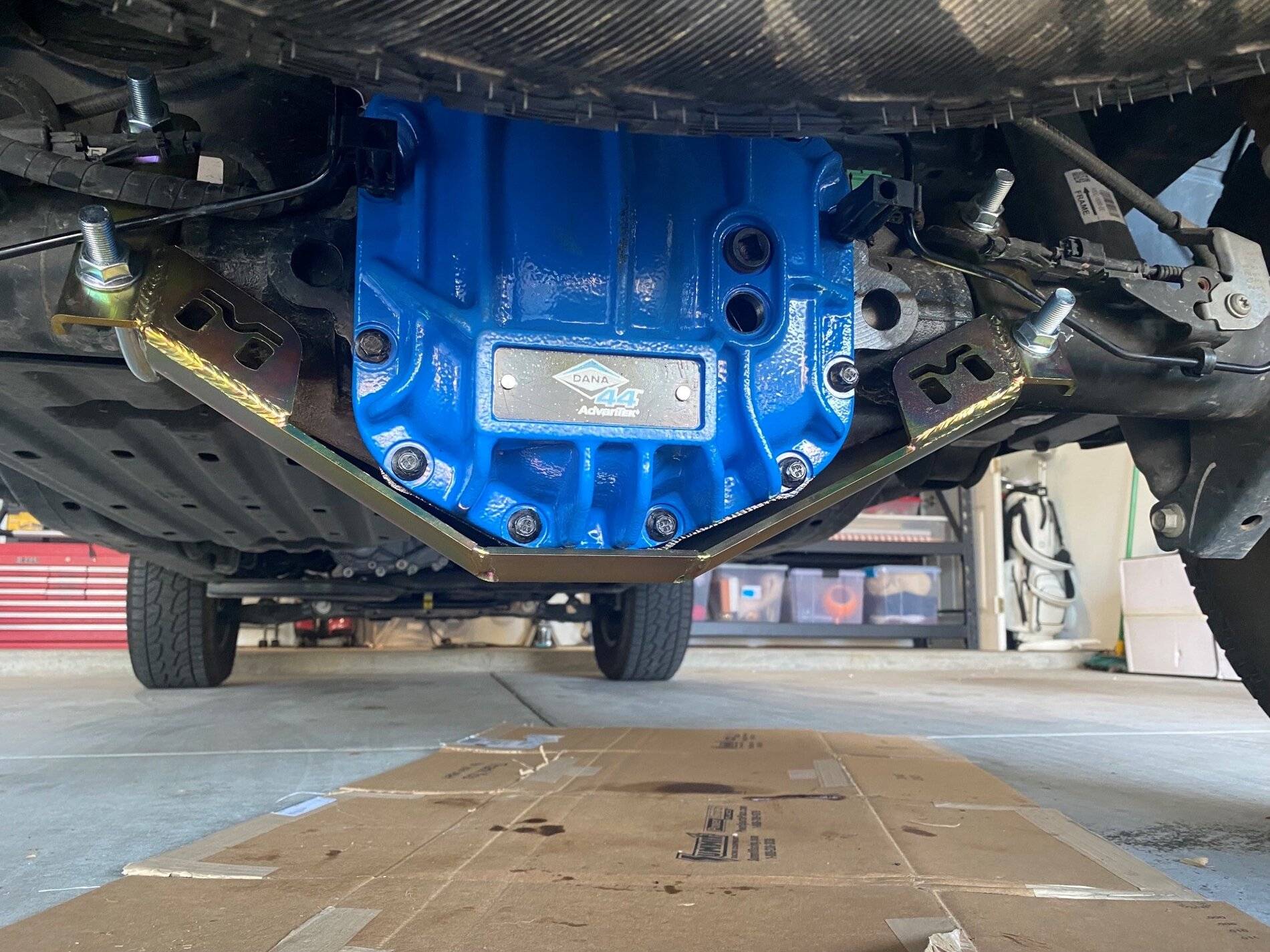

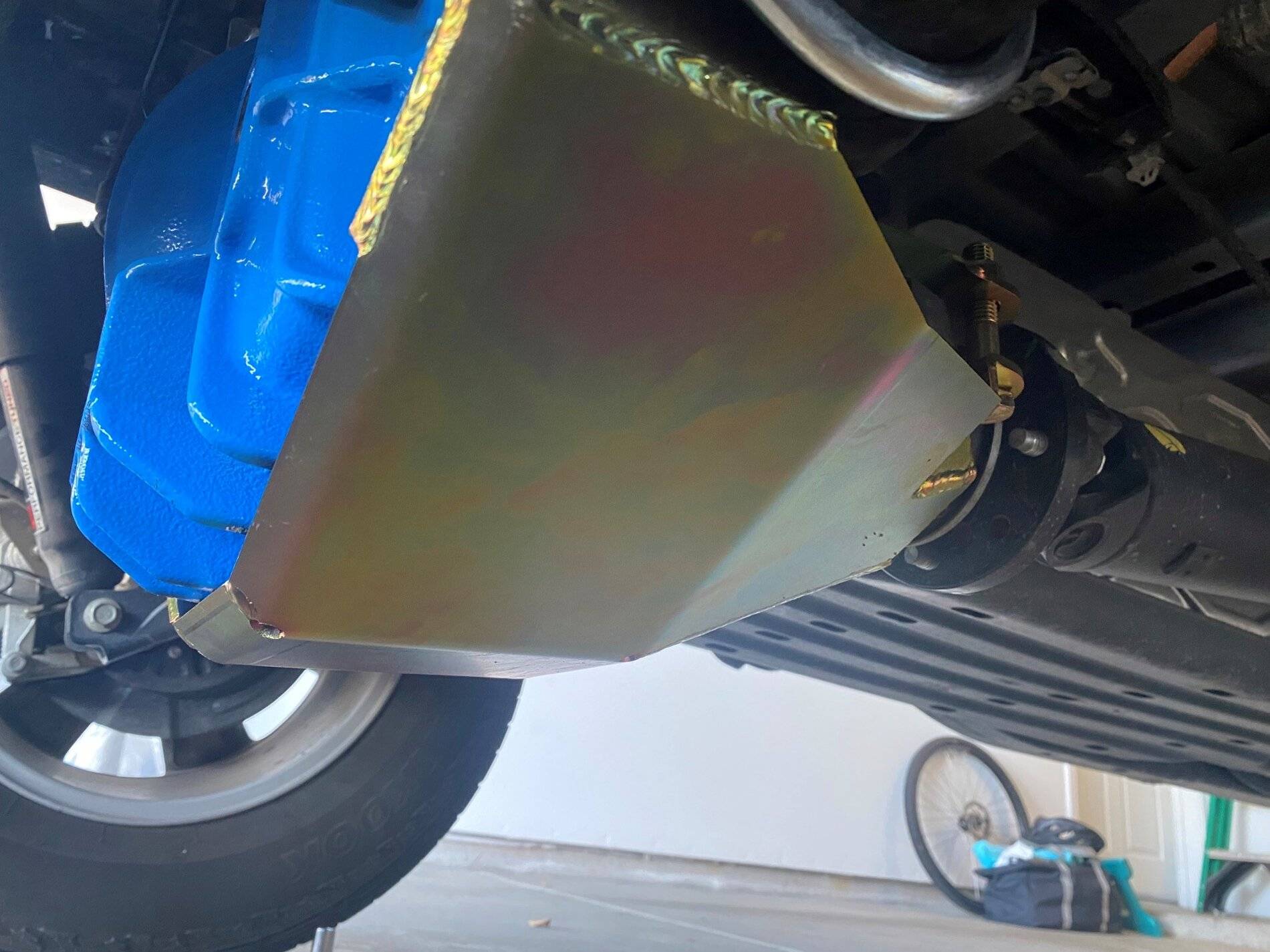

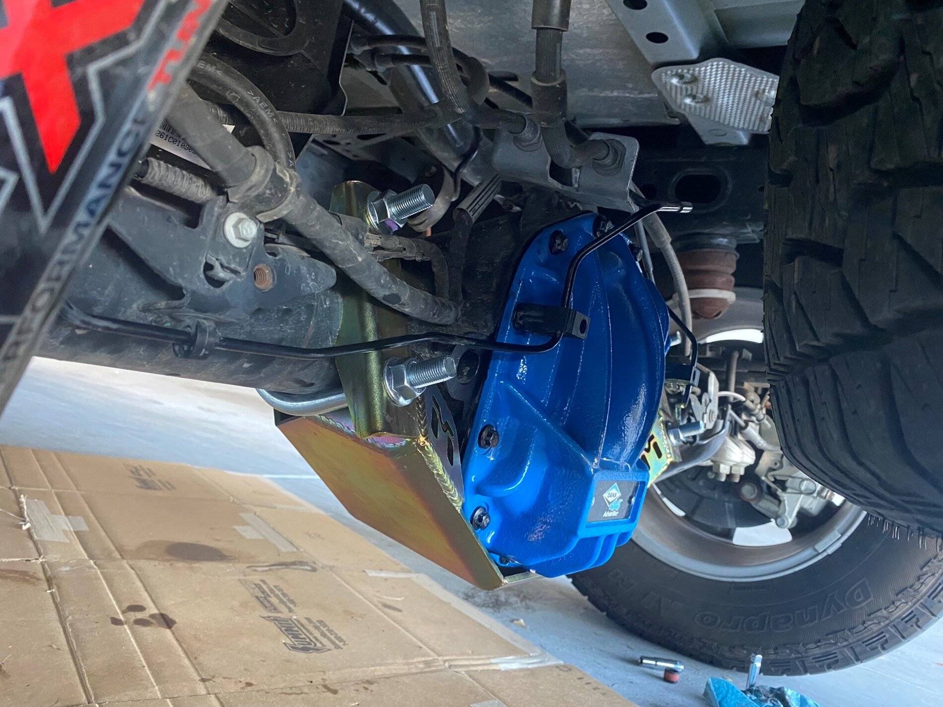

Can you drill a hole in the skid to access the drain plug?
onobeka
Jan 20, 2021
386
1,134
Romania
2018 Ford ranger 2.2 European model

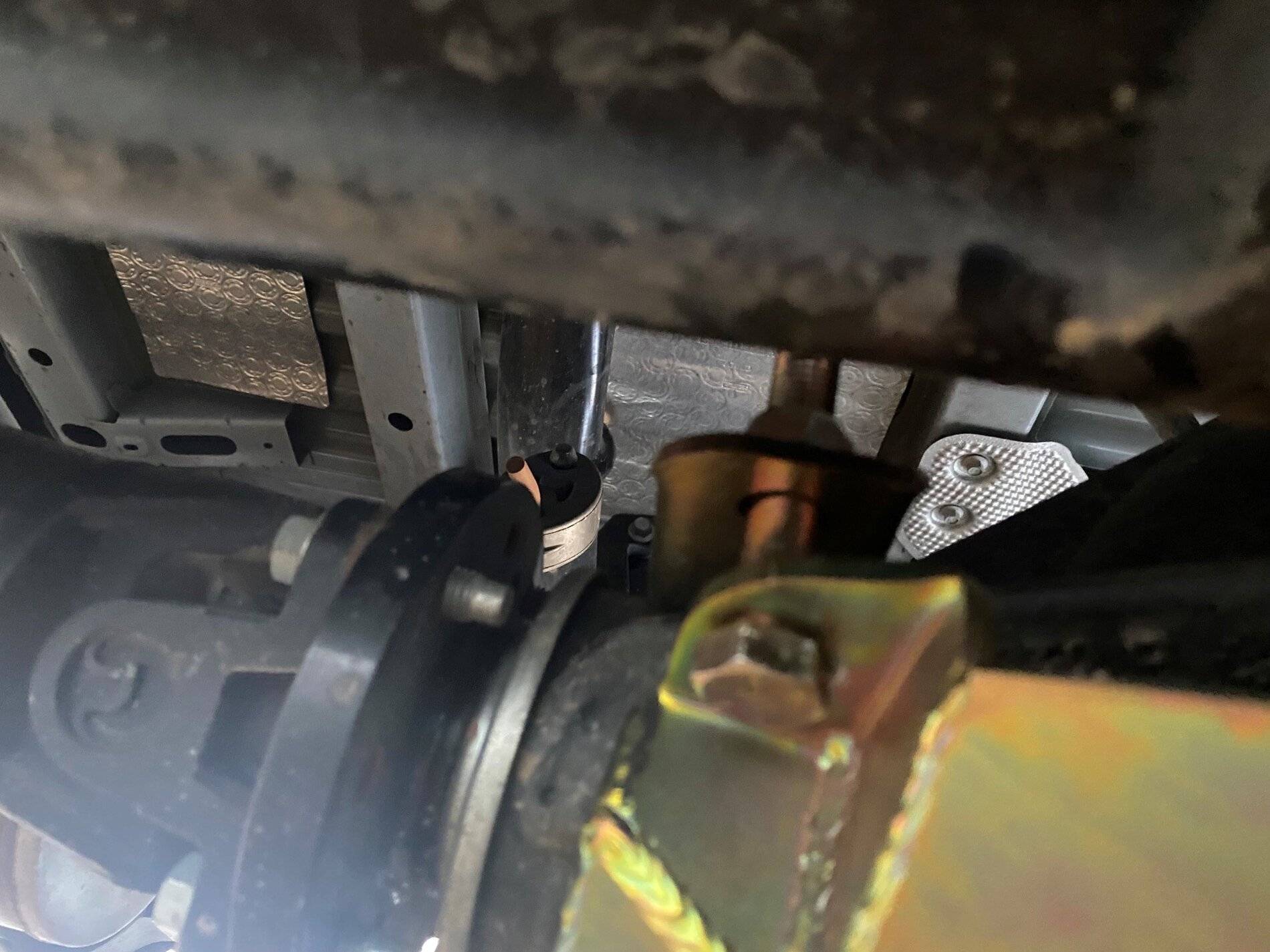

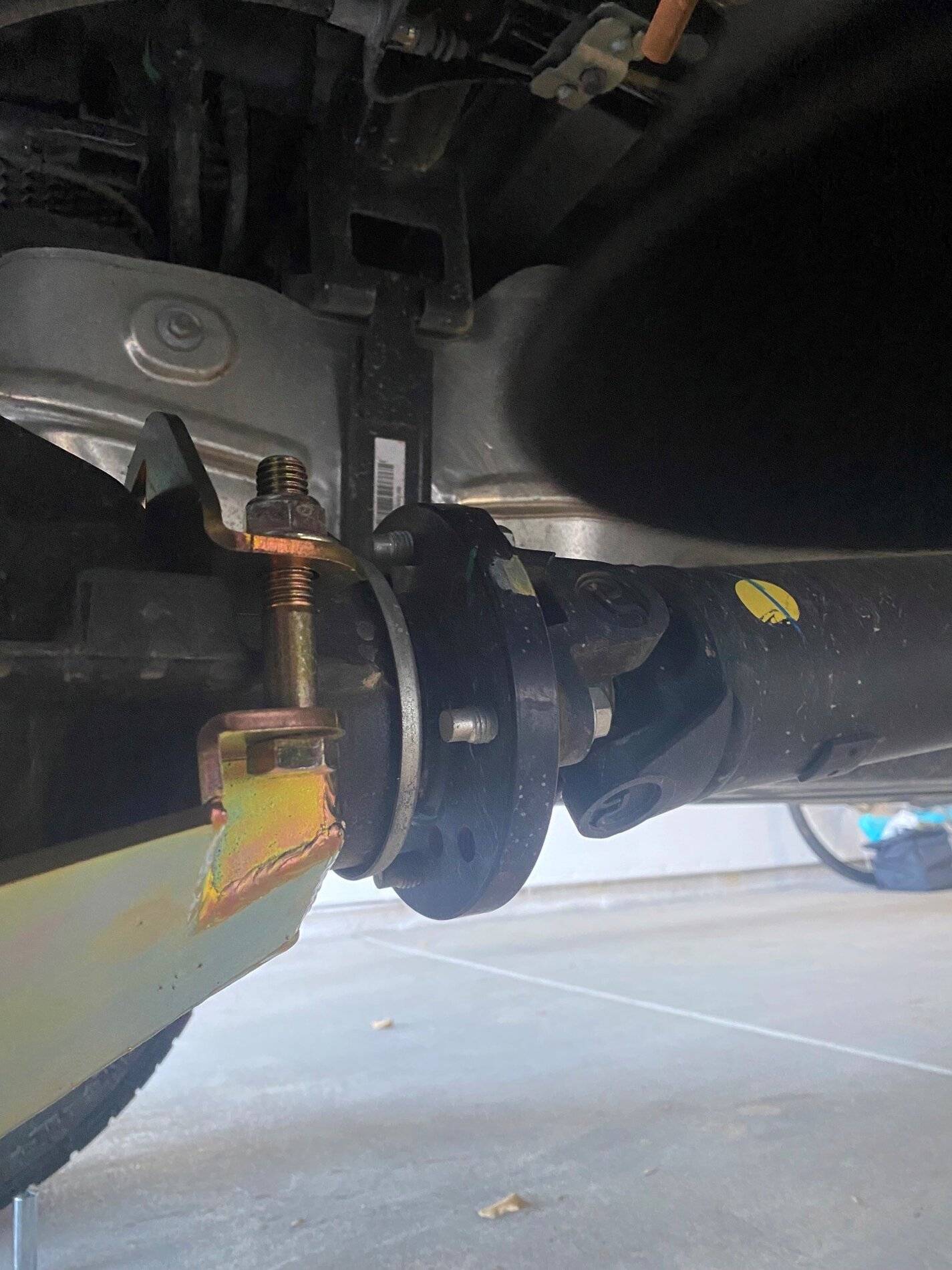

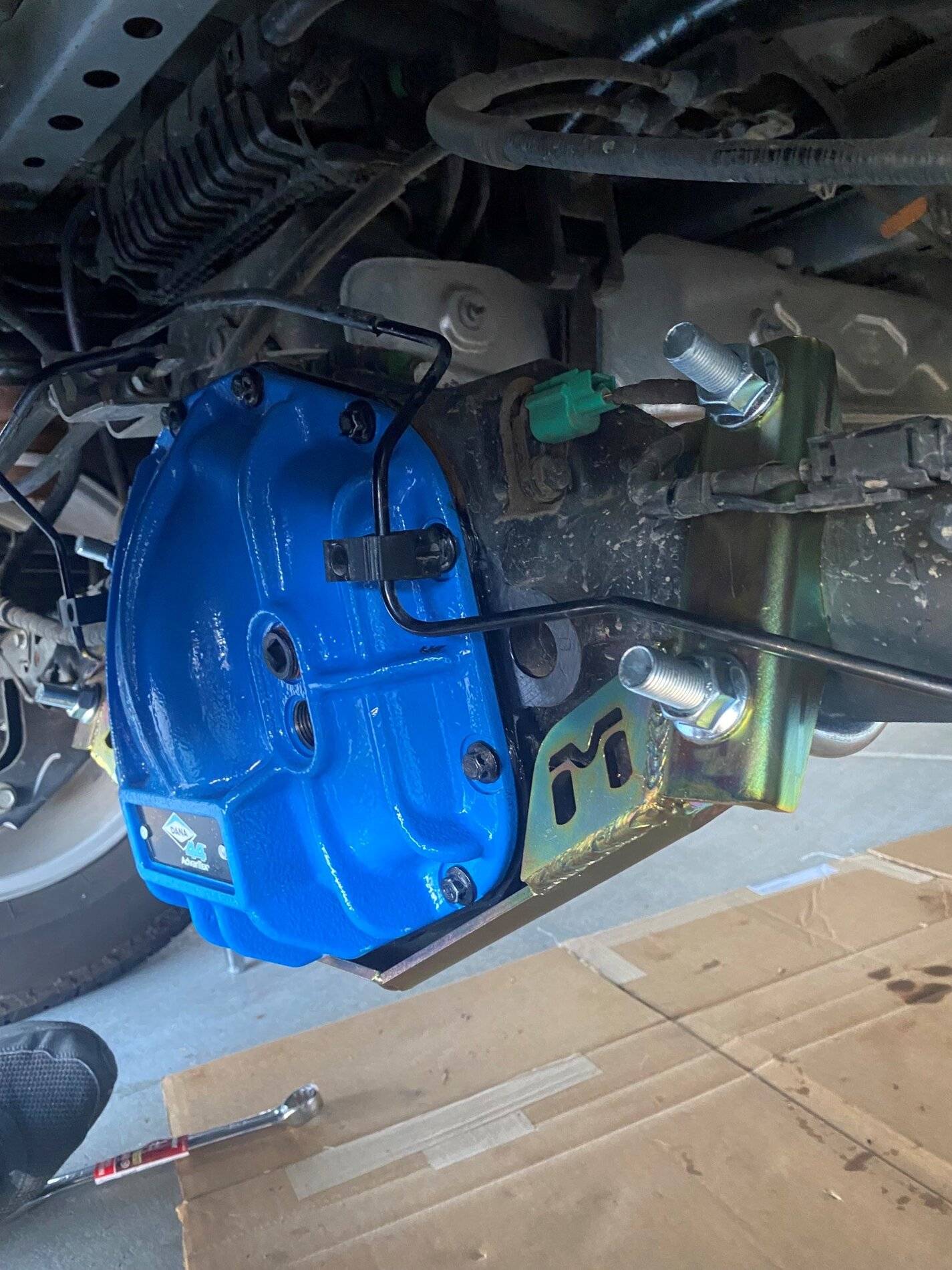

The drain is beyond drilling, it’s massive, 50mm in diameter. On my project I’ve cut out a square with the angle grinder. At least I do not have the proper tool for the job on 5mm mild steel.
onobeka
Jan 20, 2021
386
1,134
Romania
@onobeka Ill crawl under there this weekend and shine a flashlight to see if I can tell, need to check the bolts any ways to make sure they are still torqued properly. Only downside I see with my setup is there is no provision for accessing the drain plug.
Thank you, I made progress today. I’ve decided it has to sit flush against the bottom of the axle, as that is also a jacking point. It’s stronger that way anyway, yet rust will be an issue no matter the prep and rust protection on both faces!
