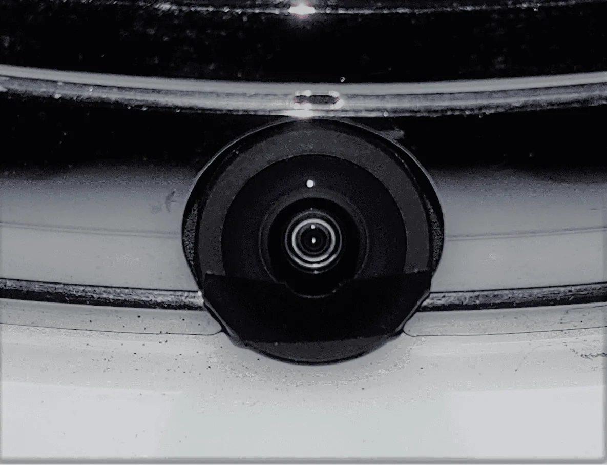

I took the black tape in a different direction - applied to the bottom of the camera lense. I will post pics after dark today. I gauged off my trailer hitch, adjusted tape until I could just see it. But the side need it block more, need put a notch in the middle. Not sure why they aimed the camera to show the lic plate and the entire bumper step.

I added some black tape across the bottom of my camera, found I needed to scallop out a section around the camera to get the sides high enough to cover the lic plate lights. Its a "duct tape" solution I know but it does eliminate the glare.

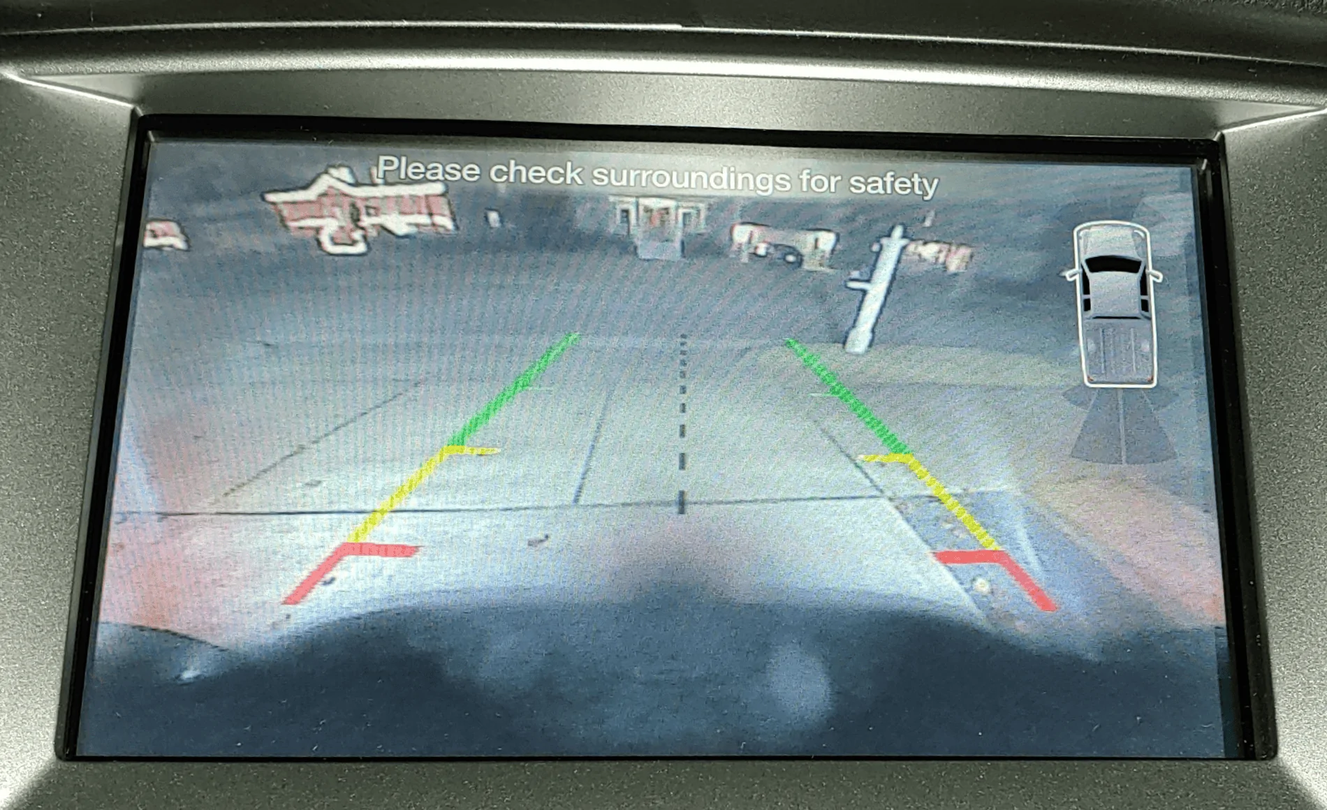

black tape across bottom of lens. Align with truck OFF, but ign ON and put gear shift in rev.

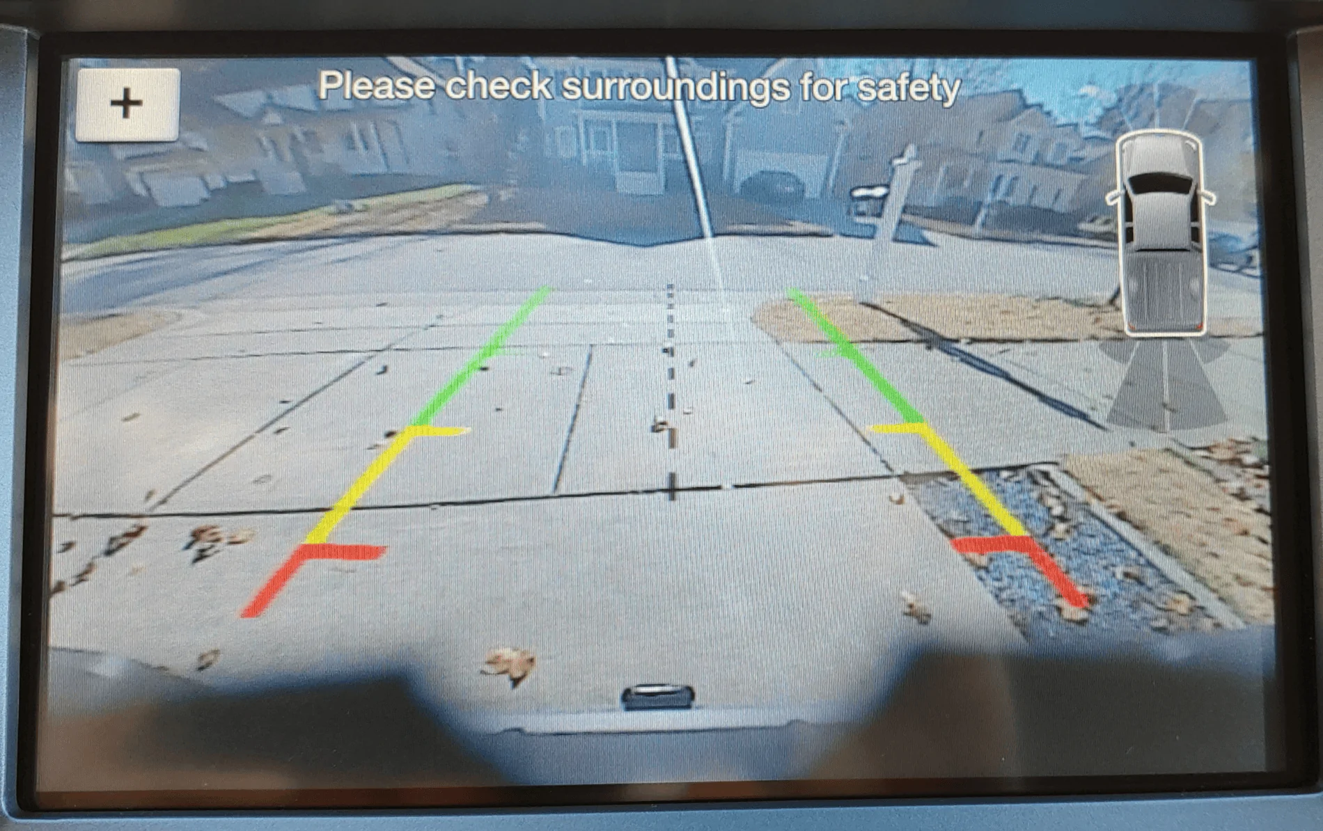

day time shot of results. For the most part I can see the back edge of my bumper and the recvr hitch.

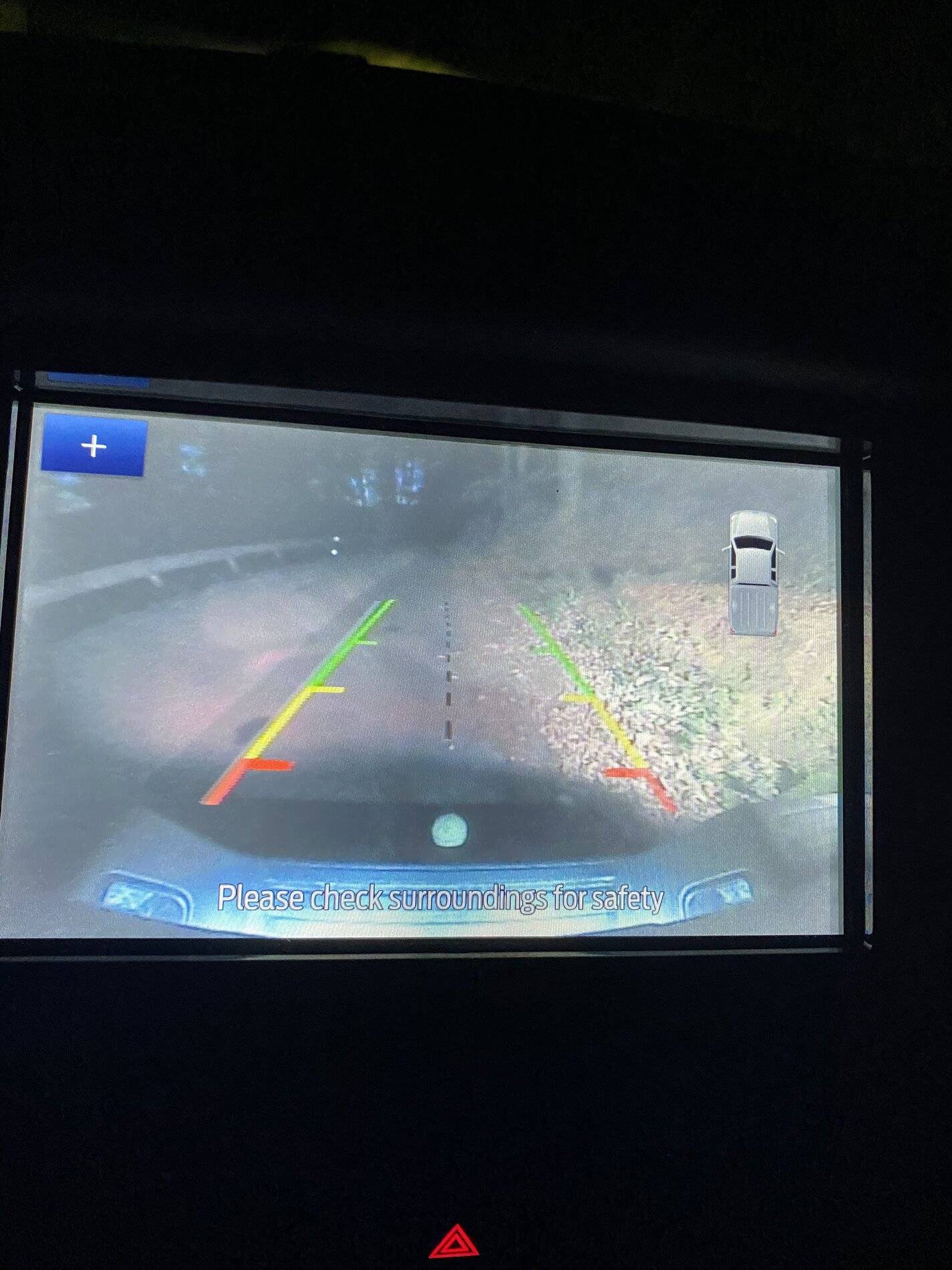

night shot - I think I forgot to wipe! Will try for a better image tonight.

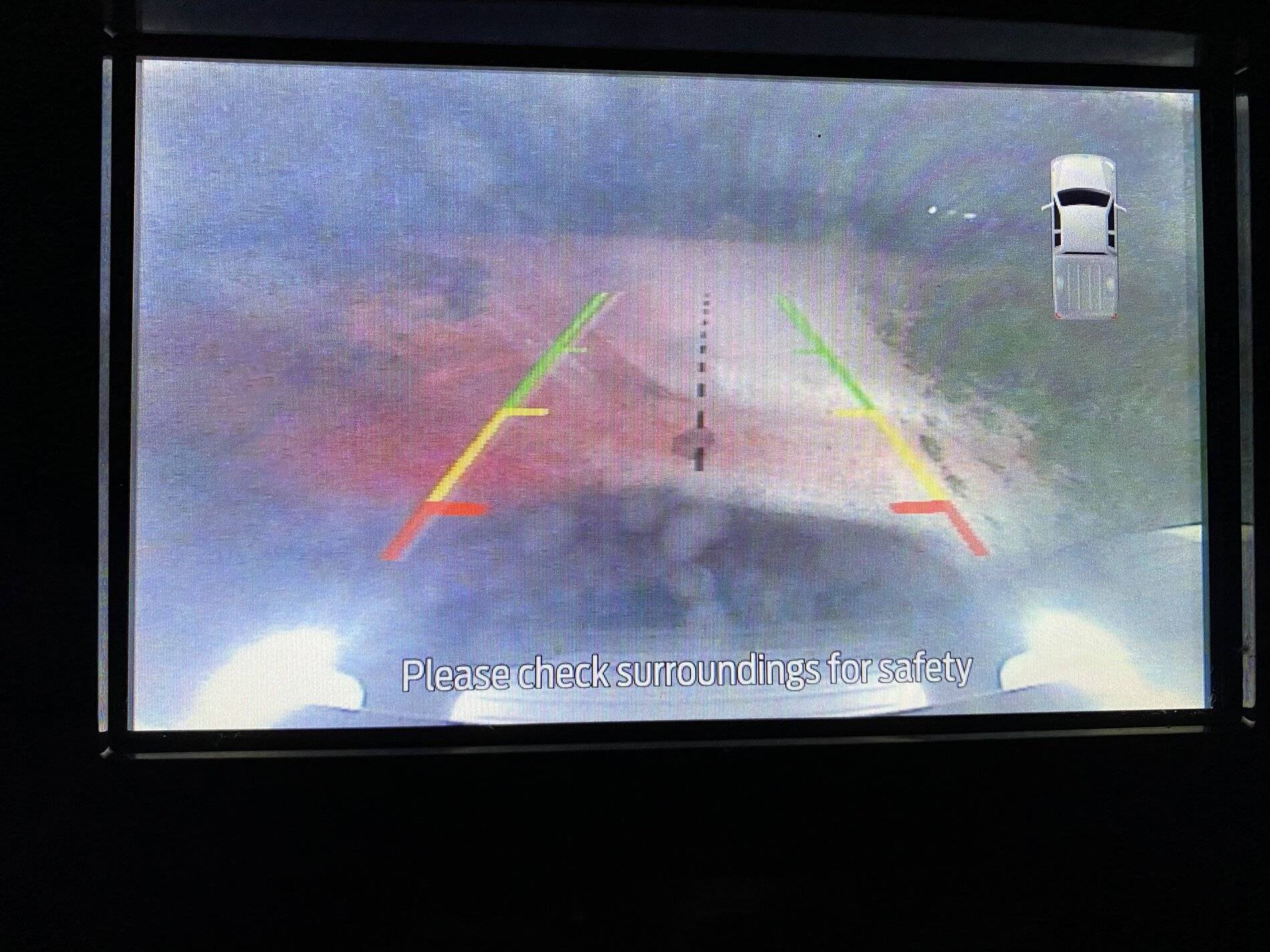

Searched all over forum to find an answer and really barely found a mention.
What have you folks done to help obscure or whatever, to keep the license plate lights from washing out the camera while backing up at night? Really even more a headache when raining or frosty.
Cannot believe Ford didn’t think about this. Never had is prob with other vehicles I had over the years.
I tried tinting half of the lens, no good.
Thoughts? Much appreciated...
