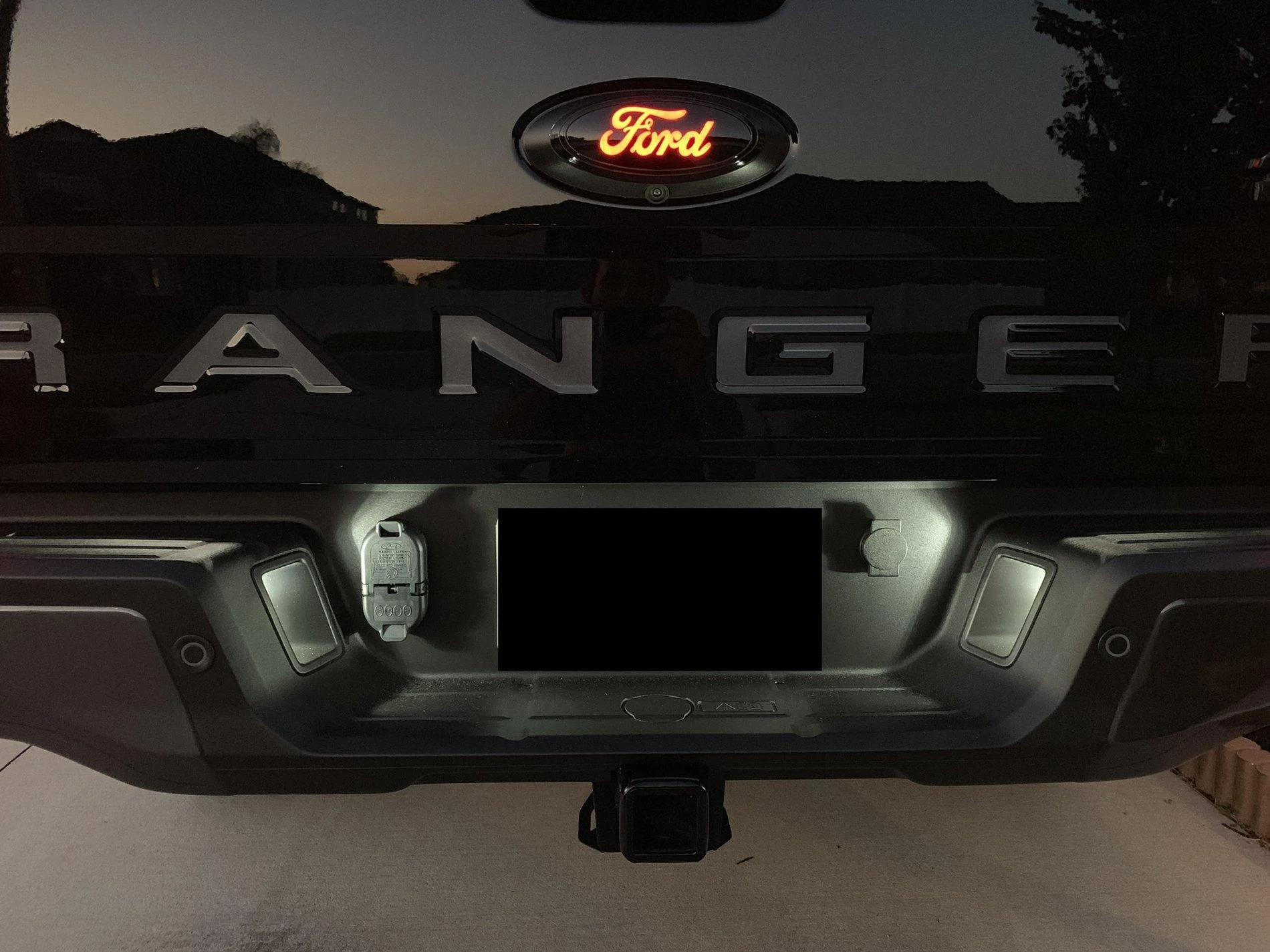

Yes they are 194 bulbs.
I swapped every bulb that wasn't LED to LED when I got my Ranger. I cannot stand non LED...Especially since with the 302A package, the entire rear tail lights are LED.

Really sharp looking tailgate lettering, where you got them from?

Where did you get the light up ford badge at?
