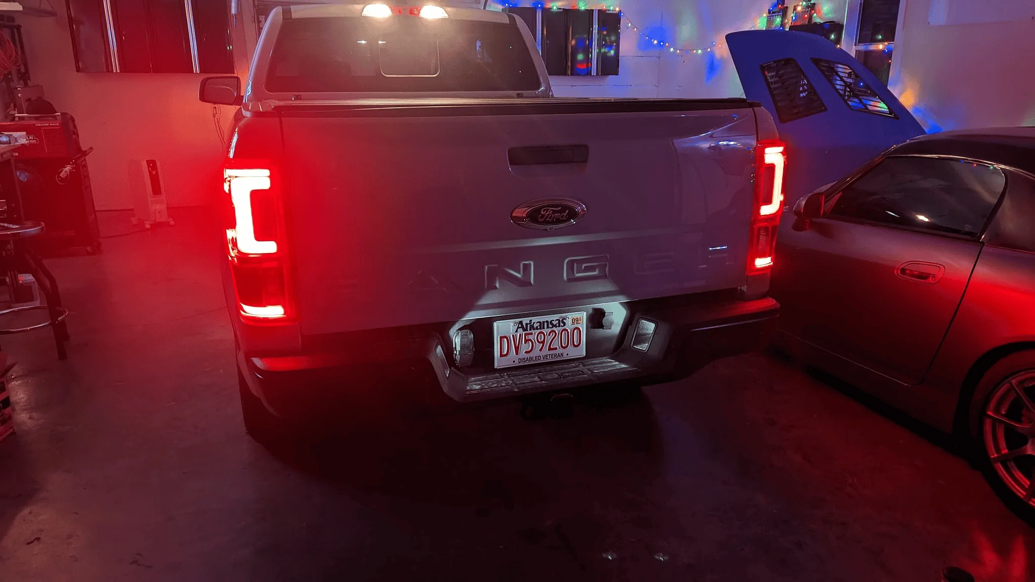

I used some Amazon bulbs I had laying around from using them in other vehicles and they were great... Pretty bright too. Eventually, they started flickering, so now I have swapped out for some Diode Dynamics and will see if the flicker comes back.
These are the Diode Dynamics bulbs (HP3, I believe) installed. Not particularly bright, but the color is good. This picture really shows why we have such bad glare on the camera... No doubt, an engineer did that.
