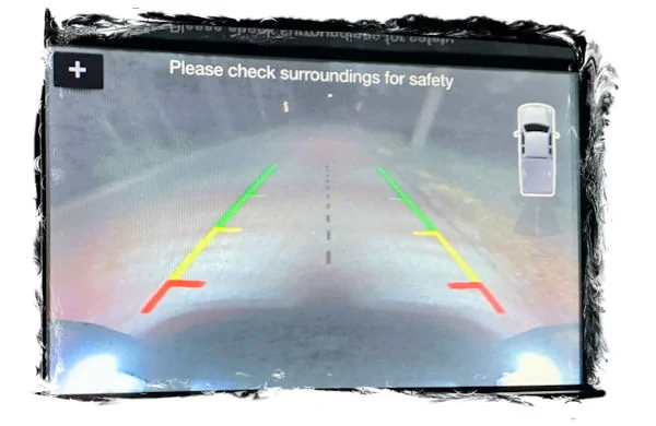

As requested, a crappy shot of the rear cam with new bulbs. The picture looks like hell. In person, the cam is not quite as bad. Sorry I never got a shot before the switch over. Not perfect but was a lot worse.

Do you have gunk on your lens? Mine doesn't look that bad and I haven't done anything to it.
"Picture looks like hell"? That's probably the best night shot I've seen from the rear camera! Looks like you found a good solution! One I'll have to look into. But probably not worth it for me until winter is over since the camera is always covered in snow, salt, grime, etc. after every little jaunt anyways.
Nope, clean as a whistle. Day time its crystal clear. Night time, if in a fairly well lit area, also fine. Just when its pitch dark.... iphone picture is not depicting it correctly. Its not as bad as the photo. But you can see how bright the lights still are and they are much better than factory.

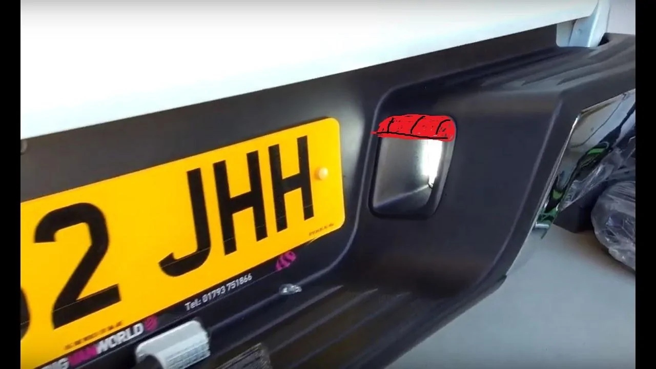

so instead of trying to change the camera and lens i think a better solution would be some sort of cover or hood for the lights so that their beams didnt shine into the camera.
something like this that would allow light to still shine on the plates but not shine up towards the camera.
Agree!
Someone 3D print and take my money. Black please.

Agree!
actually... the company i work for now does stuff like this all the time. lemme see if i can talk my bosses into coming up with something and see what it would cost.
agree on black though. need to be stealthy
