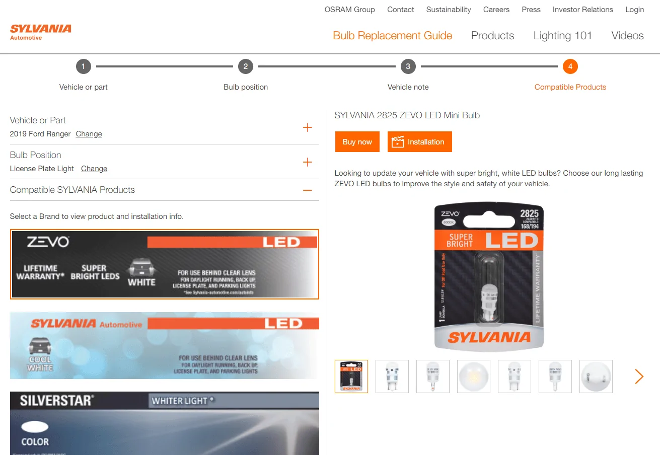

https://www.sylvania-automotive.com/apps/vlrg-us/Vlrg/
They have 3 offerings the ZEVO is the brightest. You might be interested in the first or second tier to have less light and less glare.

- Finally, used the bulbs above but the medium grade. They are frosted. I took off all tapes and tints and just used bulbs.
Eureka! Seems to have solved the problem. Plenty of light for the plates and subdued a bit for the camera. Only thing I can't test yet at night is how much rain would reflect back. Suppose to rain next few days, so shall see. New bulbs used in conjunction with my rear cube lights seems to have resolved problem for now. Neighbor wants to do the same thing on his truck because of similar issues.
If all goes well, I'll just stick with the bulbs. If not, I will add back some tinting starting on the light lens. As far as leds being super bright? Perhaps. I don't know if the first tier would have worked. Think they were out and was planning on the middle grade. So not sure if the top grade is frosted but that seems to be what really fixed it. Frosted vs Clear? @First Ford, is your top tier frosted too?
