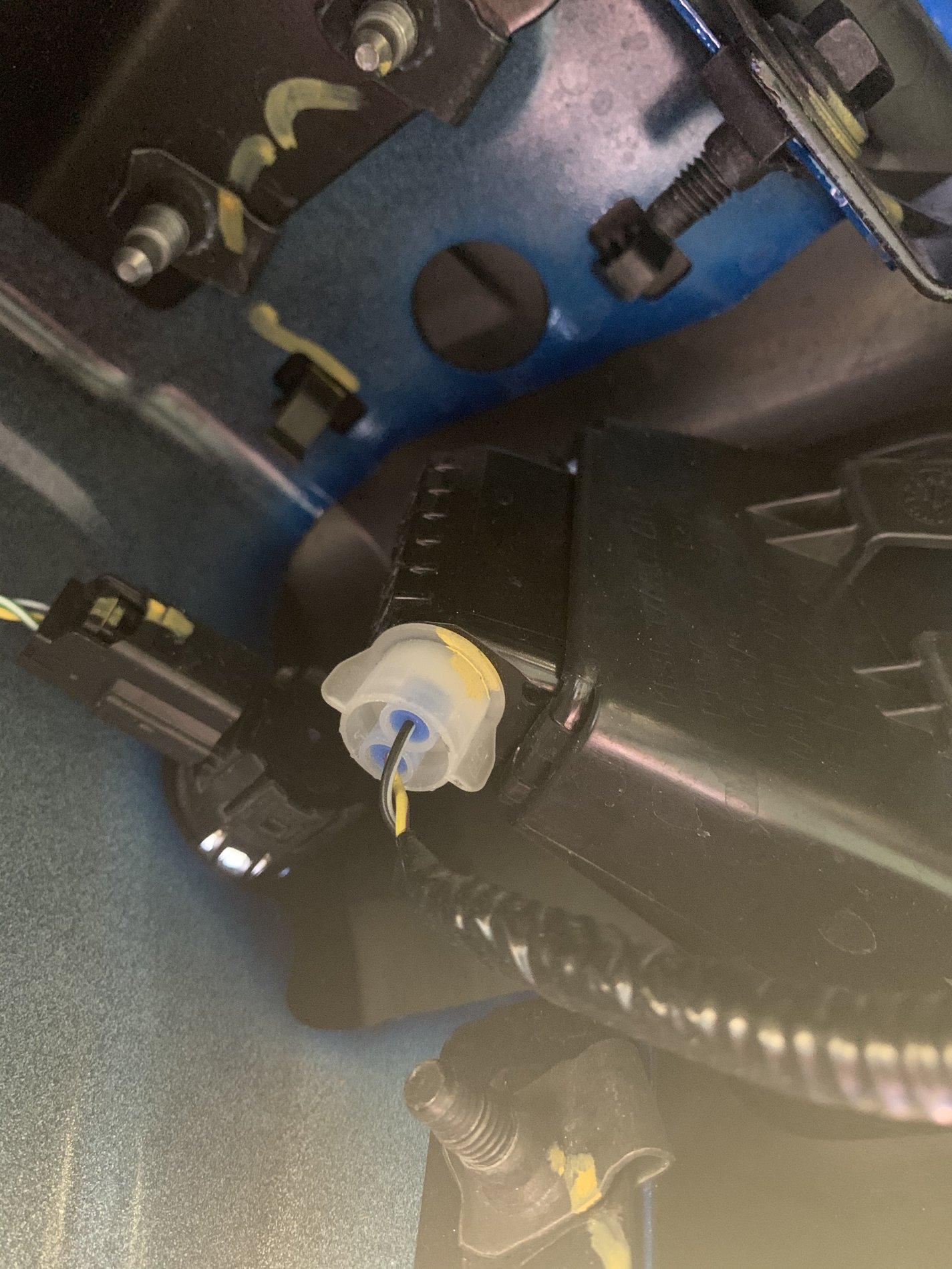

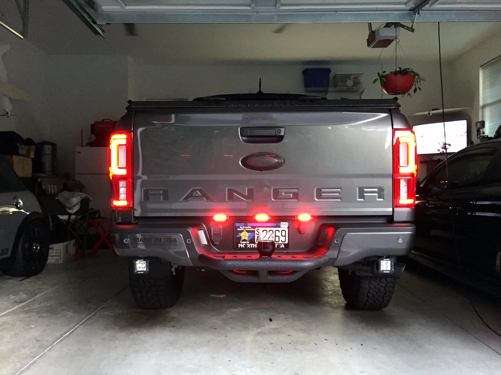

I tapped them for my custom rear marker lamps...
That looks great !

As long as you're not tapping a toaster up to them, low draw LEDs should be harmless...although I don't what you're planning:)
You do know that your bed lights would not turn on unless your marker is turned on right? The license lamps are switched to the marker lamps...

The marker lamps is the first set of lights that come on when you rotate your headlamp switch...they're the front amber bulbs inside your headlamp and the red lights at the rear...like the photo I showed in my first reply...
