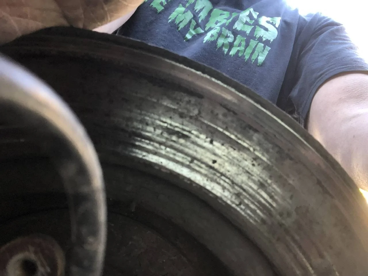

I still don’t believe that it’s “normal” for the inside to be destroyed and the outside to have little to no wear. Makes no sense to me.
Outside:
Inside (better pics when I pull these Monday):

If it is only the inboard pad then I would suspect an issue with the Caliper Pins. If they get stuck, the inner pad will wear down quicker.

Inside pad is first to hit the rotor due to the sliding design. TC cycles the brakes so fast the outside one barely gets any use. If you have ever see a TC data log its sad how often it engages. I am hugely against it unless it intervenes only in extreme circumstances.

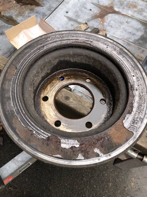

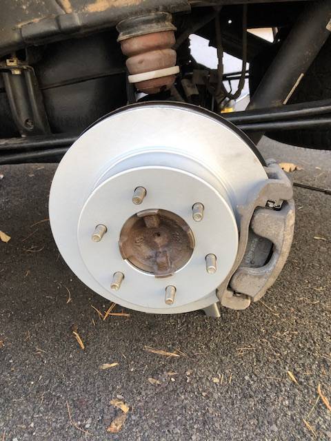

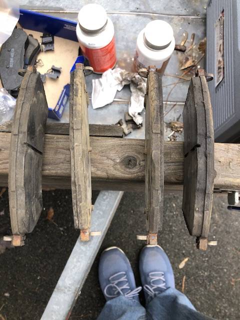

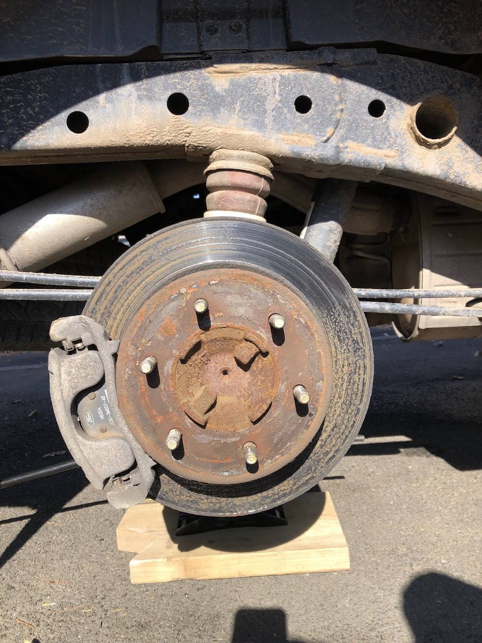

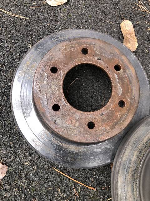

As promised….
Replaced the rear pads and rotors today:
Guess which pads were inner ?
Old rotor inner face:
This was the worst of the two…
Outer face:
New rotors and pads:
After bedding the contact areas look good. Sure feels better too.
