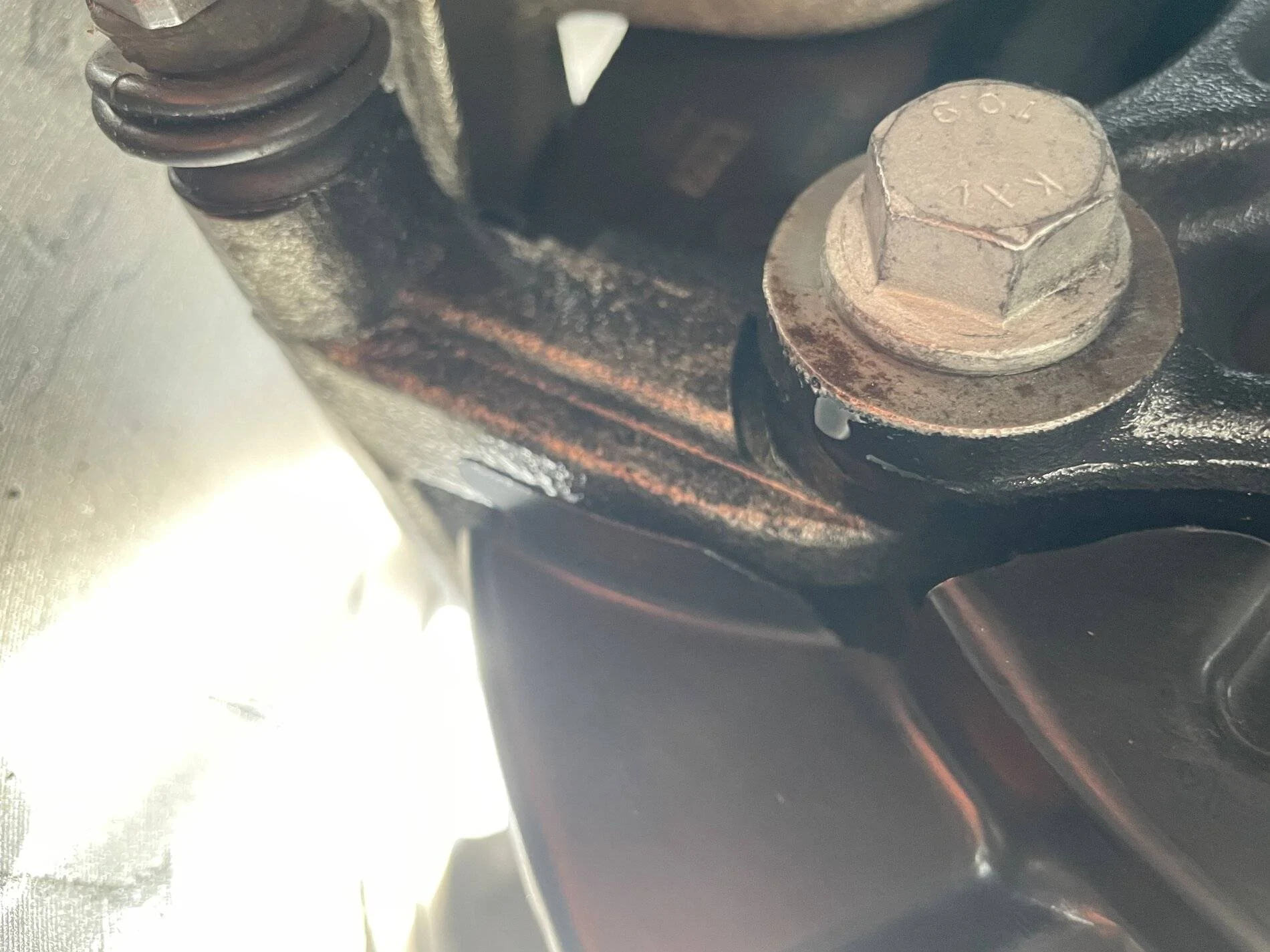

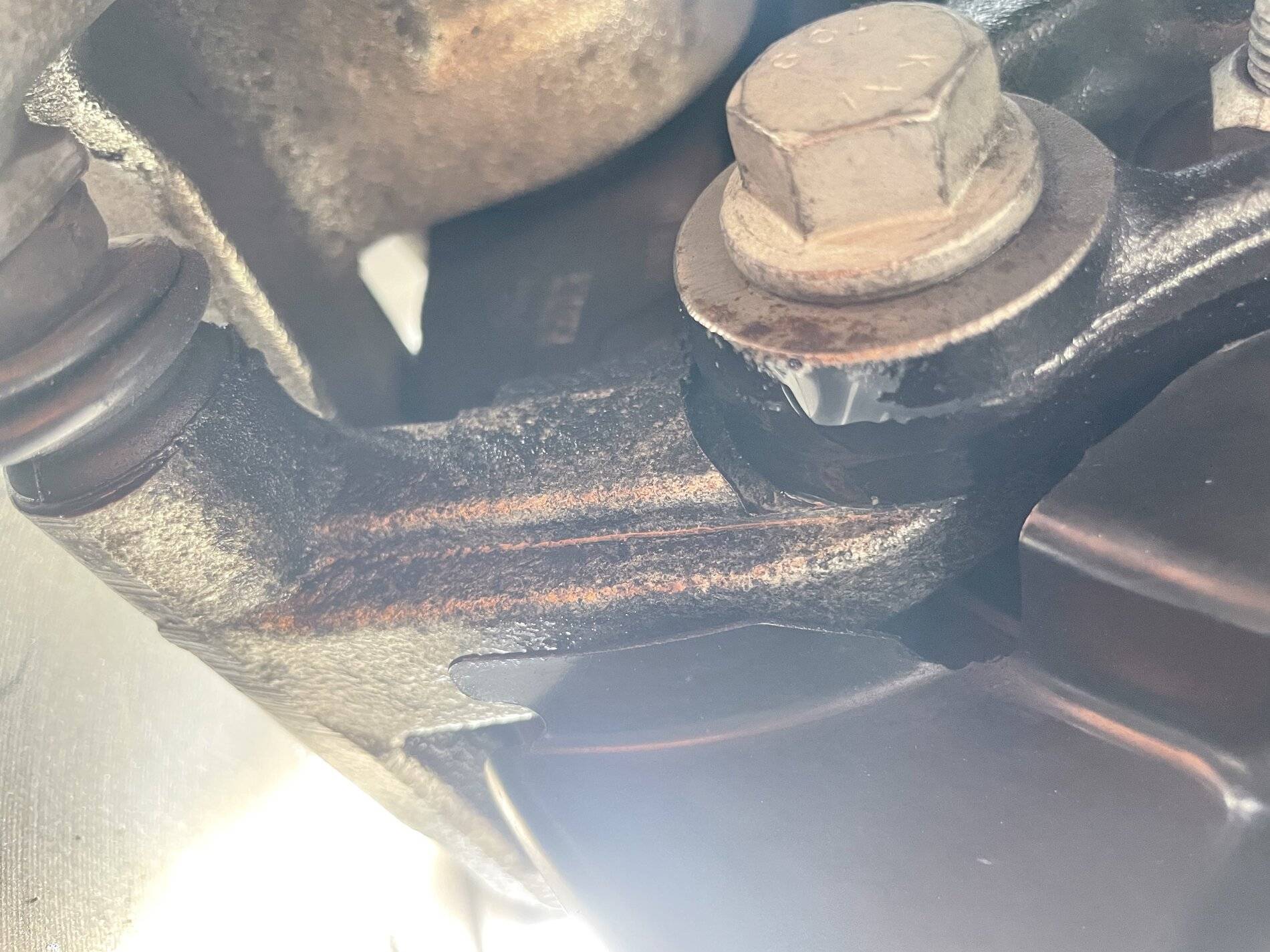

This is what mine looked like with the driver side leak. Dirty oil residue all over the caliper mount and shield, even a small puddle that formed on the inside of the wheel. It seemed after it leaked for awhile during the parts wait it would reach a level where it could no longer make it out of the axle tube.
