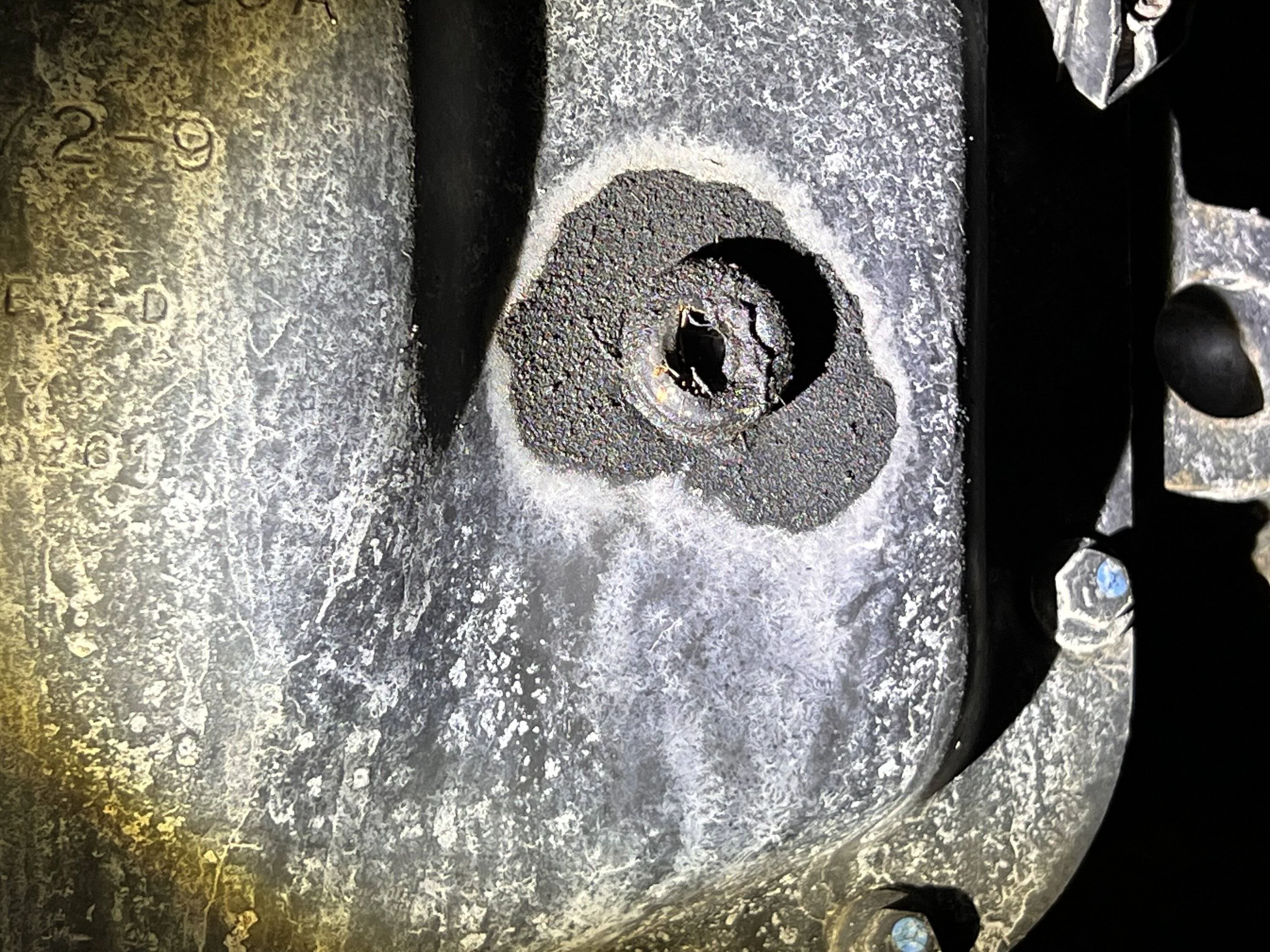

Truck is running great, but I was underneath it doing some quick routine inspections when I saw the plug on the rear diff was wet. Doesn’t look awful, but here it is:
and here’s a closer shot:
whatever it is, the leak doesn’t look awful. I was in some snowy conditions and ran the 4WD system a bunch on the snowy roads. Not sure if that’d add to this.
Any concern here? I can try tightening, or maybe this is a good opportunity to drain and replace the fluid (I just hit 60k miles) and swap to the Ford Performance cover lol? Or is everything fine and I’m being an over worried weenie?

You're being a little over-worried. It is a pipe thread, it is normal to seep a little.
At 60K, now is a good time to change the fluid though. Hit it with some brake cleaner, drain and refill.
7,143
24,329
dont look to bad. but it will make you feel better to drain and refill. clean up the cover real well so you can see if its leaking in the future.

Eeeexcellent info, all! Thanks! Yeah I’ll go for the refill, clean, and monitor. Much appreciated!

In prep to attack this assignment I went and watched a few videos on the diffs and transfer case. Interestingly, they all had some weeping around the full bolt like this. Mine appears to look the largest, but I suspect that’s just because I have some extra road grime on the diff cover that absorbed the fluid. Confirms to me what you’re saying, the weep is normal. Really, thanks!

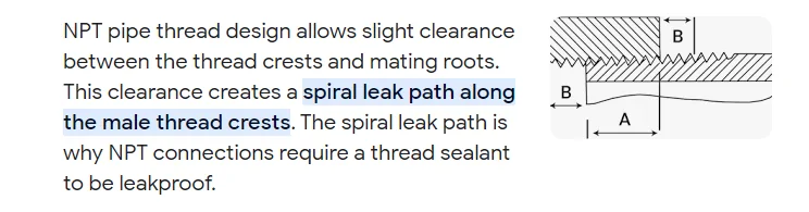

This is essentially what it is. Lots of manufs have moved on to o-ringed plugs, or gasketed plugs of some kind. Its just old technology that works, just with that one little caveat.
-Edited--
There are scores of trucks in the junkyard that have gone to their death with a pipe thread plug and still have enough oil in them they could probably go another 200,000 miles. It doesn't take much oil to make it look like a big mess.

Yeah, totally agree. The extra road grime made the small amount of oil appear to "bloom" outward on the back of the diff. Makes total sense.
