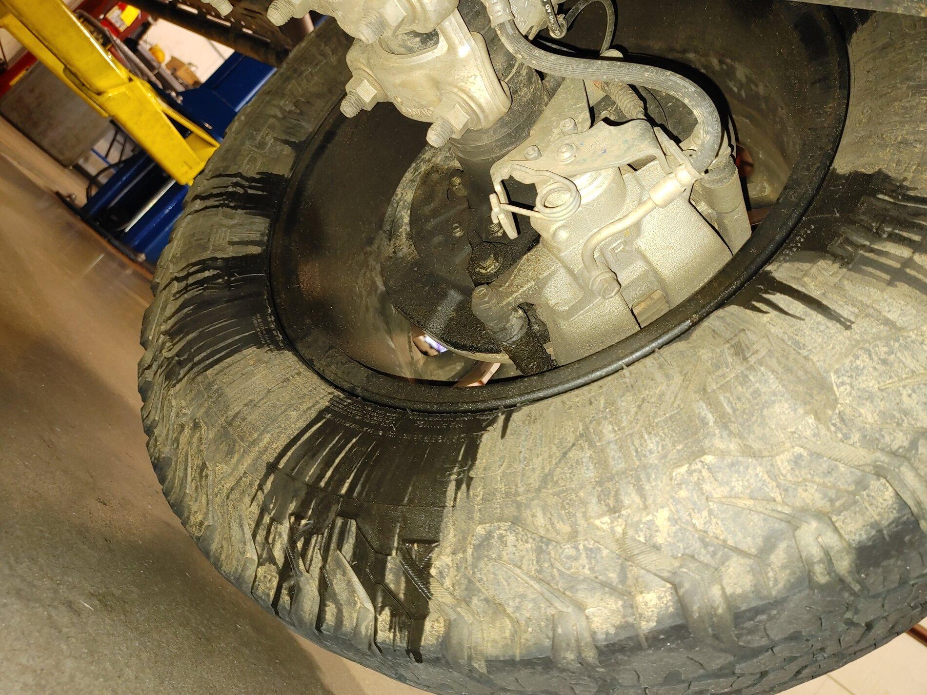

I put on my Eibach suspension tonight and noticed a pretty big leak on the RT rear. So seems like depends on the dealer as to if they throw a new seal in and let you ride and others a new axle, pads, rotor and seal? There is definitely oil on my caliper and pads for sure. Just wondering how the conversations went with service advisors to make sure its covered. I have extended warranty as well hopefully that will mean something
t4thfavor
Chance
Feb 5, 2019
2,607
2,358
If the leak is that bad, there's literally only one (acceptable) answer.
They must replace the axle/seal/pad/rotor
The axle/seal are an assembly, they cannot be ordered separately. The Rotor/pad is now contaminated with entirely too much oil to salvage. They may have to do both sides depending on how many miles are on the truck.
Literally do not let them mess with you or you'll end up like me with 10+ visits to the dealer for brake jobs... IF they try to mess with you, call Ford Customer Care ASAP.

Good advise. Thanks so much. I know they will want to say I have aftermarket suspension, tires and went off-road bla bla ect. But hopefully they do the right thing. I have just over 20k on the truck so yeah for a 20k mile truck and it bought a 4x4 so I mean the purpose for 4x4 is the ability to go off-road. May call a few dealers local and see how they act when I tell them to try and figure out who will be more apt to take care of it.
