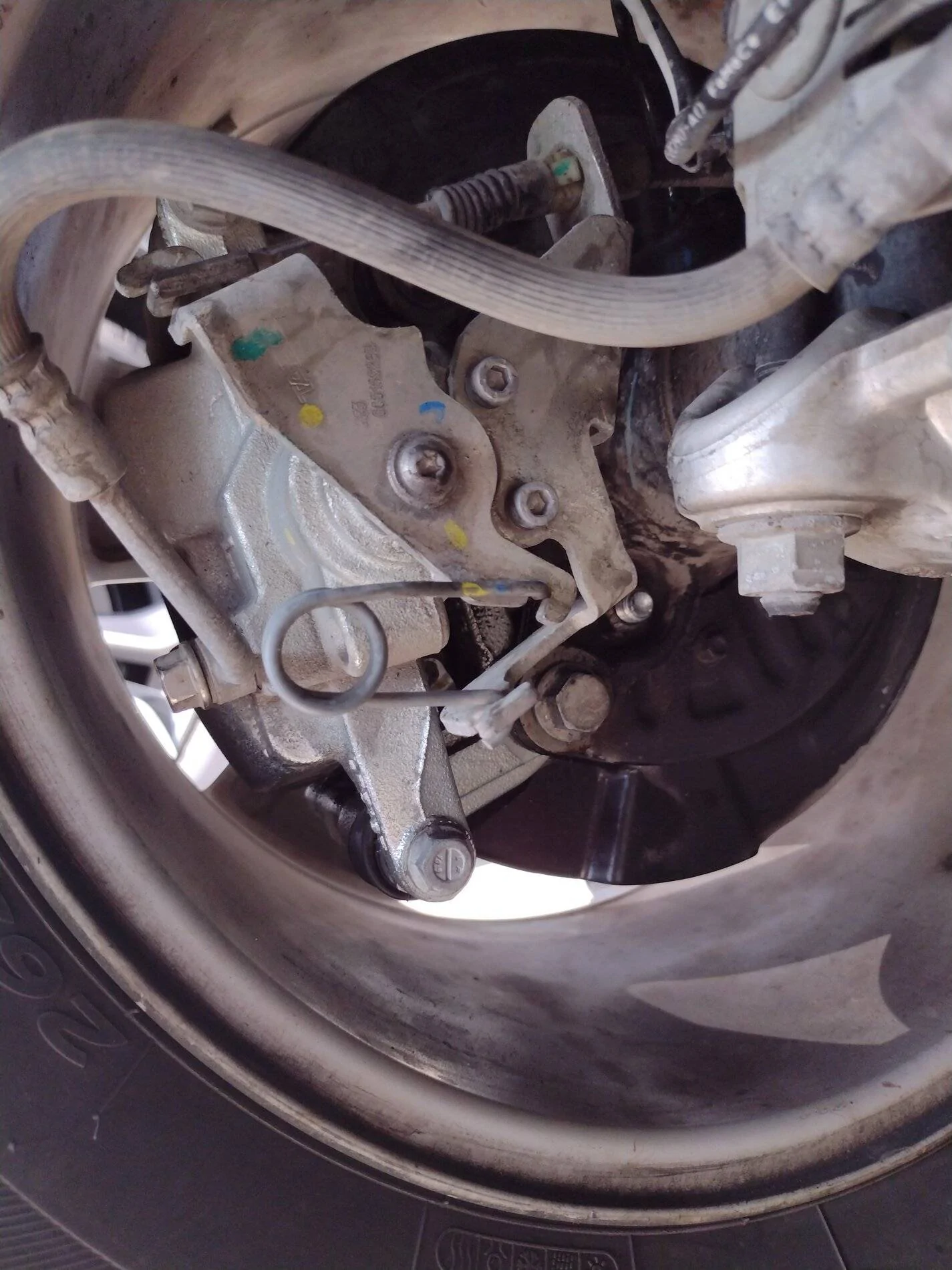

Sorry for digging up an old thread, but I am trying to diagnose an issue with my Ranger.
I have a rubbing/scraping/dragging kind of sound when the truck is in motion, forward or reverse, it sounds like something brake related but when I pulled the wheels the rotors were smooth with no real grooves dug into them. It seems to drive normally, and while I haven't seen any oil inside my rims I will go back out and clean the stone shields and calipers to see if I missed a small leak.
Appreciate any input, thanks.

Jim can you have someone drive your truck slow (maybe in a parking lot) and you could walk beside it to see if you can hear where it's coming from? At least you might be able to pin point the area and get it back home and look from there.
