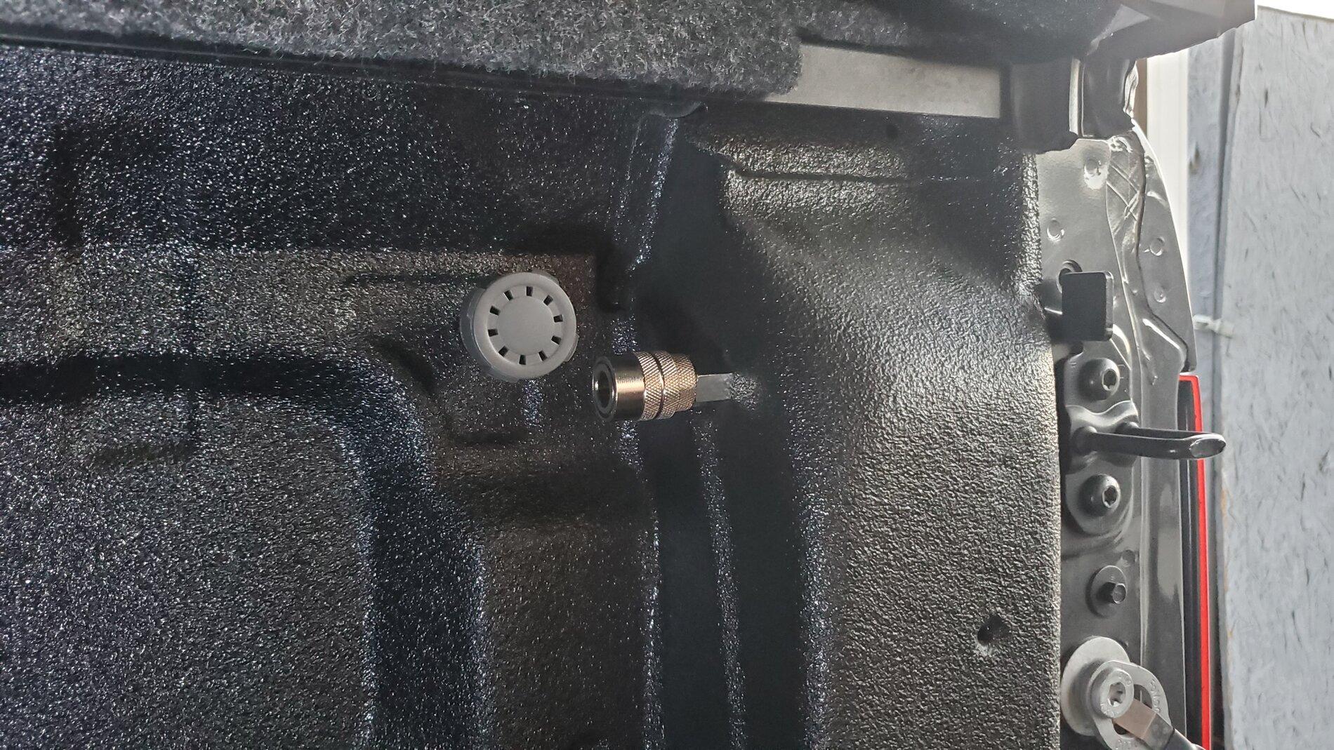

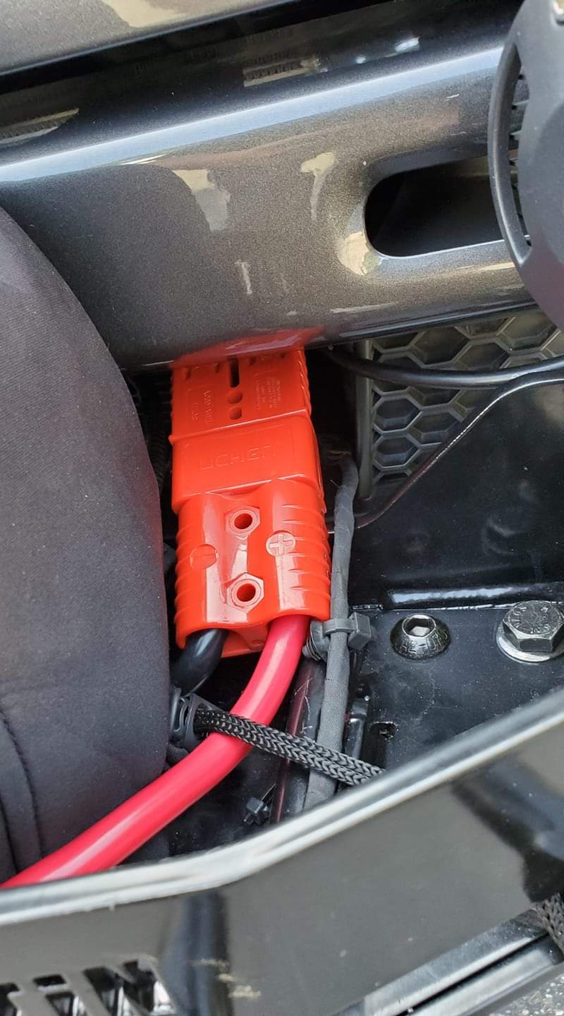

Quick connect/disconnect for the winch leads.

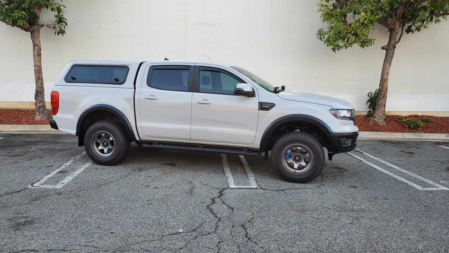

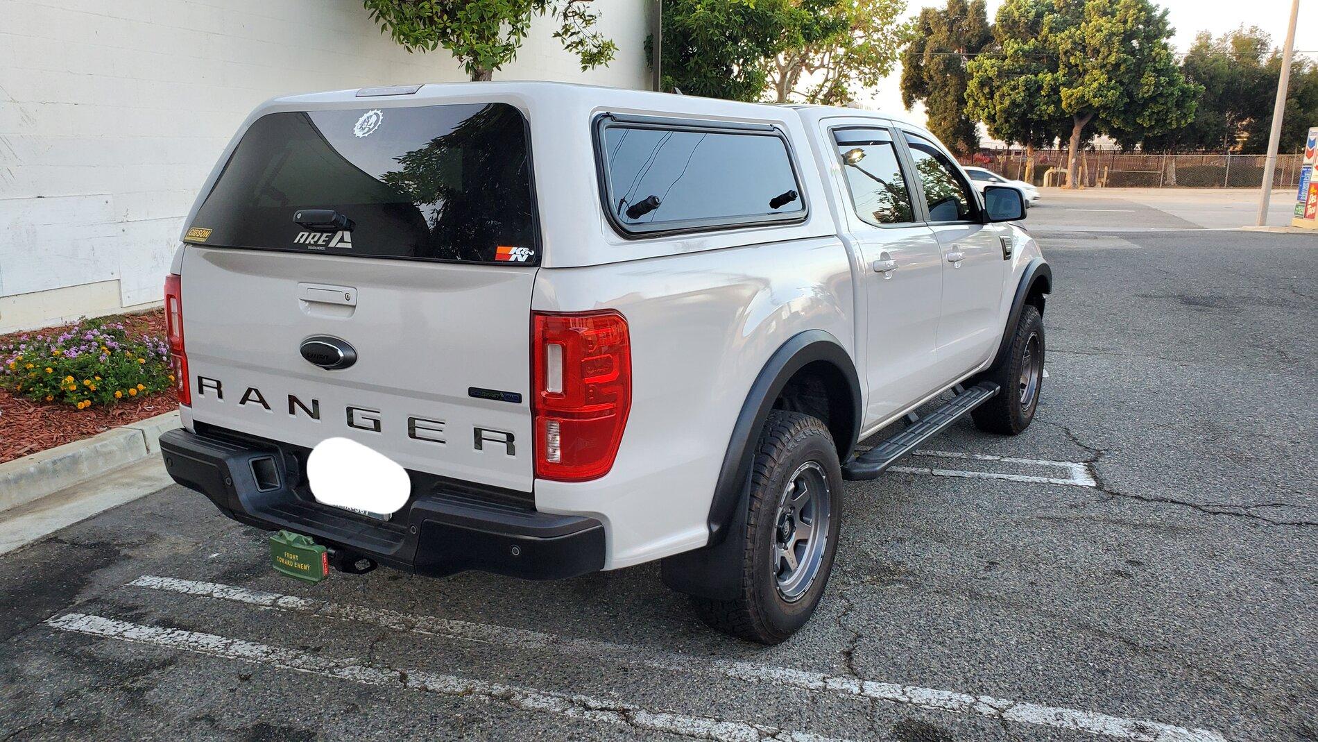

Out with the mudflaps and swapped on these small fender flares. The fitment of the corner markers is not great. I may have to shaved them a bit to get them to sit flush. Otherwise they look OK. I may or may not keep them. Maybe find some kind of extension for the front bumper area.
Are these the Bushwacker OE style fender flares?
Yes, they are Bushwhacker OE style fender flares, but textured not smooth. Bushwhacker is made by Lund. If you order Bushwhacker it's very likely the box will actually say Lund on the label.
I have the full size smooth flares from Bushwhacker/Lund and the side marker lights fit perfectly.
Ah I see - thanks for that! Looking at flares that are low profile so good to know those two are basically the same.

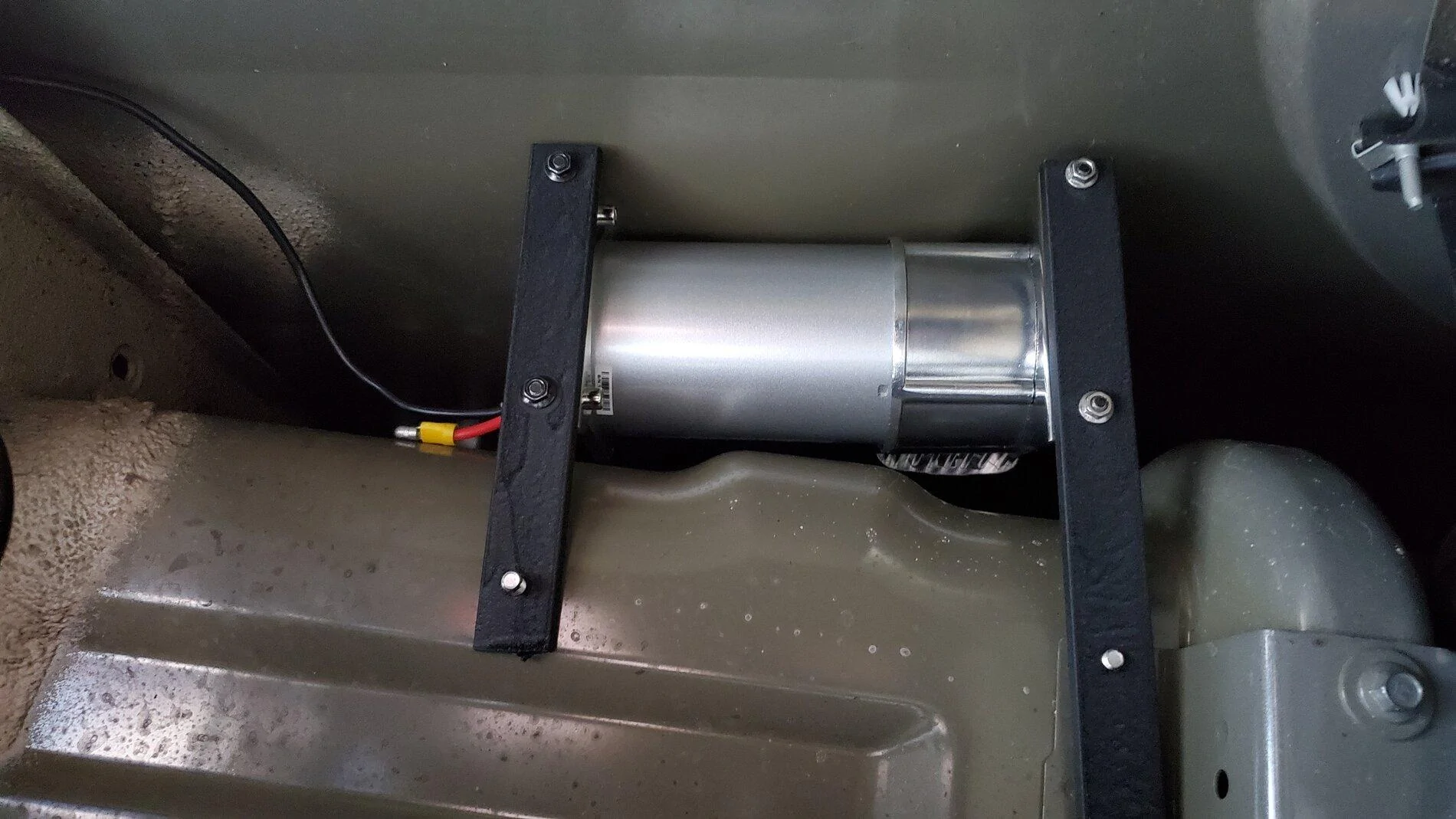

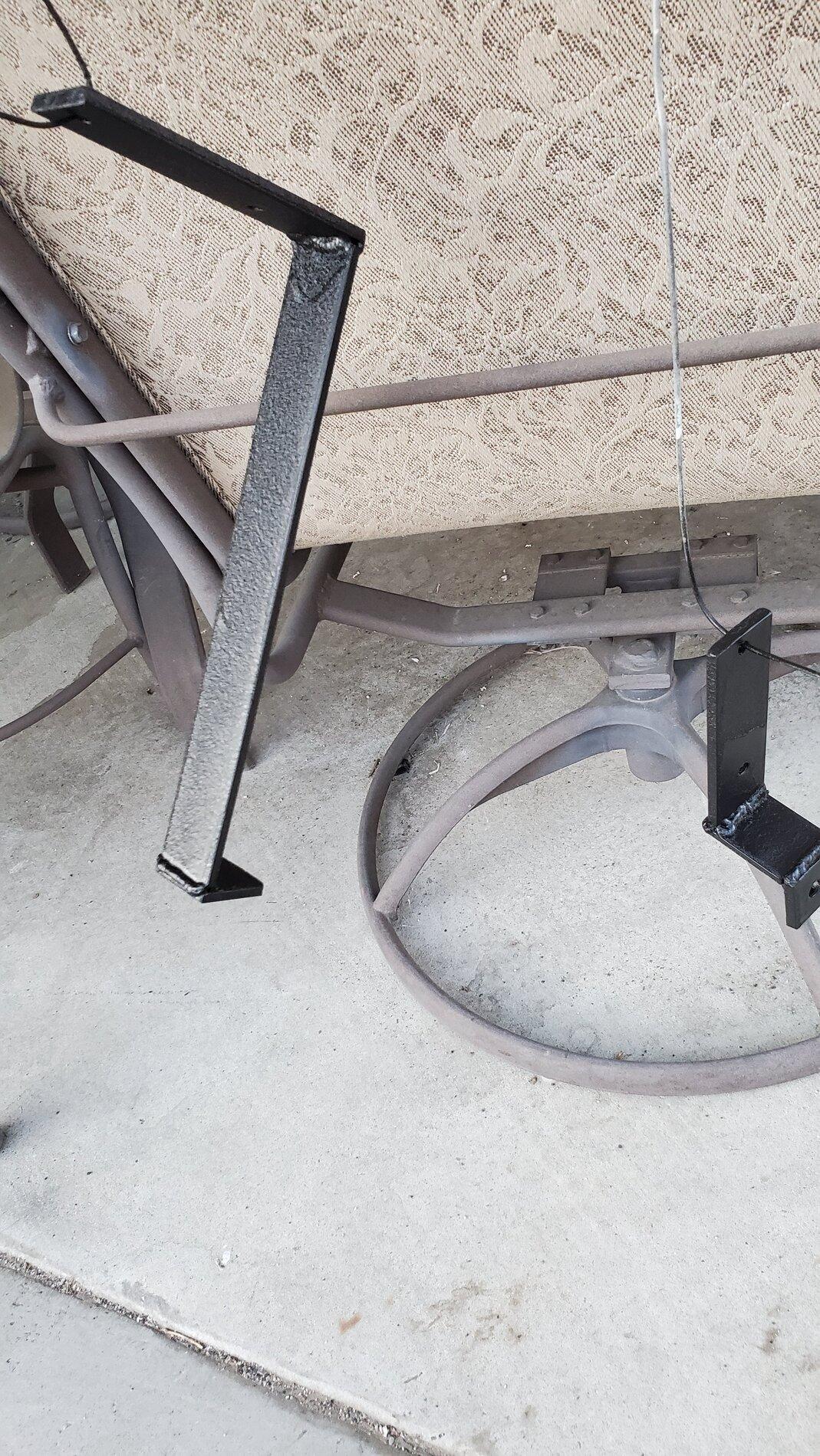

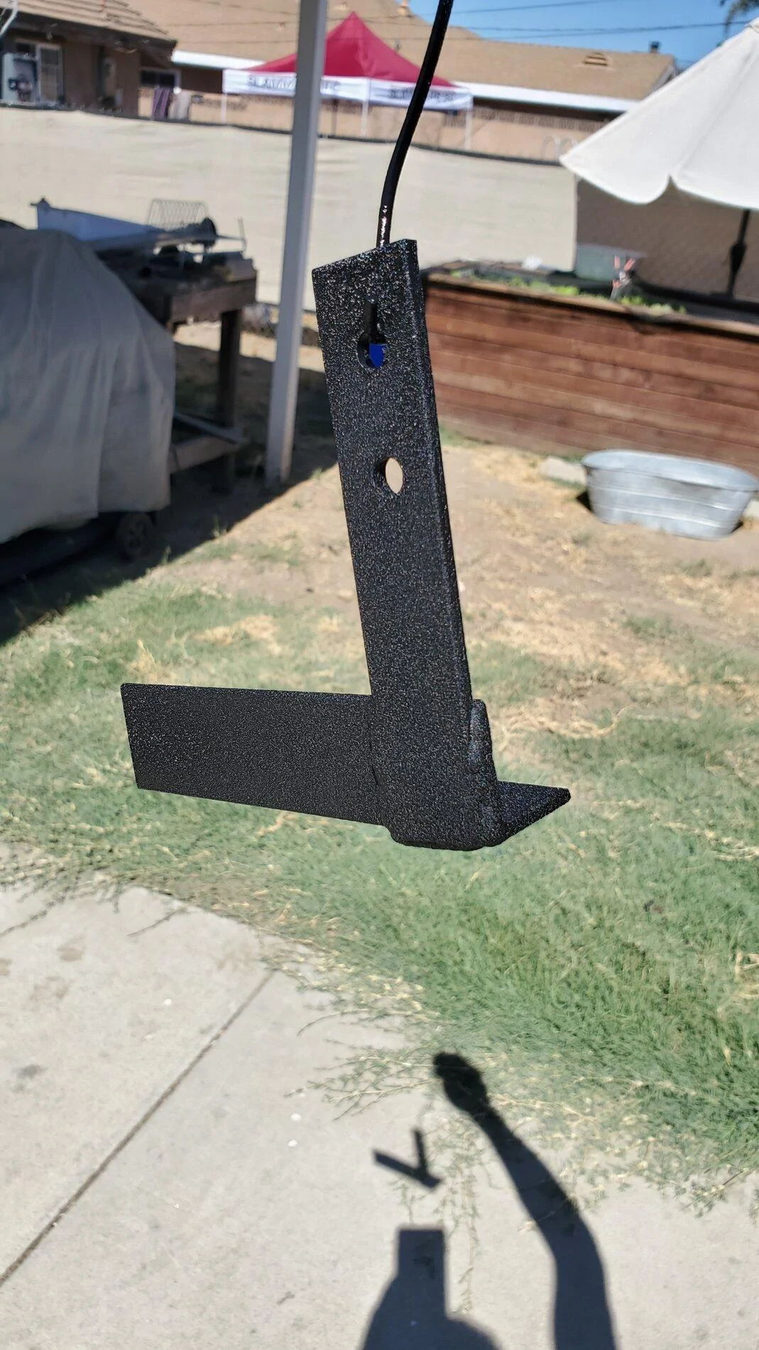

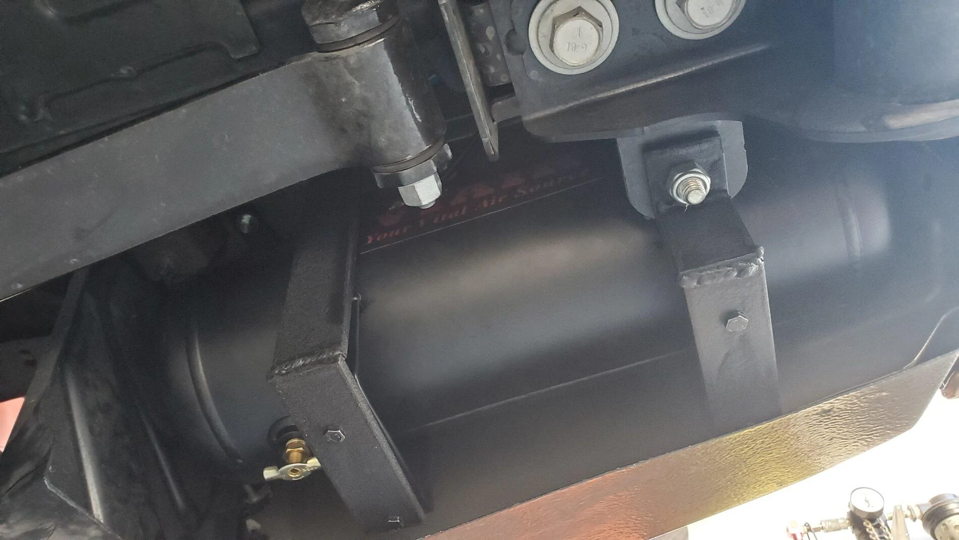

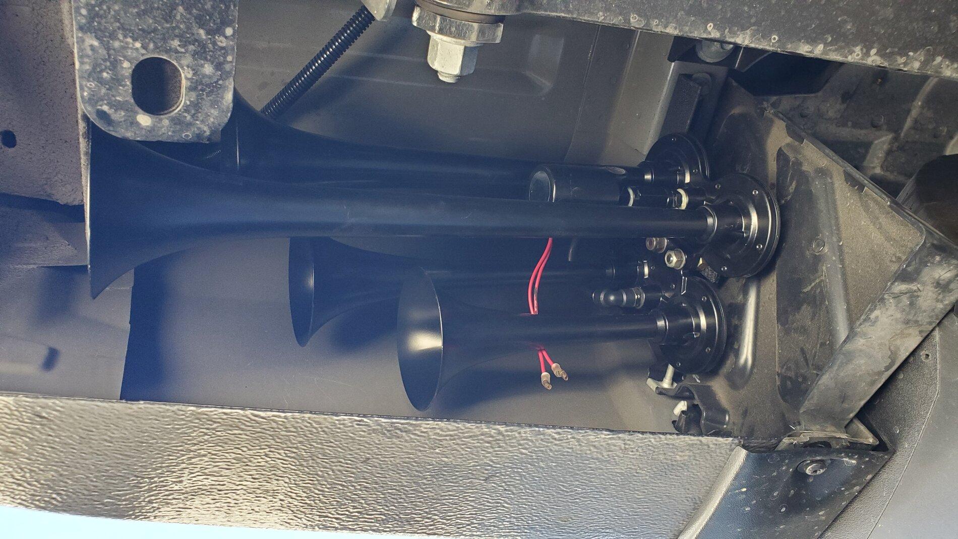

Finally done. Horns and air supply finished. To say the new Ranger is space limited is an understatement. Lots of fabricating of brackets and tons of fittings, lines and wiring. Took a little over 2 weeks to figure out, wait for parts and make everything work. Had to make my own brackets for the horns. Separate the compressor from the tank. Fab brackets for the compressor and tank. Remote mount the air filter for the compressor. Run a quick connect for air.

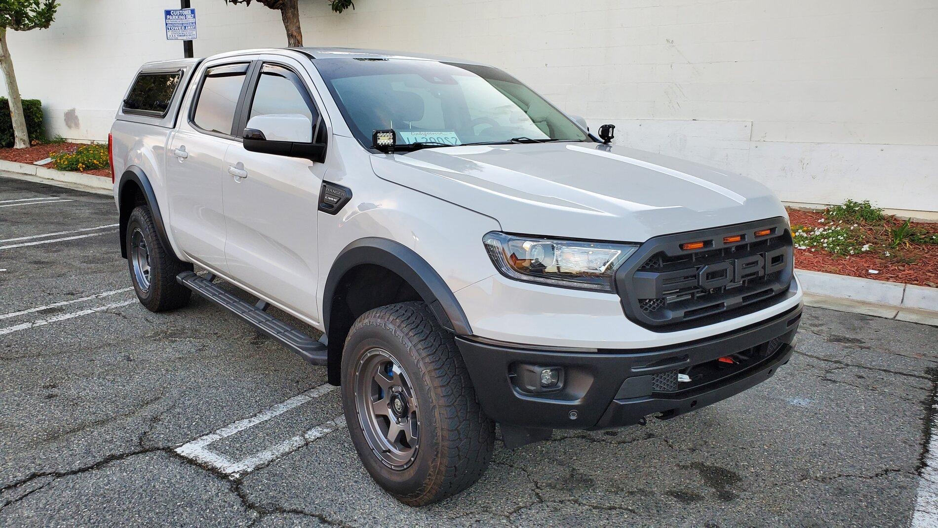

Finally got it close to the Avalanche gray color I originally wanted that Ford didn't offer and this was cheaper than doing the clear vinyl ppf. 3M vinyl.
Looks great, what did you do? And what did it run?
