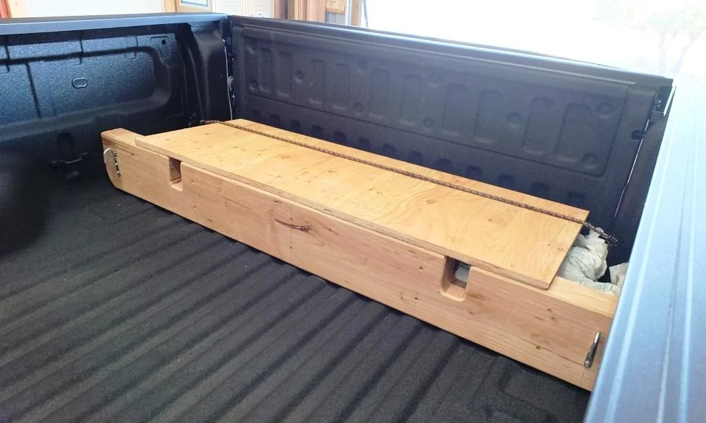

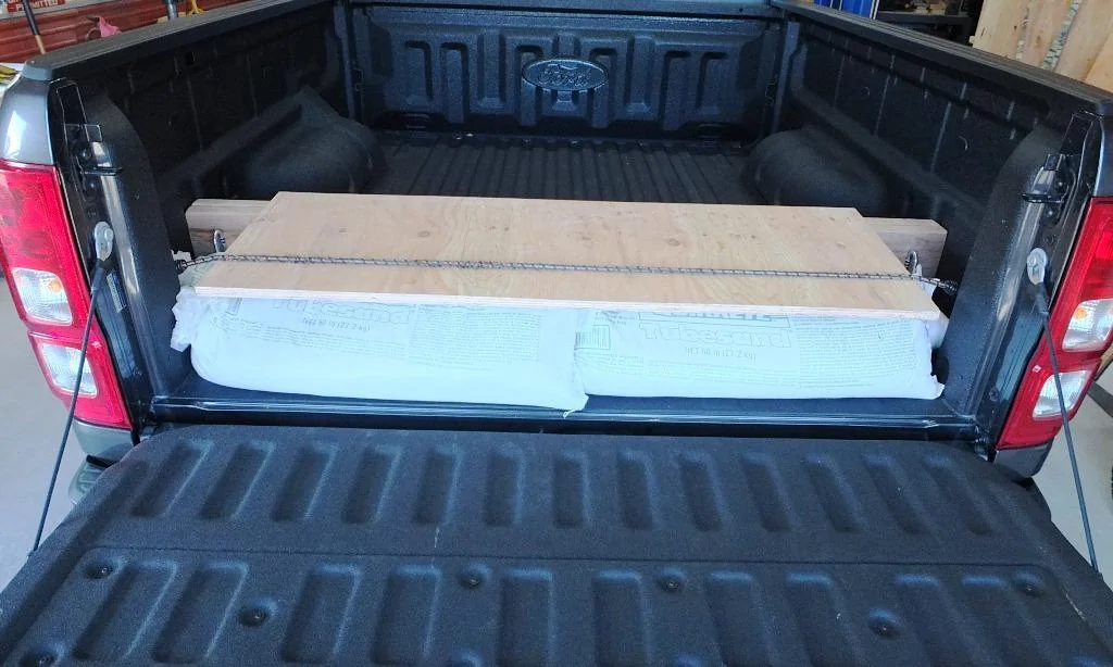

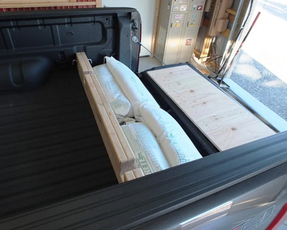

Adding Weight To the Bed.... Safely.
Nearly wrecked the truck a week ago on some black ice near Cripple Creek. Twisty mountain road, heading down hill grade and the road transitioned from sunshine to shade around a left hand curve and the rear end broke loose on black ice and headed for the ditch. I was able to quickly steer right and bring it back in line but it was a pucker factor of about 10.
I've driven manual shift vehicles since 1985. While I like the Ranger... I truly hate not being able to let off the accelerator and have instant motor braking. Truck was in 2 wheel drive. Roads were dry and clear up until that point. 40 mph zone, I was driving 35mph.
So I reflected back to the old days when I drove automatic transmission vehicles and decided to add some ballast to the truck.
I installed the rear divider I previously built for The Lumber Rack. Then bought (4) 60 lb bags of Quikrete Tube Sand. The problem is these bags freeze and get hard as a rock. Then when you hit the brakes they like to move around. I'm also concerned that under heavy braking or, heaven forbid, a head on collision that these bags will end up being projected over the divider and through the back window.
So I attached a piece of 3/4" plywood by screwing it to the rear divider with (4) countersunk screws, and then added a bungee chord across the plywood, attached to the rear bed tie downs.

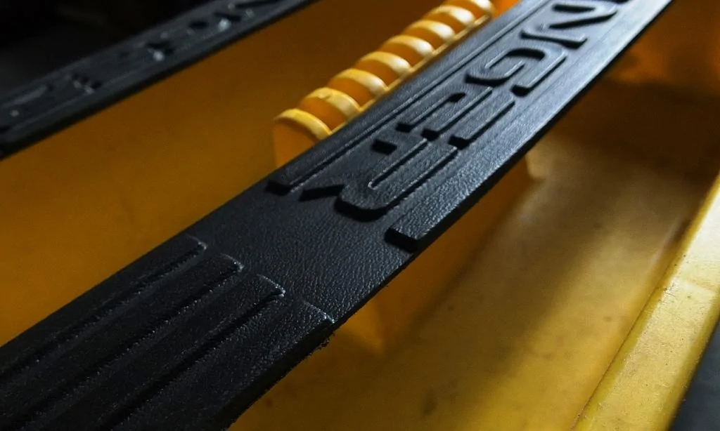

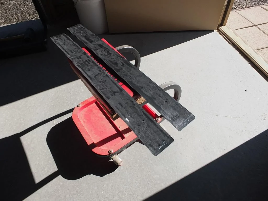

Door Sill Scuff Plates, continued from Post 42

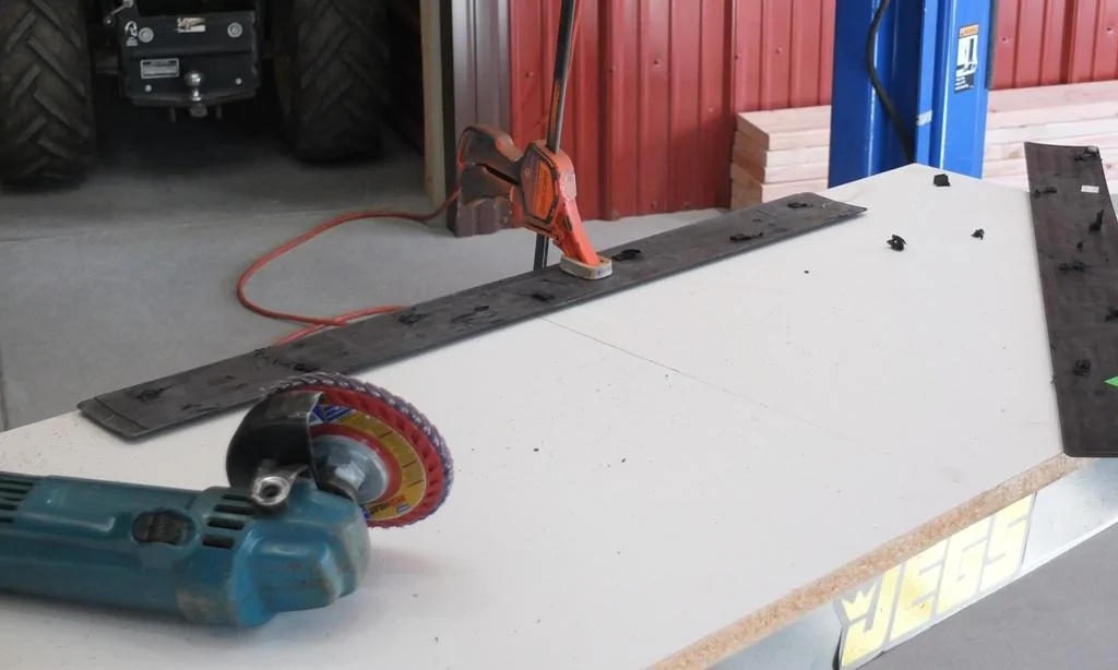

Modified the sill plates by using an air die grinder and cut off wheel to remove the rear mounting tabs.
_________________________________________________________________________

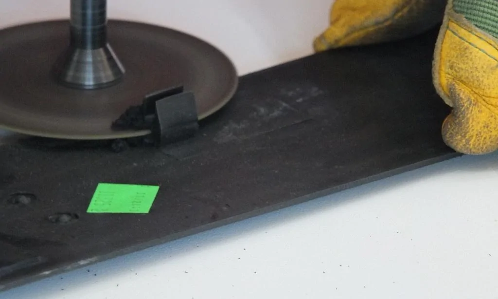

Then used a 4-1/2" angle grinder with a 60 grit flap disc to level out the remaining stubs of the mounting tabs.

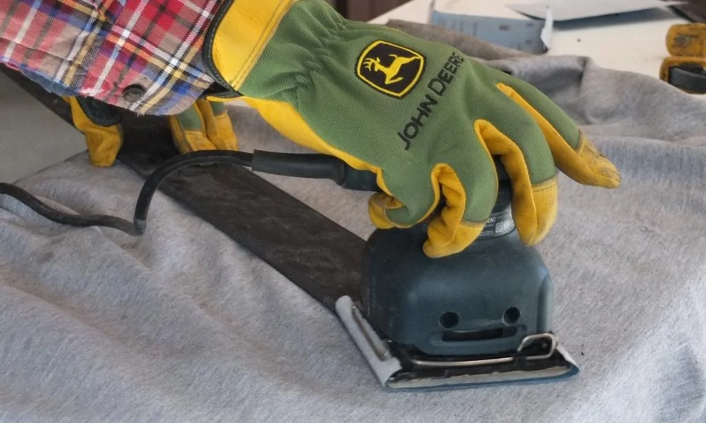

Next step was using a palm sander and 80 grit.

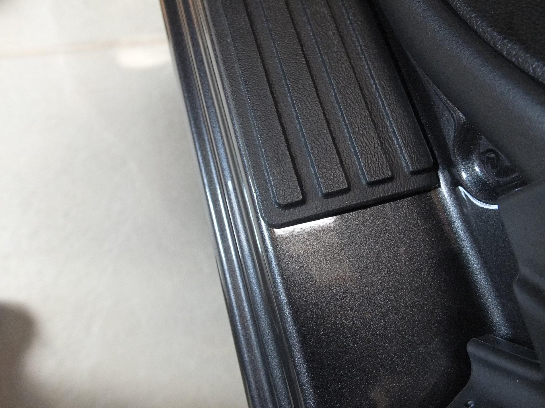

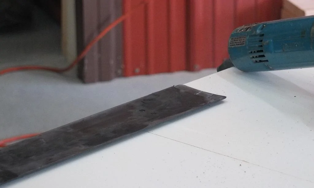

When I test fit the sill plates they were a bit to wide and hung out over the edge of the sill. I used the angle grinder and 60 grit flap disc to remove the top lip and sanded it down flush with the top rib.

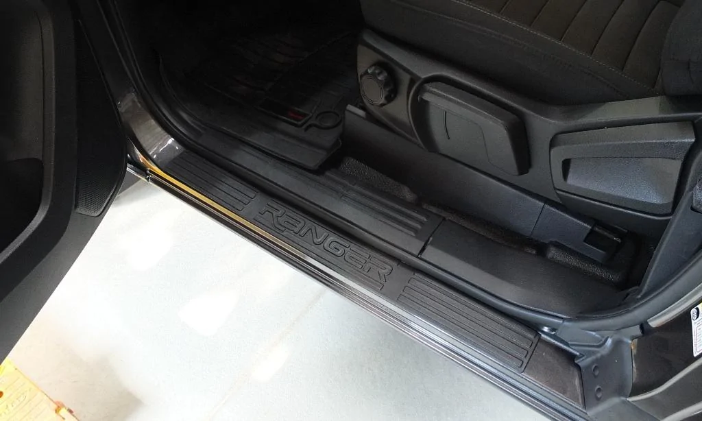

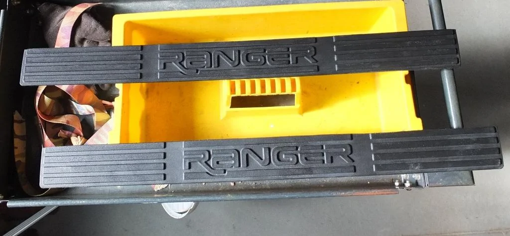

And here they are mocked up, ready for tape.. or silicone.. or ????.

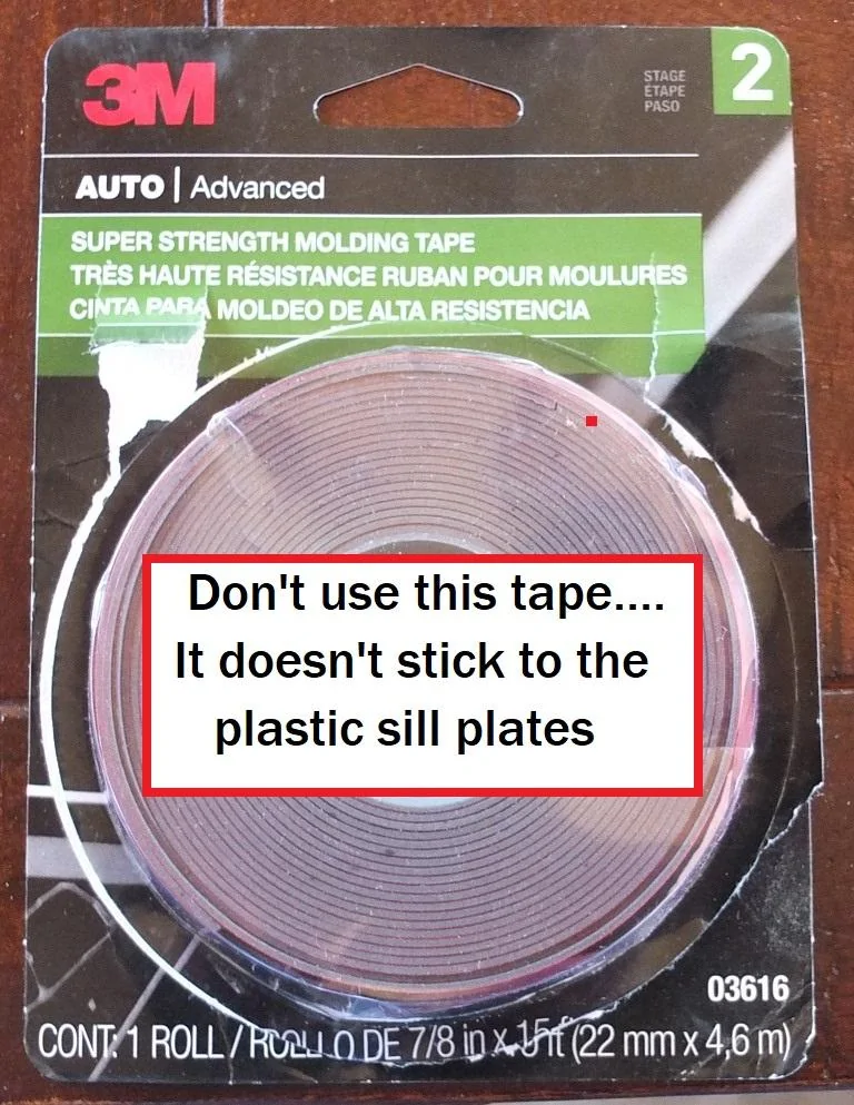

The tape I bought to mount these isn't going to work. It doesn't stick to the plastic sill plates. Here's what I tried to use. Anybody have any suggestions on what type of tape would work best in this application? How about clear silicone?
Link to Installation Using Silicone

I'm not the first 5th gen owner to use them... but I'm pretty sure I'm the first to use Silicone Adhesive.
Some folks that used double faced tape have had their sill plates "disappear"... literally fall off the truck while they were driving.
Magic sill plates... now you see them... now you don't!
Good luck and Happy Trails!
John, 3m double sided tape didnt want to adhere real well by itself. I used adhesion promoter and then 3m tape and they are on there tight as can be. Its a great mod and matches up with truck plastic trim and weathertech mats. Bret

Filled up with fuel today. It appears that the added weight drops MPG by about 1.
MPG was 24.6... typically it's mid 25 or higher.
Would think the effect of +-250 lb would be minimal. More likely cooler weather and winter gas. My mileage always take a dive in the winter.

Until some point in 2019, Ethanol was added in higher amounts during Winter than Summer (it's now allowed year round). Ethanol contains about 10% less energy & mpg reflects this. Could be part of the reason?

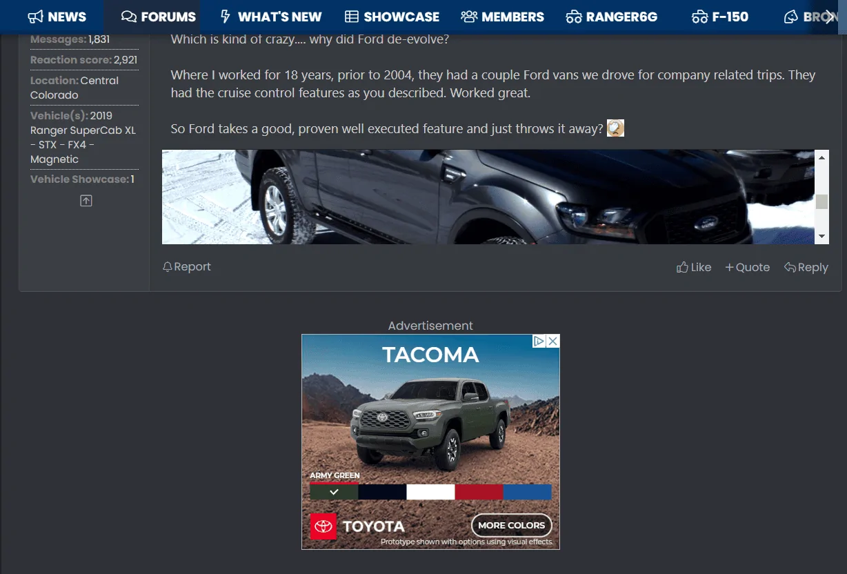

Which is kind of crazy.... why did Ford de-evolve?
Where I worked for 18 years, prior to 2004, they had a couple Ford vans we drove for company related trips. They had the cruise control features as you described. Worked great.
So Ford takes a good, proven well executed feature and just throws it away? :facepalm:
Nice ad popup while reading this post...... :LOL:

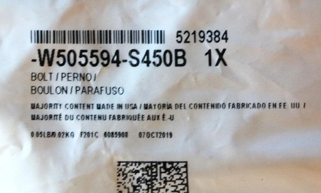

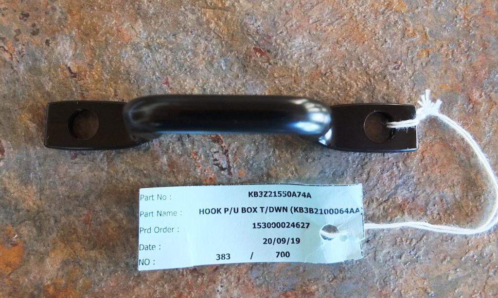

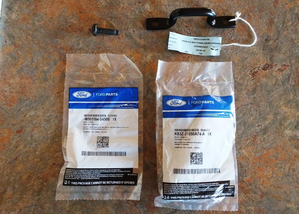

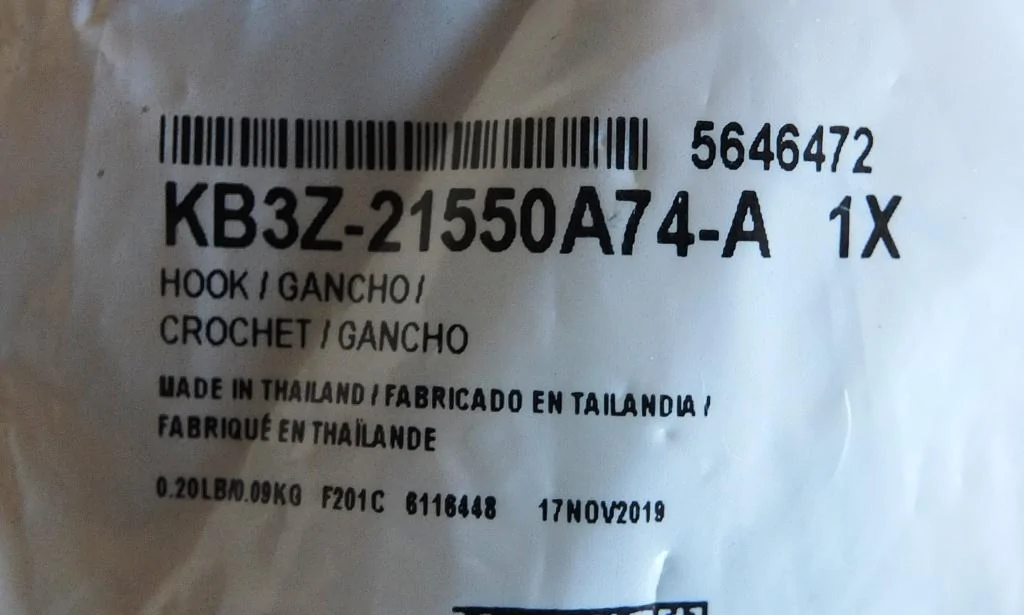

Pickup Box Bed Tie Down Hooks and Bolts
Continued from: Where are my missing bed tie down hooks
Link to: Installed Bed Tie Down Brackets
Got a call from my local Ford Dealer today. The back ordered Bed Hooks and Bolts were ready for pickup.
They wrote it up as a Service Warranty Claim so there was no charge.
Here are the part numbers in case you need them:
Tie Down Hook - Ford (KB3Z-21550A74-A) $6.49 ea, Quan. (2) = $12.98
Tie Down Hook Bolt - Ford (-W505594-S450B) $3.90 ea, Quan. (4) = $15.60
__________________________________________________Total = $ 28.58
I need to buy a tap to chase the threads in the truck since the truck has the ford factory sprayed Toughbed liner in it.
