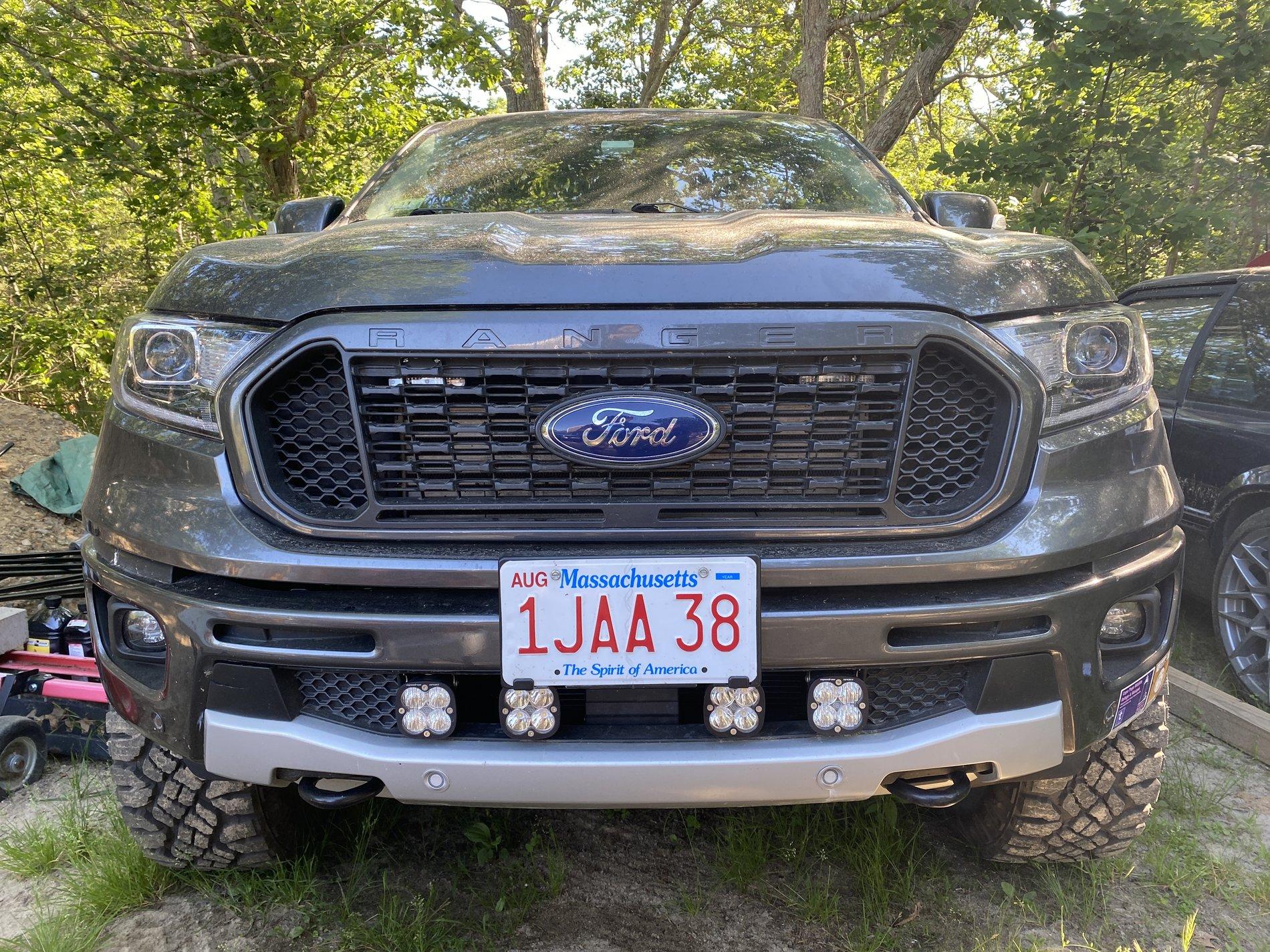

Lightheads are mounted! Still anxiously awaiting the control system. All Whelen products.

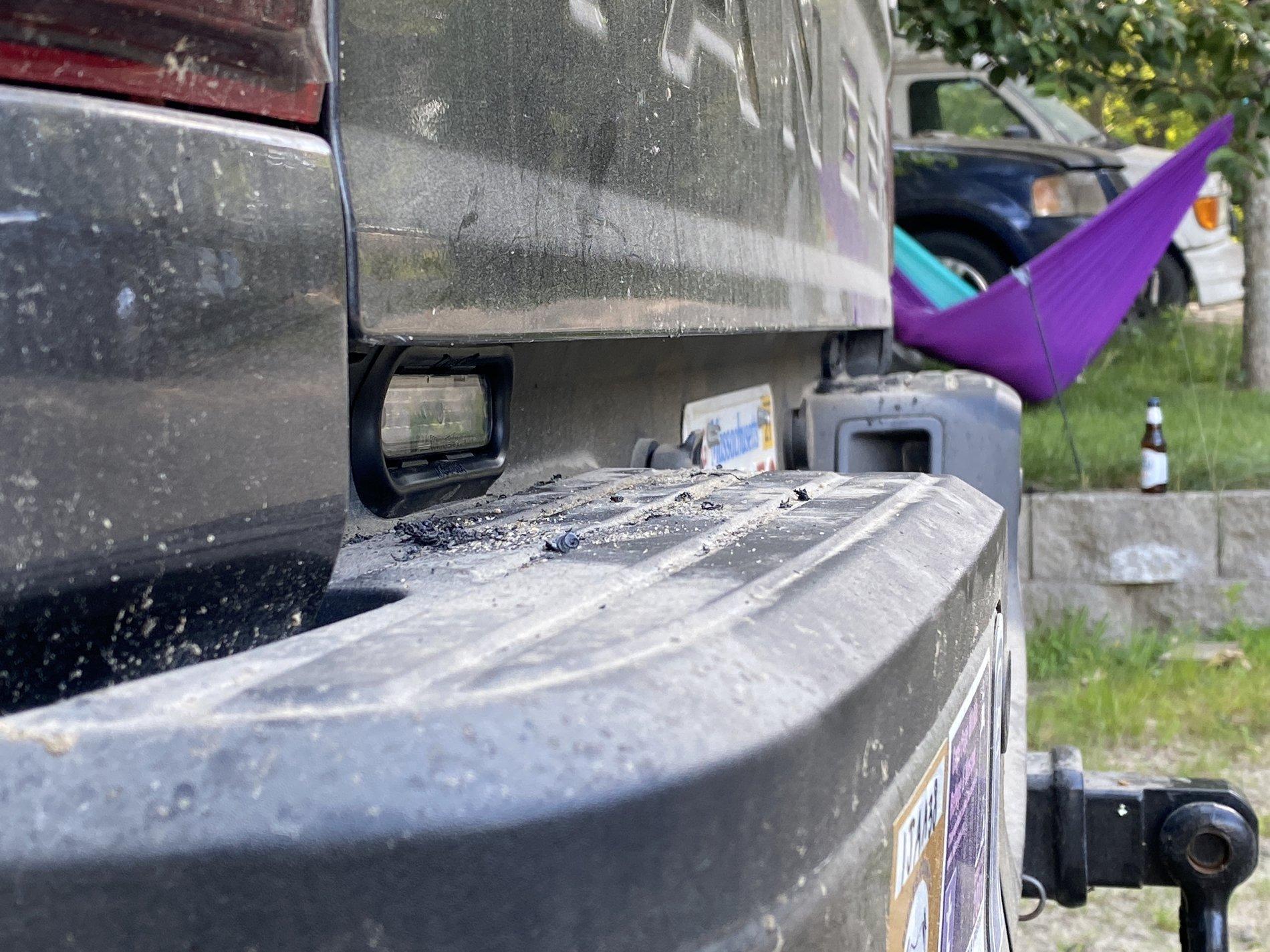

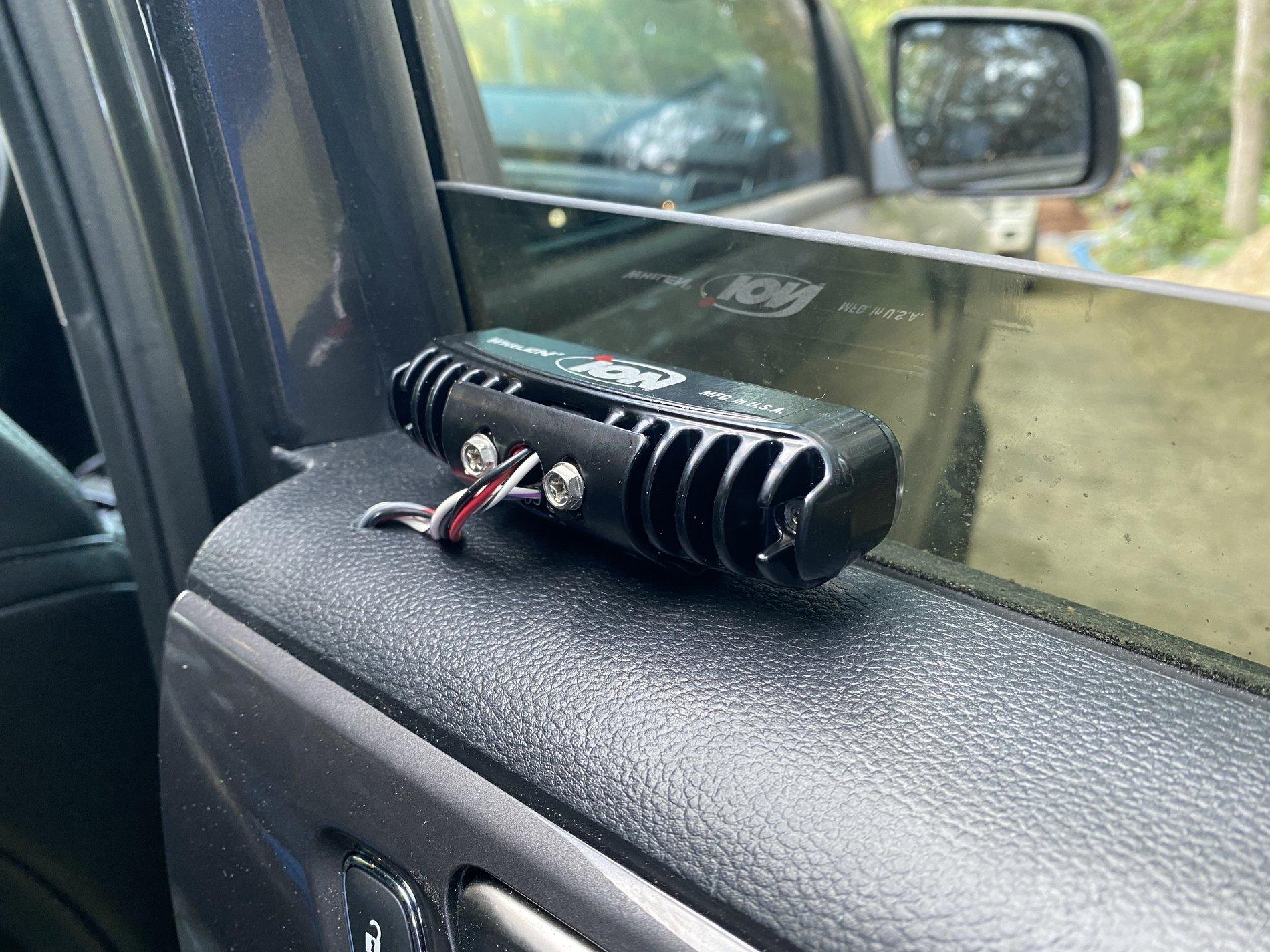

Two ION TRIO Red/Amber/White lightheads in the grille

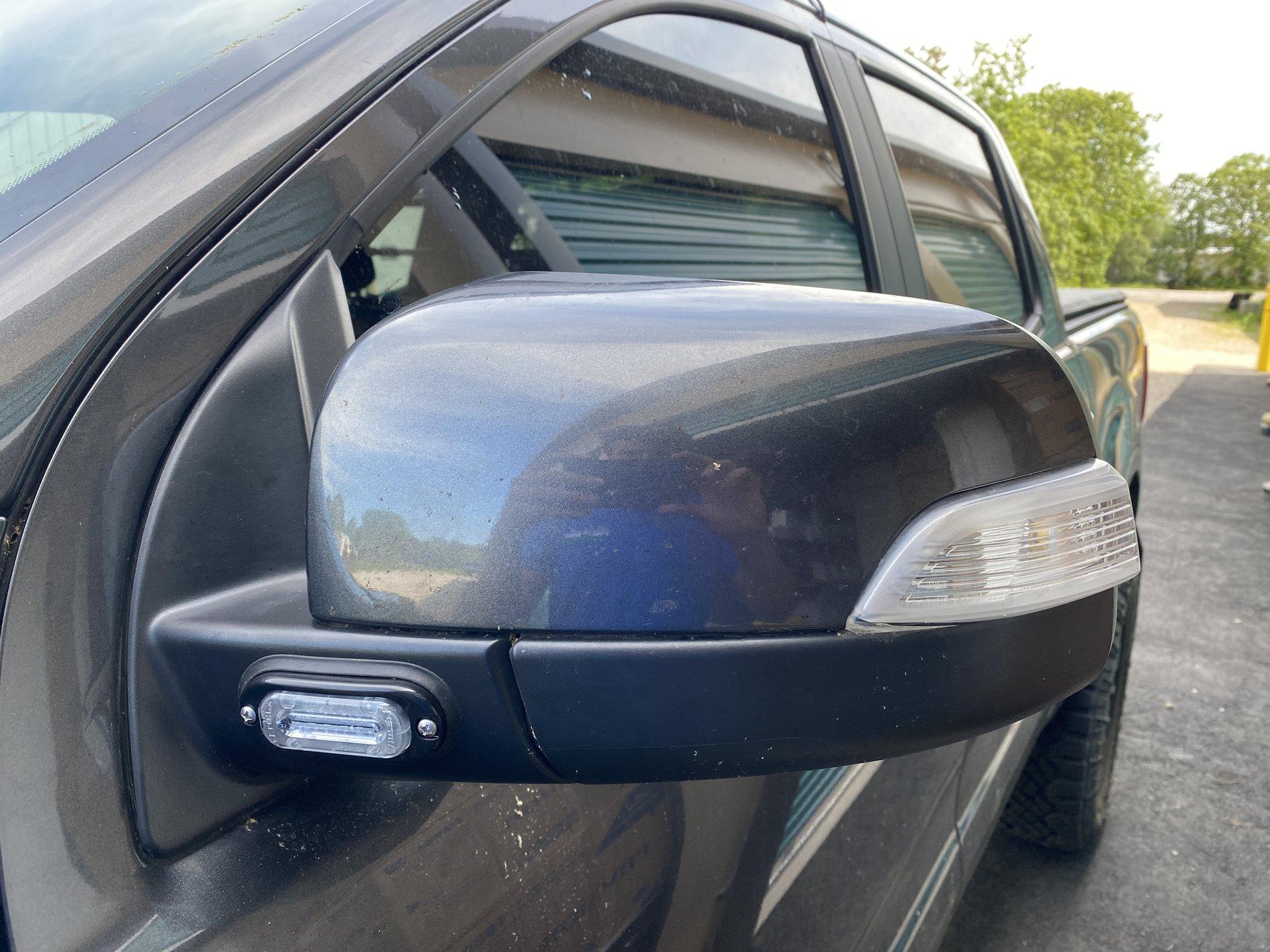

Two Mini-T ION DUO Red/Amber on the mirrors
Two ION DUO Red/Amber on the rear door sills
Two ION DUO Amber/White in grommet mounts under the tailgate
The bright (day) portion of the DRL bars and the rear turn signals will also be flashed with the Core system when it arrives.
I plan on tinting the mirror lights, grille lights, and probably the ones under the tailgate, too, to make them slightly less conspicuous. The grille lights really disappear already when you're more than 40 feet from the truck, however.

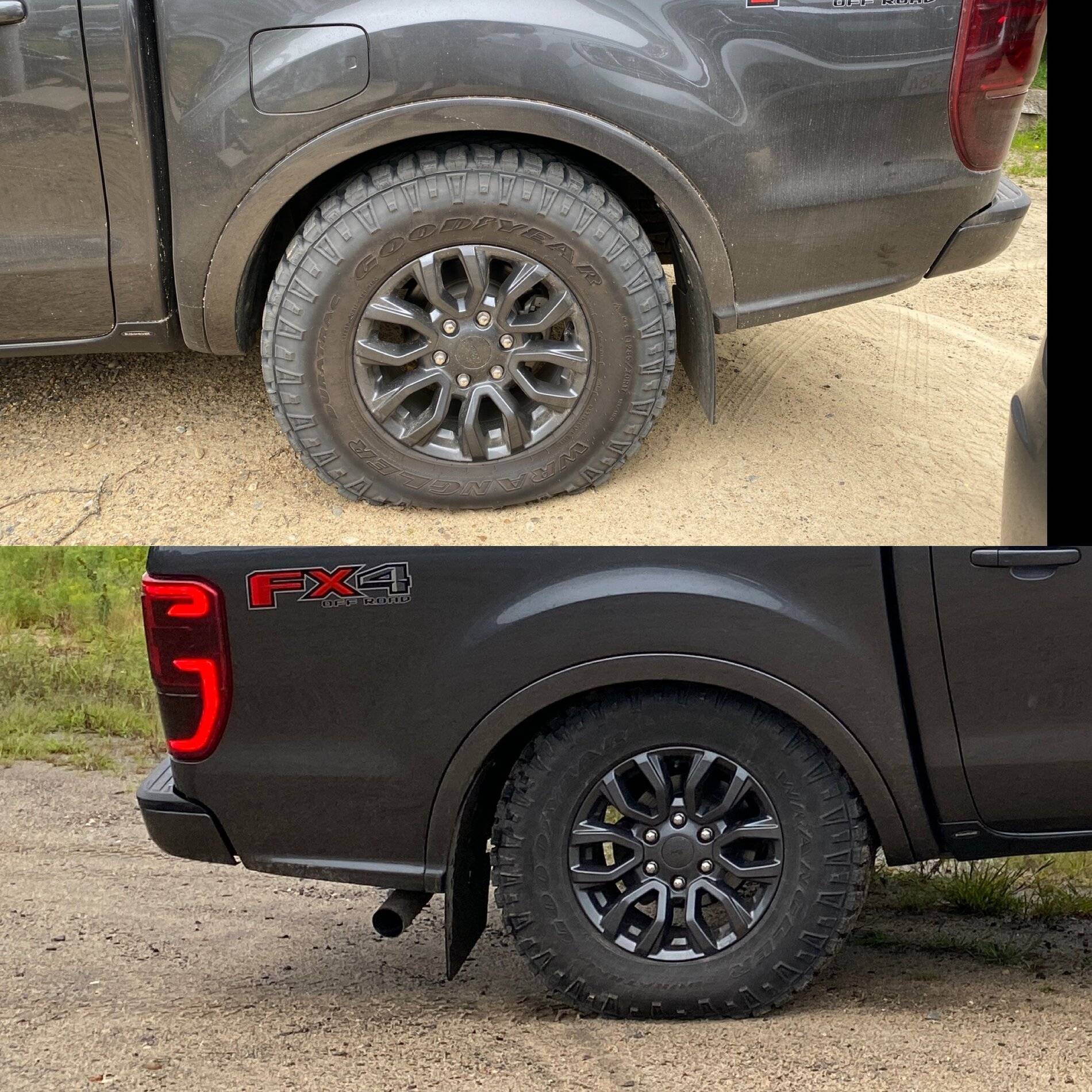

Less mods, more road trips! I've been busy putting some miles under Rainier.

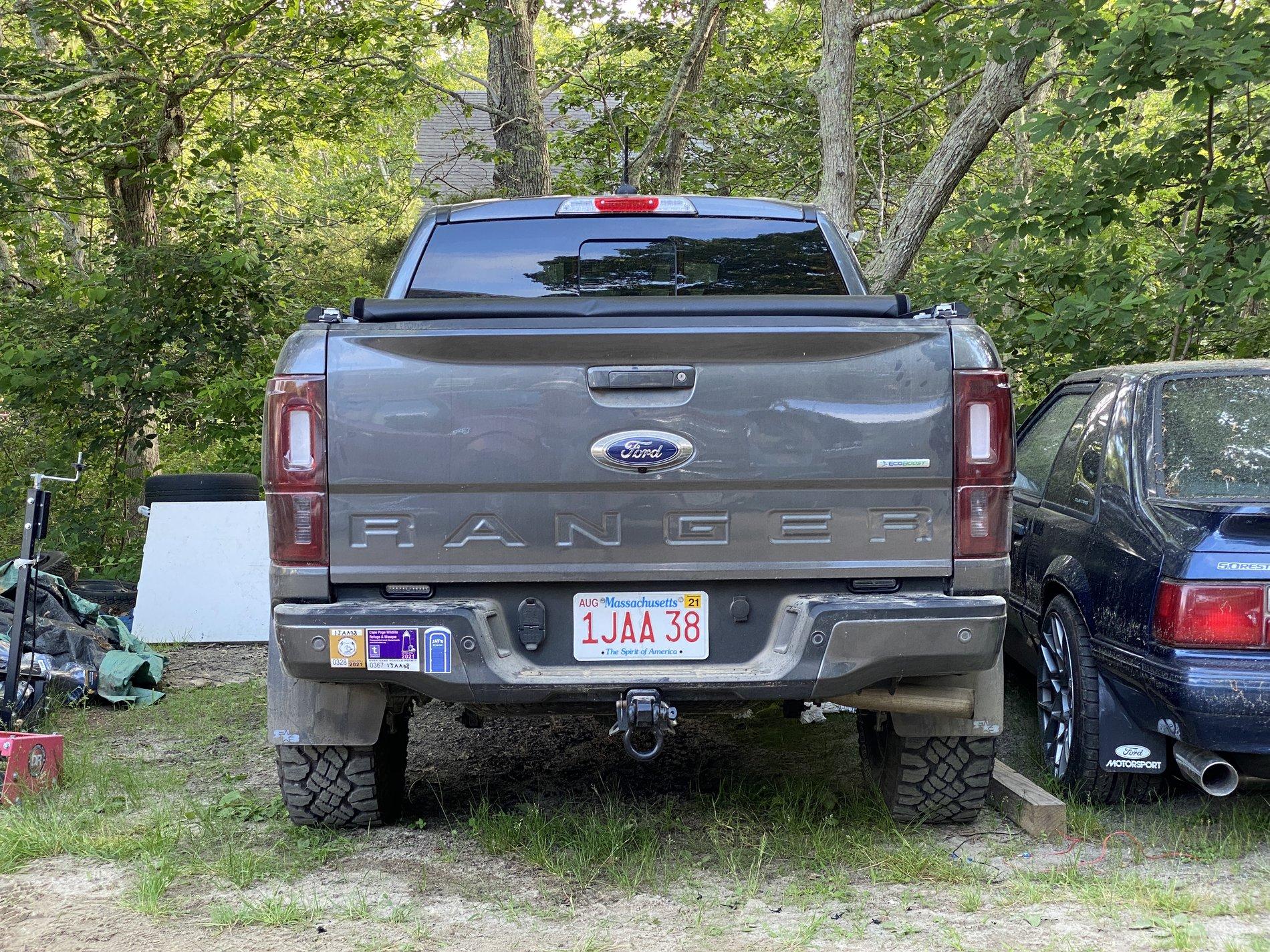

First off, a trip to Atlanta and Charlotte for my girlfriend's birthday weekend. I took her to her two favorite places, the Georgia Aquarium and ST Octane Academy! 2,467.9 miles. The trip fuel economy worked out pretty close to the hand-calculated 20.4 MPG.
Next up was a trip to Maine to help my parents finish a shack we built last fall on their property
The Truxedo tonneau cover was a huge factor in the success of this trip, as it was pouring rain the entire drive from southeast Massachusetts to eastern Maine. I took ALL of the equipment, since it all had to stay dry and my mom's F-150 doesn't have anything to cover the bed. Bonus, you couldn't tell at all that there was anything underneath it.
8,565 miles later, I still LOVE this truck.

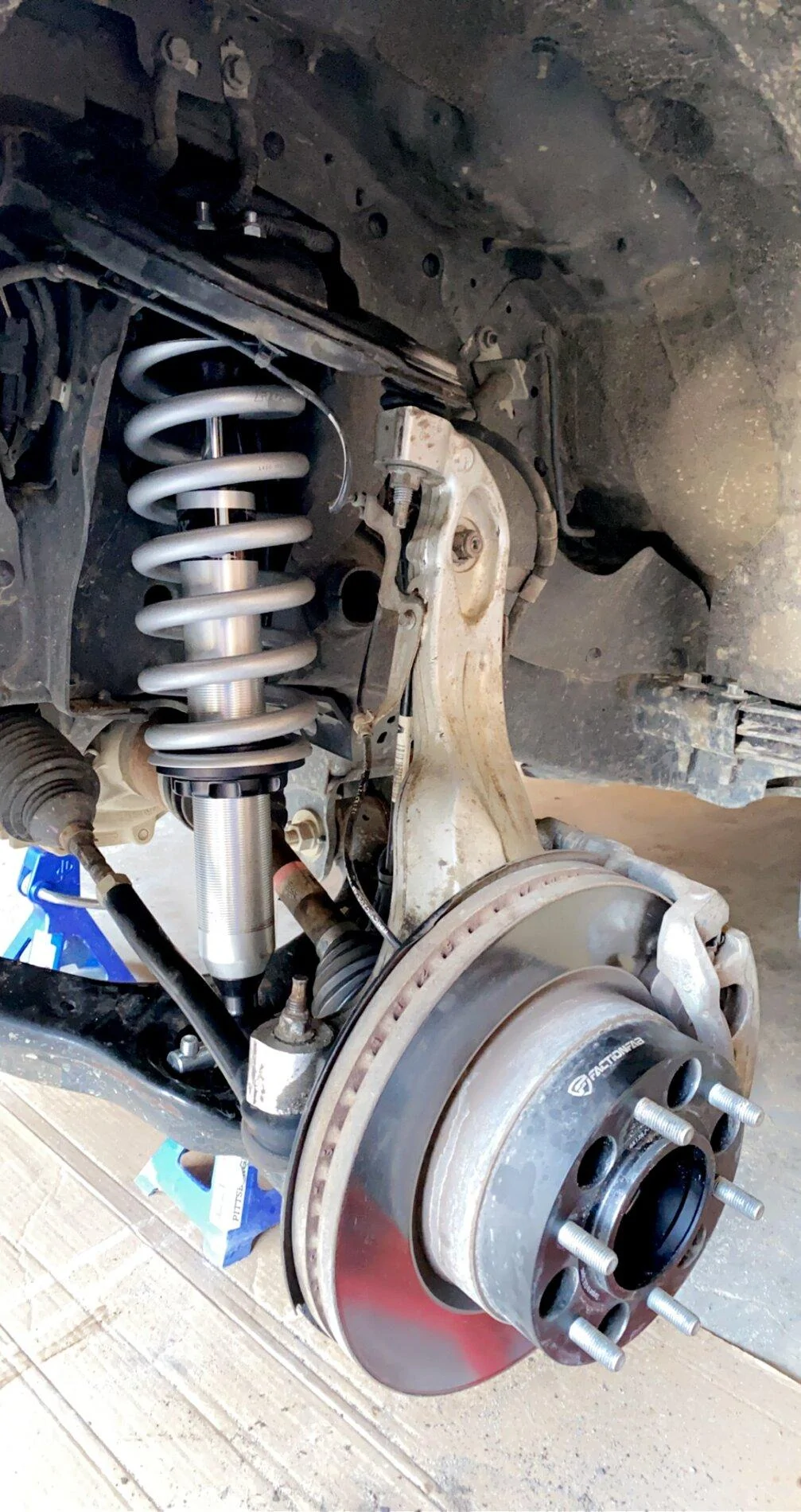

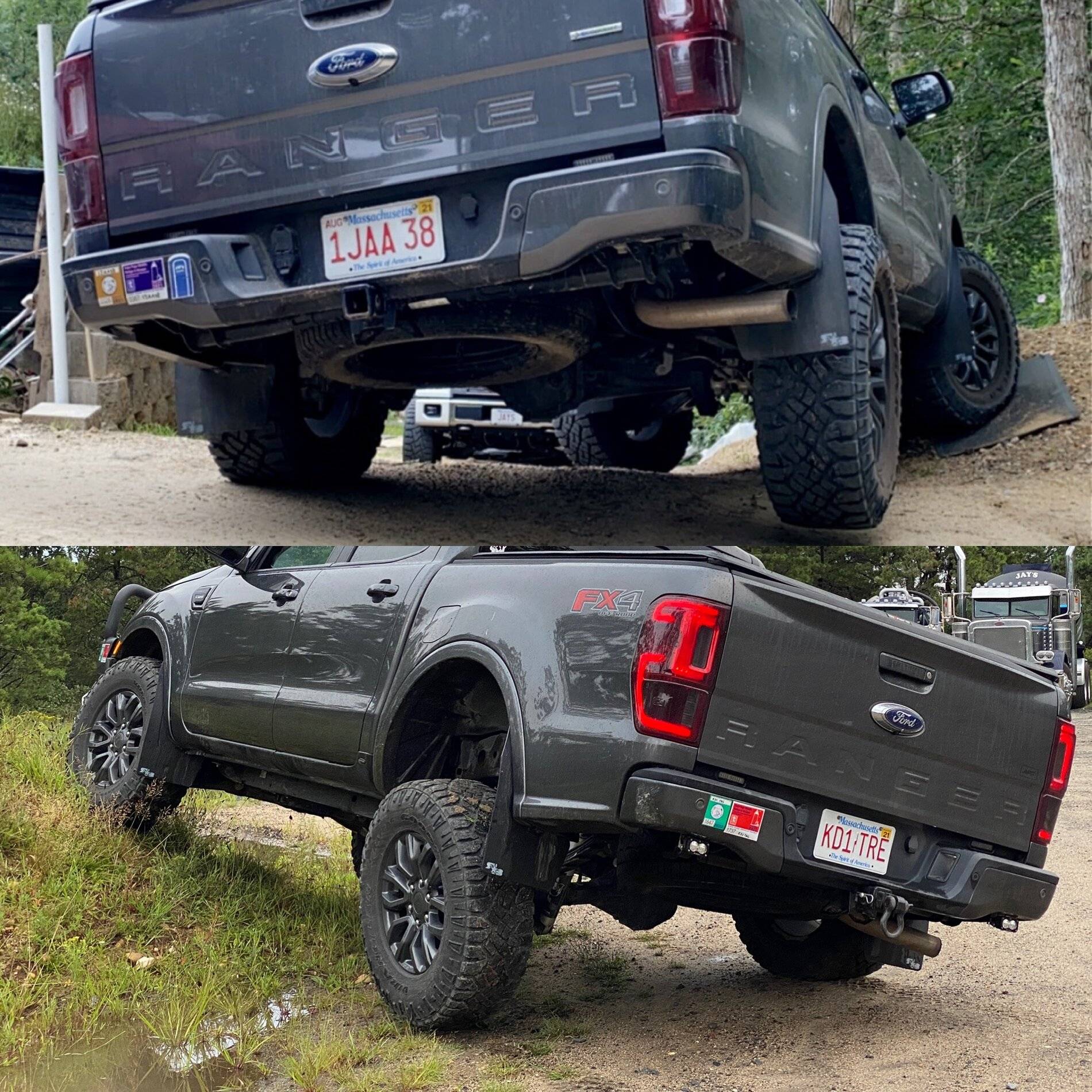

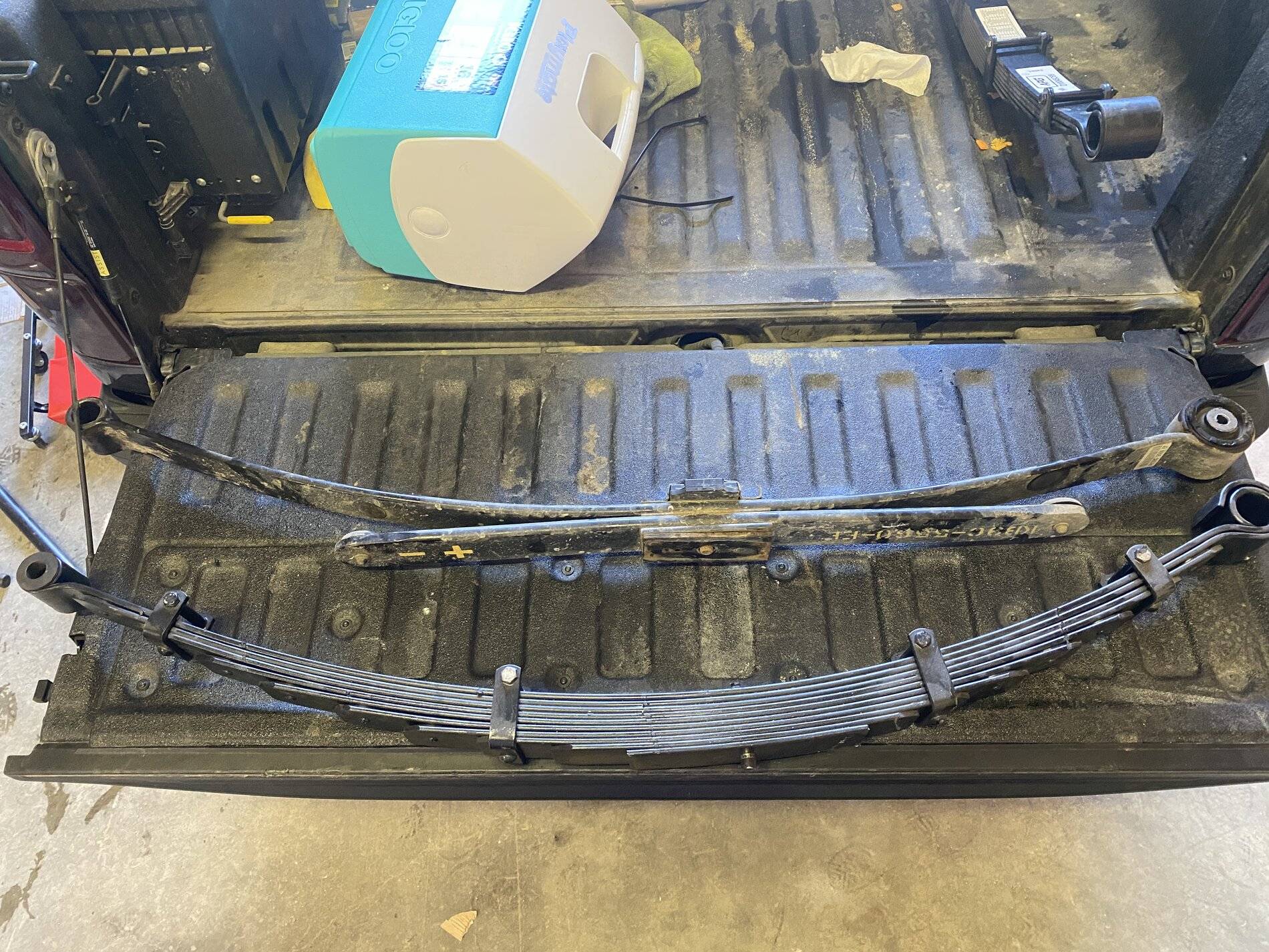

Wow, life got busy. Okay, update: 21,500 miles on the clock, largely unchanged, except for the addition of Fox 2.0 suspension at 18k; I just couldn't stand the FX4 suspension bouncing me around anymore.
I had the issue with the CV popping out when I did my spacer lift, and it happened almost immediately when I removed the stock suspension, but it went back together MUCH easier the second time around.
The ride quality is night and day, it's just as plush and comfortable as the stock suspension, but it doesn't bounce and shudder over bumps like it used to; even on large dips it's just a quick down-up and it's settled.

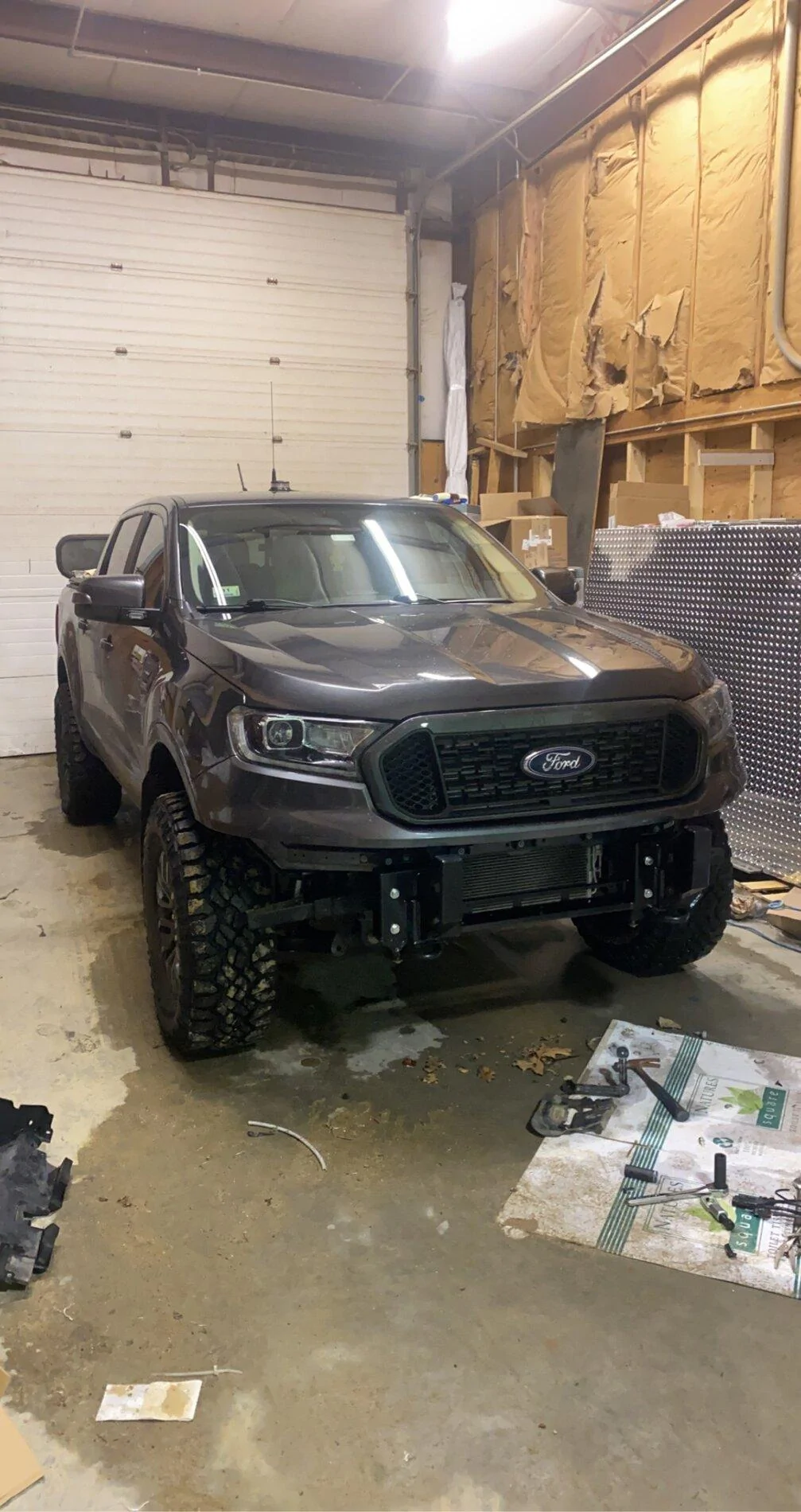

Okay, so in a two-week span, three of my friends hit deer with their vehicles around town, I took it as a sign, broke down and bought the ARB Summit bumper I've had my eye on since they came out.
Installation wasn't too bad, some grinding, some drilling, and a lot of bolts in weird places. The directions were vague and difficult to follow, ALL of the hardware came in one giant bag with no labels, and some things that would be helpful to know are skipped entirely in the instructions.

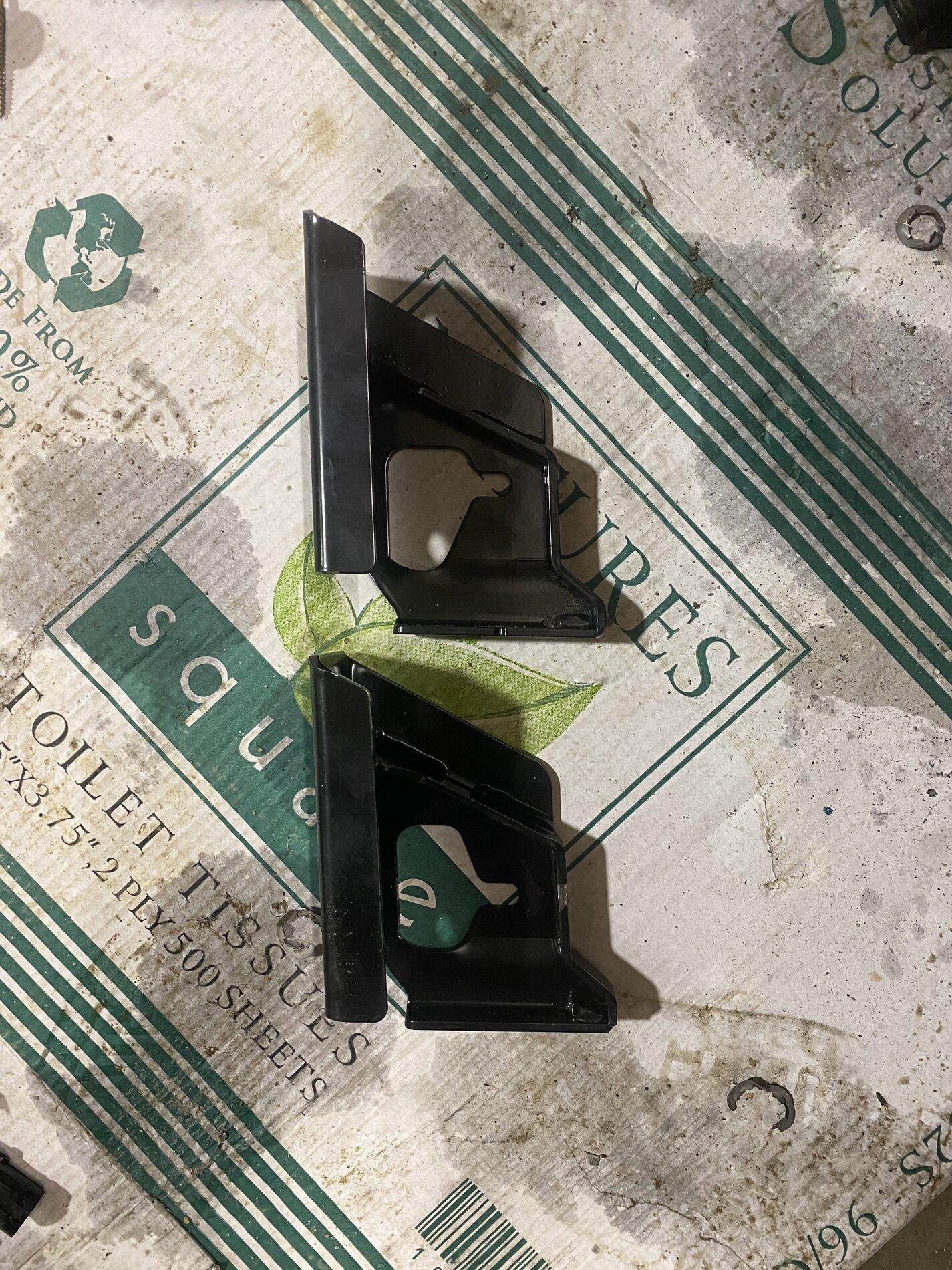

For example, these pieces are in pairs and are side-specific due to the way the bolt holes through the frame are. It took me a whole bunch of figuring out why they wouldn't line up before I realized that they're different.
Here's the "truck side" of the bumper install completed; frame reinforcements and bumper mount bolted up. I removed the front crash bars after this photo was taken

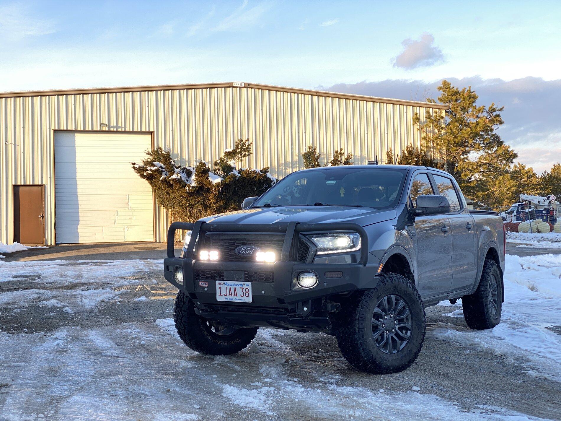

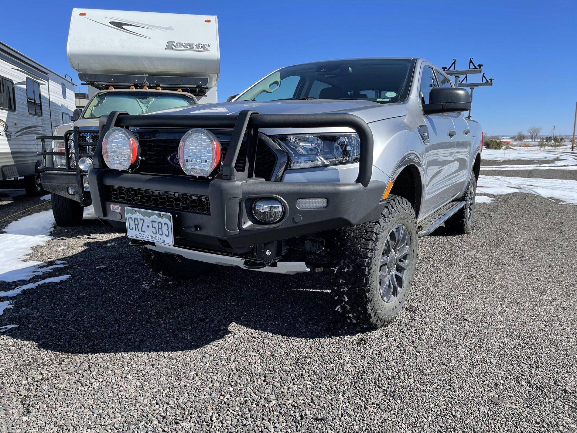

Here's the final product:
Everything works as it should, adaptive cruise, parking sensors, forward collision warning, etc. have no noticeable difference in function. The fog lights kinda suck; they're not as bright as the OEM LED ones and would be disappointing to anyone running something like the Diode Dynamics SS3 fog lights, but they look nice.
It definitely took some getting used to visually, but after a couple weeks, it's really grown on me. I'll miss the OEM+ look I had, but the protection is too valuable.

How does the Approach angle and front clearance compare to stock? Does this bumper give any advantage over stock when offroading. I like this bumper for the protection. I am hoping that it provides a greater approach angle. What suspension are you running up front? I assume that this bumper is significantly heavier than the stock and will push the front end down some. Nice write up on install btw.

I installed my bumper for the same reason you did, on my F550 back in 2008 and now on this 2020 XLT Ranger. Love the way it fits and sturdy with the the Warn Winch installed, too. Safe travels with your Ranger!
