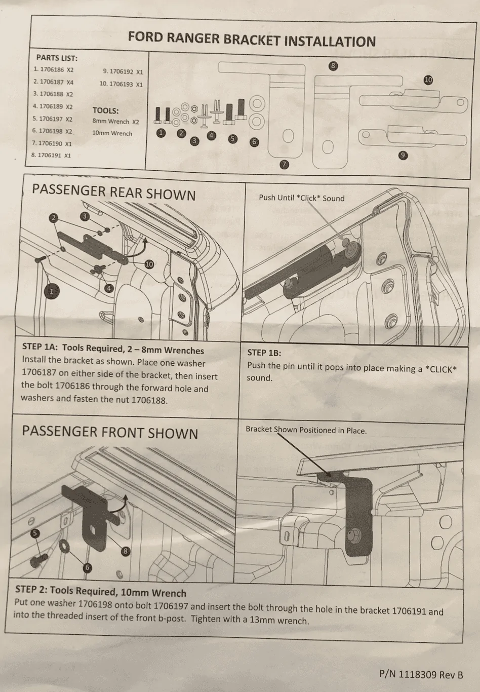

This looks like it may be the same as the Gator SRX cover. Did it come with installation brackets like the ones I'm enclosing a picture of? If so, how in the heck did the rear brackets get mounted, if at all? I believe I can mount the front brackets but the back brackets, I just don't see a spot for them.
I got the cover and the side rails on with no issues with these brackets that I guess were supposed to be support for the side rails or stumping me with their rear bracket installation.

I have a 22 Scab with the ford bed liner. Just received my Truxedo Lo Pro and need some help with the install.
Tried to fit the side rails and they are slightly too long to fit between the tail gate and the bed bulkhead liner. Looks like if I trim the corners of the liner it will fit properly against the paint.
Everything I’ve read so far never mentions this just say it will fit with a bed liner.
Are the brackets, as delirious posted above, necessary for the install. Seems like the truck side rails wrap around flanges are very thin gauge with little depth for the rail clamps to grip. seems like the brackets would give much more support.
has anyone installed the front and rear brackets on one of these covers on a scab with ford bed liner?
The manufacturers videos are useless.
Thanks in advance.

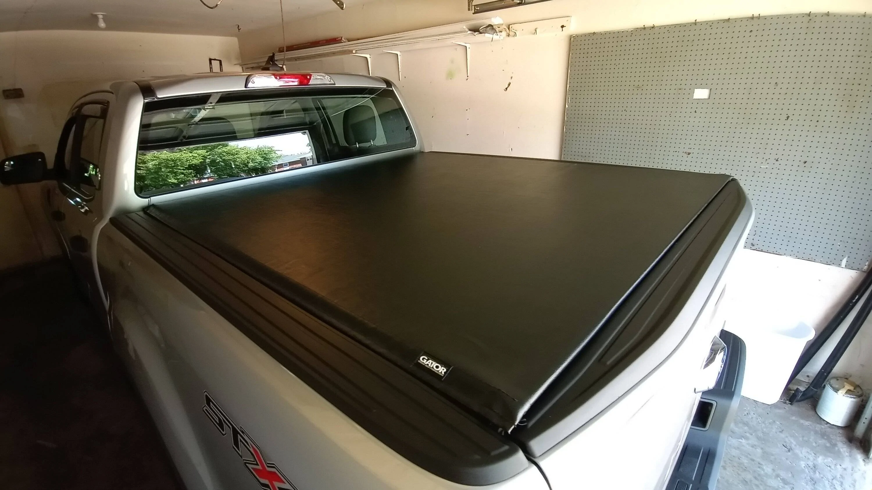

This is what I have, 0 issues besides installation is a little bit of a pain. But it’s 99.99% waterproof (with the exception of heavy rain mine slightly can leak in the front of the bed) but had it over a year now and it looks good as new.
Gator ETX Soft Tri-Fold Truck Bed Tonneau Cover | 59317 | Fits 2019 - 2021 Ford Ranger 5' 1" Bed (61") https://www.amazon.com/dp/B07NDLVP8K/ref=cm_sw_r_cp_api_glt_fabc_KAGFNC5H20TX17S7JXYP

I have spray in liner and it works fine. Do you have drop in?

Yes drop in. Too much thickness of the liner about 3/8” for the rails to fit.
I’ll need to cut a knotch out of the liner for the rails to fit.
maybe I’ll take some pictures to help others out in the future.
