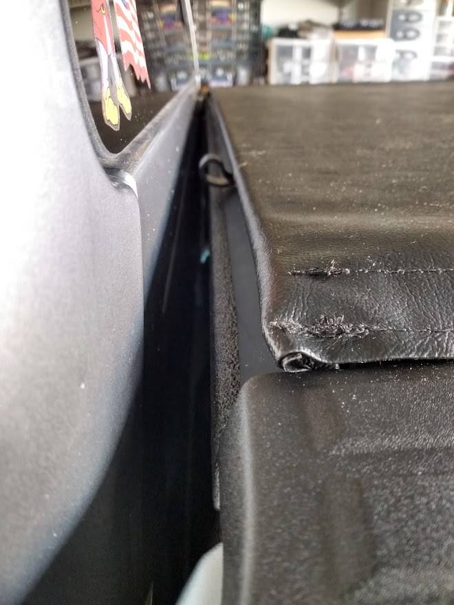

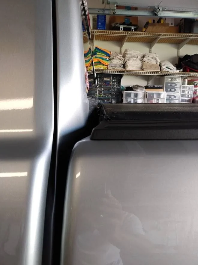

I'll try to take/post some photo's, but...
If you look at the front bar of the tonneau there is a rubber flap/seal that is permenantly attached to the rail. Also Included with mine/yours ? was a hard foam seal, with one sticky side, about 1 1/4 inch x 1 inch that the instructions indicated should be placed on the top rail of the bed behind the cab.
I installed the seal but positively could not get the front tonneau rail to seal while following instructions to secure the front rail. That seal would not compress enough.
I took the seal off and the front tonneau rail snapped into place, and the rubber flap seal now just covers the top rail.
If you installed that thick foam gasket/seal then there is a gap between the tonneau rail and the bed edge and I believe thats your problem.
I think the cover may be designed with the application for other trucks/makes/models, and thats why extra parts/seals, ect, were included.
Pic's...
First on shows the rubber flap seal lying flush along the top rail. Second shows how my cover lies perfectly flush along the entire front area.
If you look at the instructions, it appears that they want you to place that foam gasket along the top of the rail, but if you carefully read the instructions, it indicates that the seal should be placed on the inside of the bulkhead just BELOW the top edge of the bulkhead. That is where I placed mine.
Instructions are a bit vague and confusing.
Only other suggestion I could make is to get into bed with the cover closed and have someone direct a flashlight at the front corners. If you see light, plug the area with some butyl tape. It's very sticky and can be balled up and used to plug any gaps. Waterproof and very long lasting.

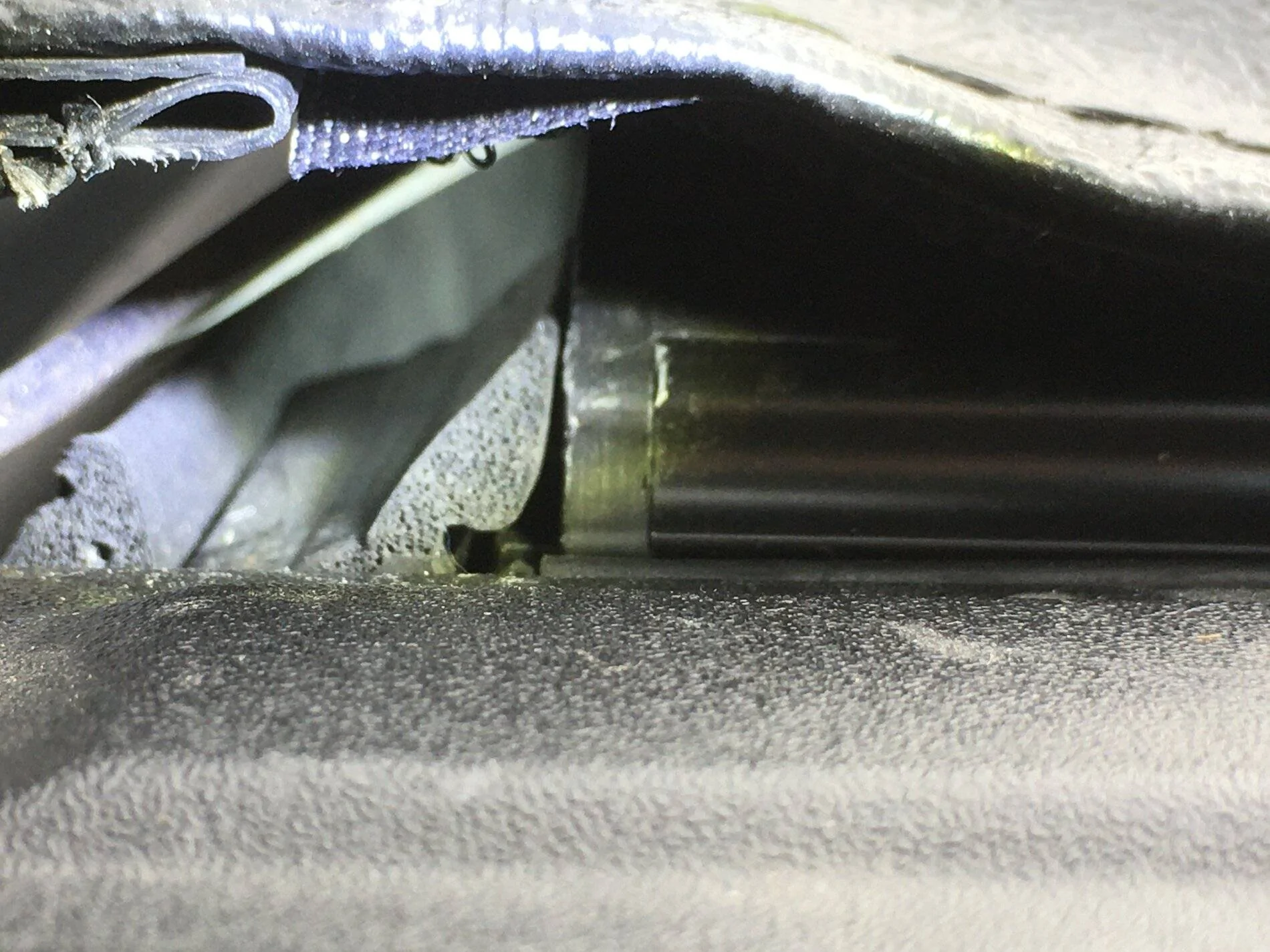

Interesting. The instructions that came with mine definitely state that the thick foam seal goes on top of the bulkhead rail. I've been in touch with Truxedo about the issue and they've been very responsive, but with no useful fix yet. Your installation looks like it works great...certainly much better than mine! On mine the fabric at the corners pulls up leaving a significant gap for water intrusion.
Drivers front with tensioners set to instruction's spec.
I think I'll try without the foam seal, though I think it will become sacrificial at that point (it's really on there) and according to the website it is not available as a replacement item.
Really appreciate your input on this.
Thanks,
Kip

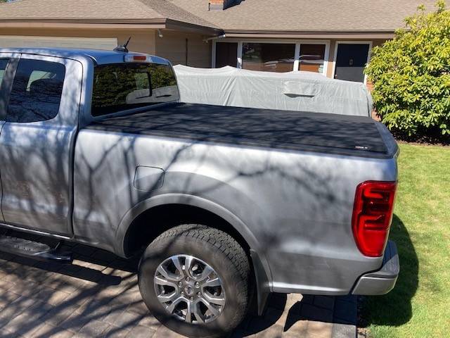

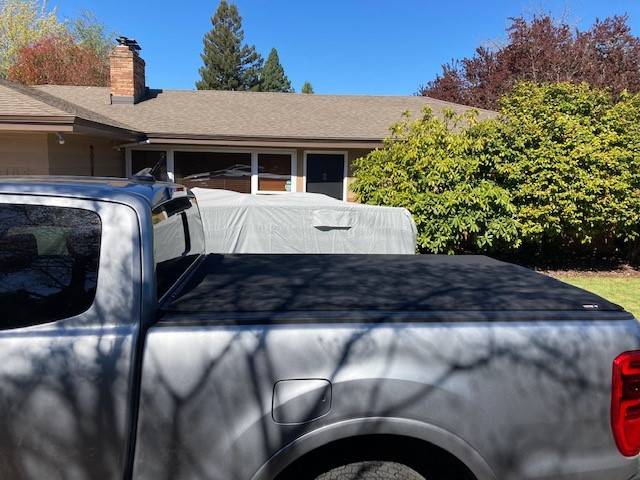

I have the TruXedo Pro X15 Lo Pro and basically no water at all. The front is pretty well sealed and I like how much it goes over the bed edges on the side. I do need to use some tail gate seals which I have bought but not installed yet.
