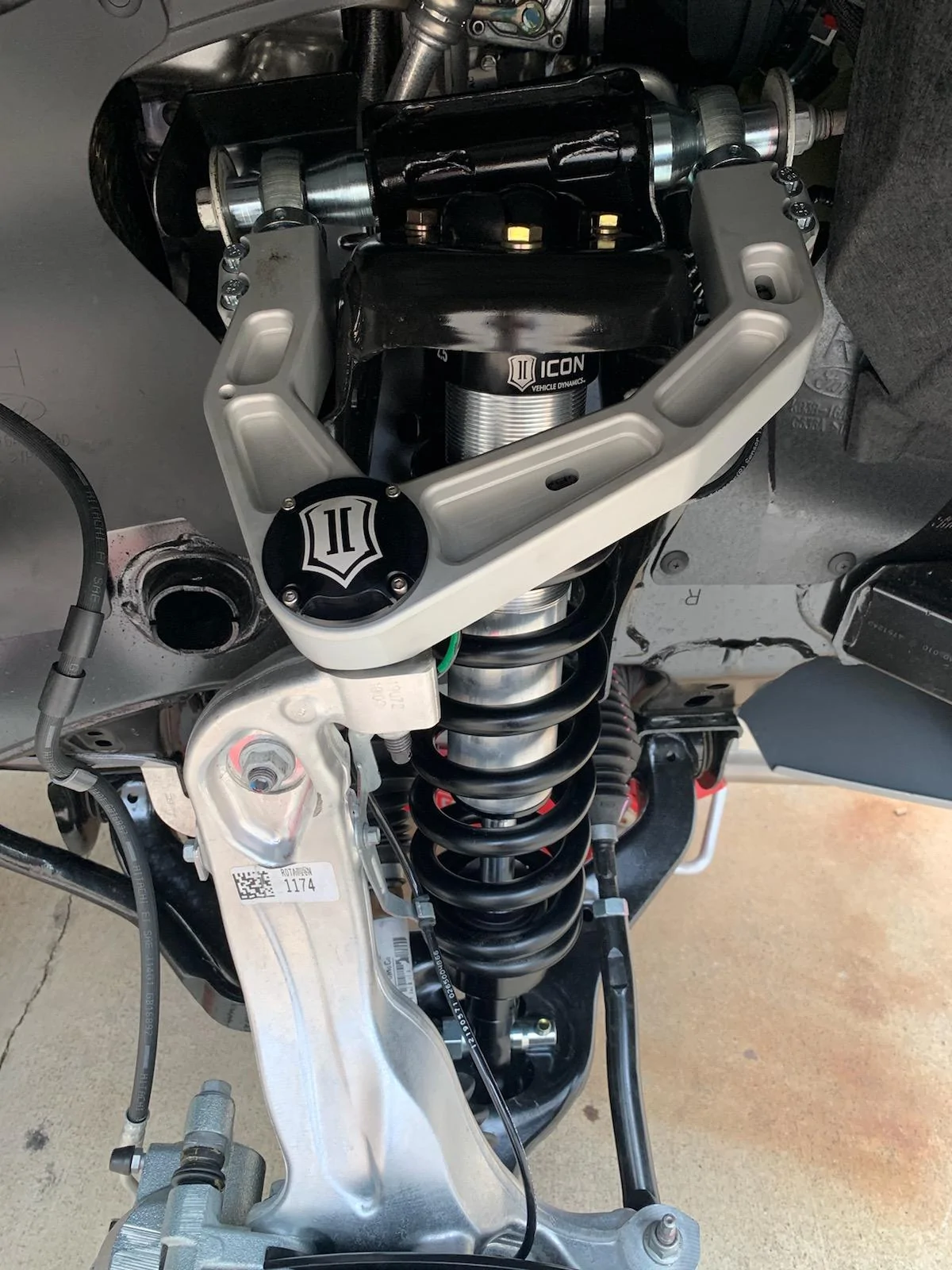

    They are being shipped. Just installed my pre-retail kit last night.

    The offroad shop that's handling my ICON install called them and they're shipping the coilovers now, but the tubular UCAs won't ship til mid-to-late June. You can install w/ the stock UCA, just can't adjust the coilovers til you install their UCA for the extra travel. Kinda sucks waiting, but i'm debating if it's worth getting the truck alligned twice to get it lifted for the extra 4 weeks.

    That's a sexy UCA, I have to say.
    Most places here won't bother with a UCA until we lift past 2"

    Its nice to be able to dial in the caster/camber. The lower arm runs out of adjustment pretty quick. You cant beat the Icon Delta joints.
