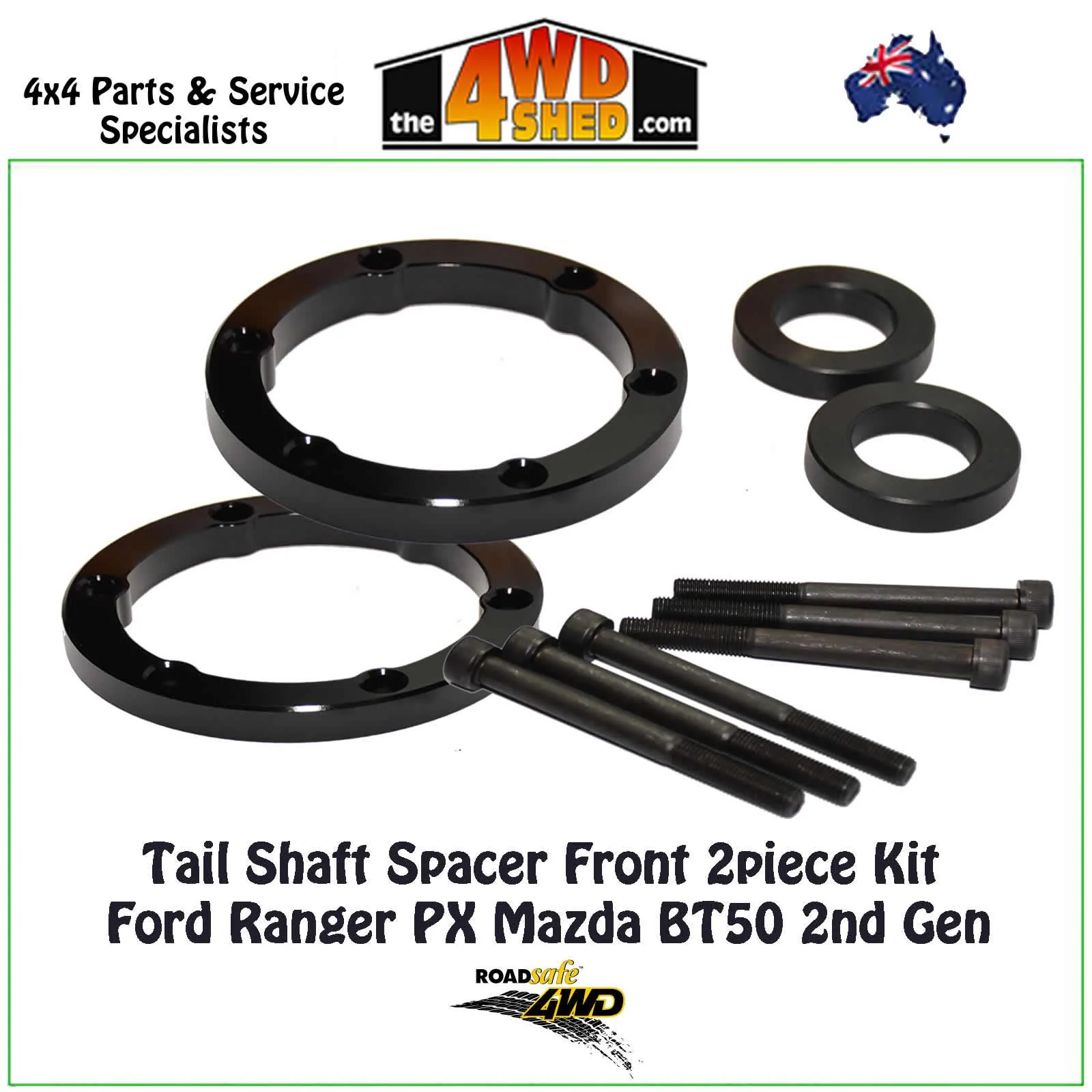

I haven't been following this thread but I noticed something odd about the drive shaft.
I kinda liked it...
The front shaft is straight back and the carrier bearing is fixed on top of the crossmember.
All the travel and drop then is in the rear shaft.
You can't shim the carrier due to its location so it appears that any lift kit would adversely affect the drop angle and the rear shaft looks pretty short!
Is there some compensation for this in the lift kits?
Is the design limiting or does it just not matter?
Yes, I have one installed. I had 300kg constant load springs put in the rear. It raised the rear by 40mm. To reduce shudder between 10-20kmh takeoff speed, we put one in.

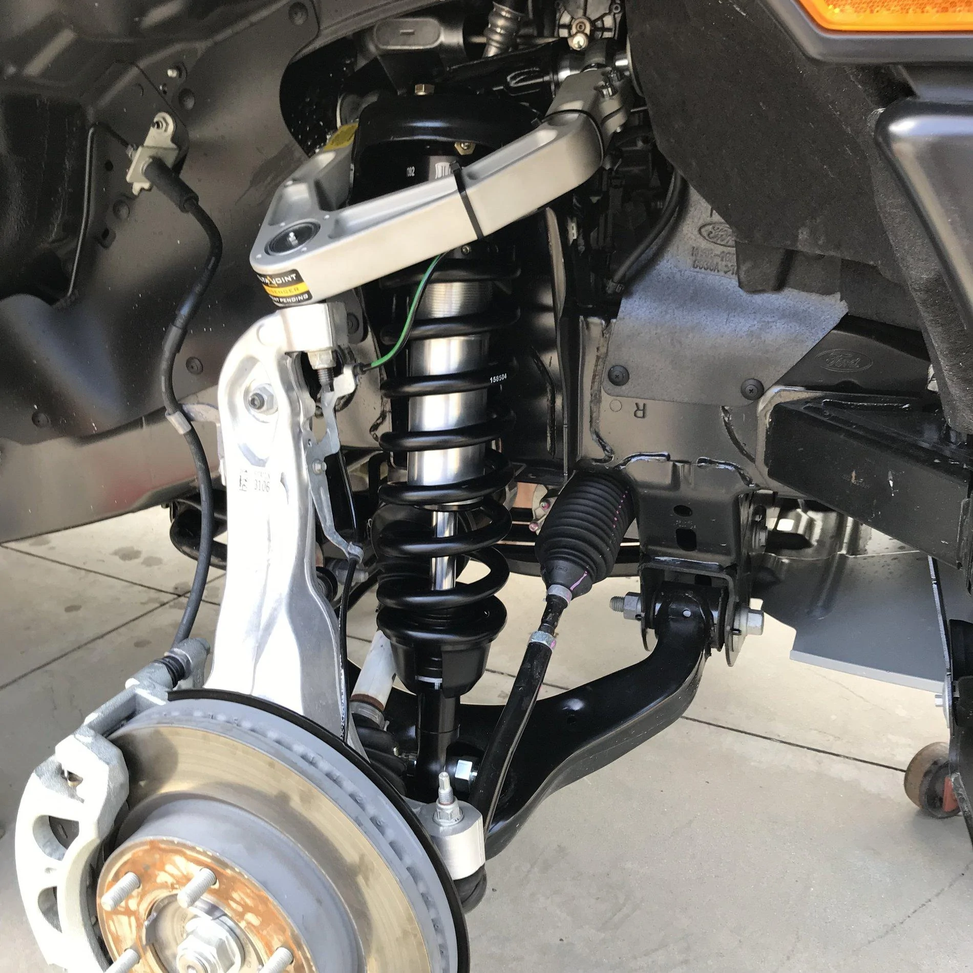

Got about a week on the ICON stage to with Billet UCA's towed a small trailer to Flagstaff for overland expo and so far it drives like a dream! gonna put some hard dirt miles on this weekend!
I just got mine done today, but I have a strange clunking sound coming from the rear. Do you have anything similar? I re-torqued the bolts but they’re tight. Strange how much the mounts had to flex inward to meet the shocks, almost like there should have been spacers or bearings in there.
Disregard, one of the lower bolts on the rear shock had loosened. All good now!
You also have to grind the mounts to stop the shock body from contacting the shock mount. If you don't, it will make noise when you are hammering it off-road.
