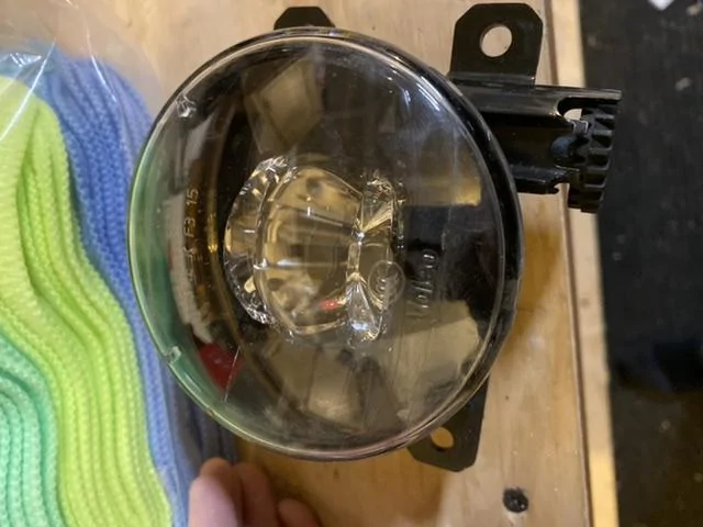

Yes, you’ll need to adjust the headlamps. I already have the BDS 2” leveling kit on my truck, and the headlamps were WAY off. But it’s a remarkably fast and simple fix. There is an adjustment screw above each headlamp, you don’t have to remove anything to access them, just pop the hood. I believe it is a torx bit screw. Easiest way to adjust them is to go out at night on a long/flat (and vacant) road where you can adjust the headlamps down until the tops of the light beam are touching the road then go just a tad lower; any higher puts the beams in the eyes of opposing traffic and this will allow for a little suspension bounce without flashing the beams at others. I won’t be can’t remember if OEM fog lights are adjustable for sure, I think so. I replaced my fog lamps with the Baja Designs Squadron Sports with wide amber lenses, a pain to install but they’re pretty great.
the OEM fog lamps are adjustable. Here’s a pic:
