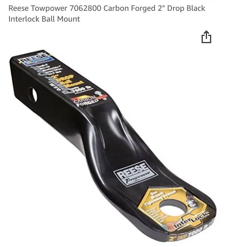

RETIRED ENGINEER
What I use for my travel trailer:
