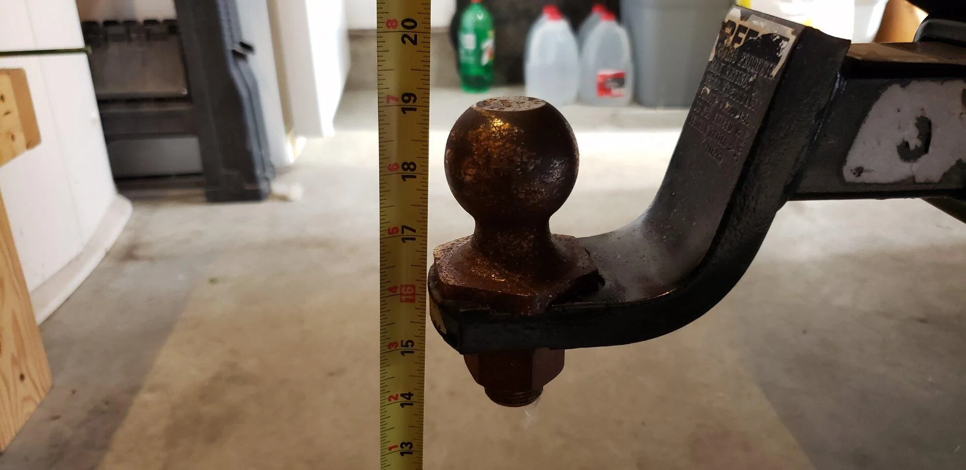

Update for anyone interested that follows up.
This is the 3 1/4 inch drop hitch.

I have an xlt 4x4 17 in. wheels. (All stock) I put on a curt aftermarket hitch with a 2 in. drop for the ball. The top of the ball is exactly 20 in. for me.
