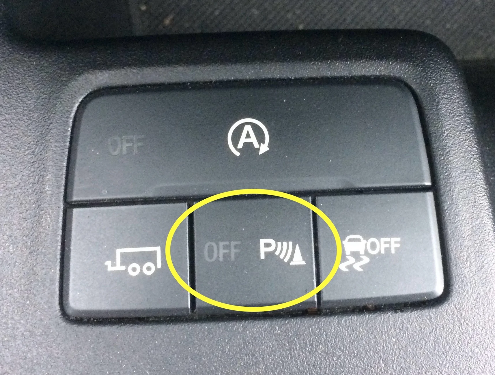

It I'd on the console and had what looks like a parking cone and a P on it. The word OFF lights up when you press it. Resets with each key cycle.

On the console in front of the cubby. Some Rangers have more buttons than mine does but it’s in that cluster.

Thank you! I have used that to shut off the backup sensor, while in reverse but never realized it also killed the 360° sensors.

Maybe I misunderstood what folks were referring to. This only shuts off the parking sensors rear and front (if equipped).
Or I misunderstood.
I was thinking the sensors (8 I believe) front and rear bumpers. They have gone screwy on me, on occasion.

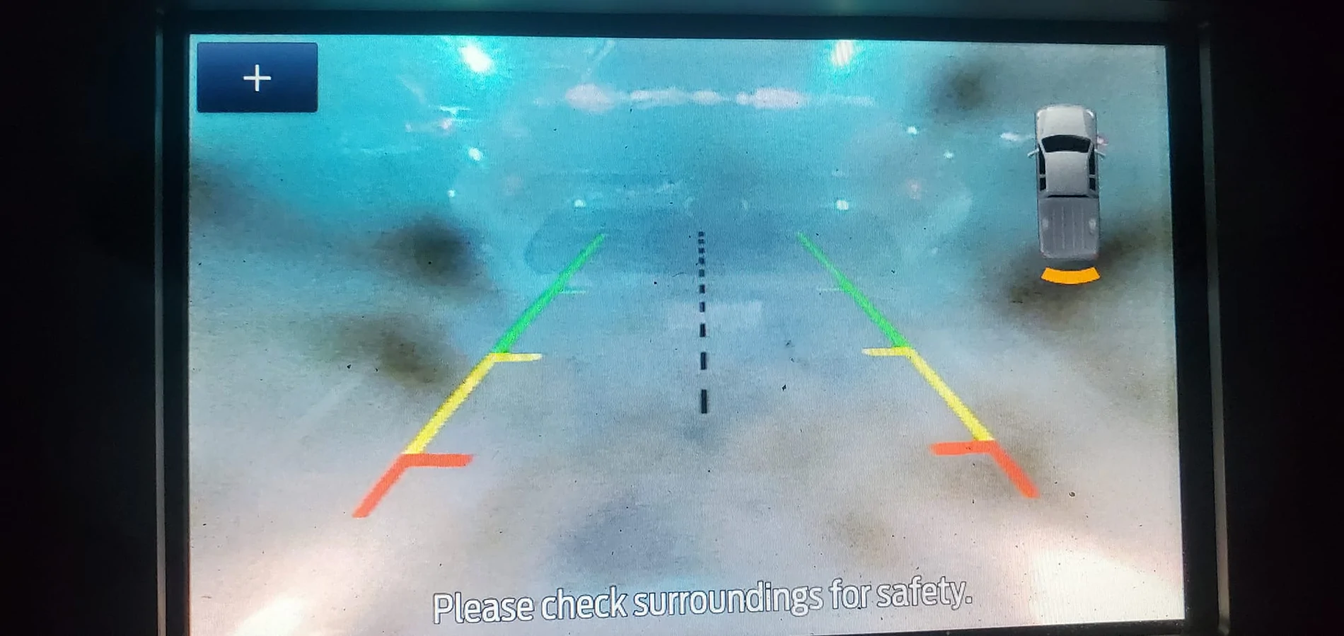

I can't see but it kind of works LOL
they put the camera in the darn wrong spot right where the airfoil sucks up dirt and snow, I run my thumb over it when I get in sometimes but by the time you get somewhere its dirty again!
