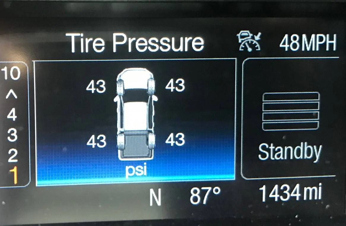

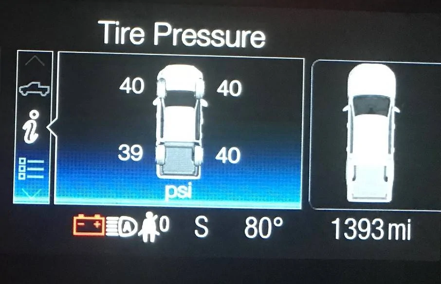

Today I left for a community about a half hour away or 22 miles away from my home. Drove about 55 mph and when I left the garage with my Ranger Tremor 1 tire showed 39PSI and the other 3 showed 40PSI. It was about 80 degrees when I pulled out of the garage and when I returned it was about 87 degrees. On the way back after the tires heated up and I showed 43PSI in all tires. So, about an increase of 3 PSI increase average. About .075% increase if my math is right. Anyway, for my driving, it looks like my setting the cold tire pressure about 40PSI, will work fine. Maybe at 70 MPH, it might increase even more, however even in 70 MPH zones, I still stay in the right slow lane and run around 60 to 65 MPH. Trying to save gas and $$$! Seems like there are others too now a days starting to slow down to save gas. Pics below:

... On the way back after the tires heated up and I showed 43PSI in all tires. So, about an increase of 3 PSI increase average. About .075% increase if my math is right. ...
This is great info, I'm surprised at the difference. Did think it was worth pointing out that your math is indeed incorrect. That would be a median of ~7.5% or an average of ~8.2%.
Yup, I stand corrected. My math was wrong as I see now. Sorry :blush:
